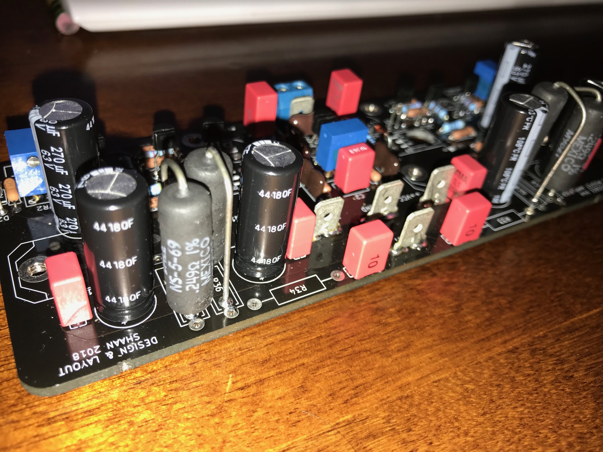

things are moving slow...I could not find any quality radial resistors for R35-R38 , so I used some dale NS -5 0.249ohms (I hope they are ok) Axial 5w resistors which I already had.
Now , a humbled suggestion , Shaan , if u have the chance, please add a pad connected to each source of the mosfets so for people in similar situations as me could use their axial resistors horizontally mounted on the board.

Hi Gabe.
Thanks for the suggestion. I will try to implement it in the design.
Board looking superb! Pana FR are great capacitors.

Hi Shaan,
can I suggest for new PCB's, more space around C3 and C4?
Larger sized 0.1uF caps are easier to find.
For 5watt resistors I am going to try these metal film from Digikey. Cheaper than Caddock.
https://www.digikey.com.au/products/en?keywords=MPR5JBR100
