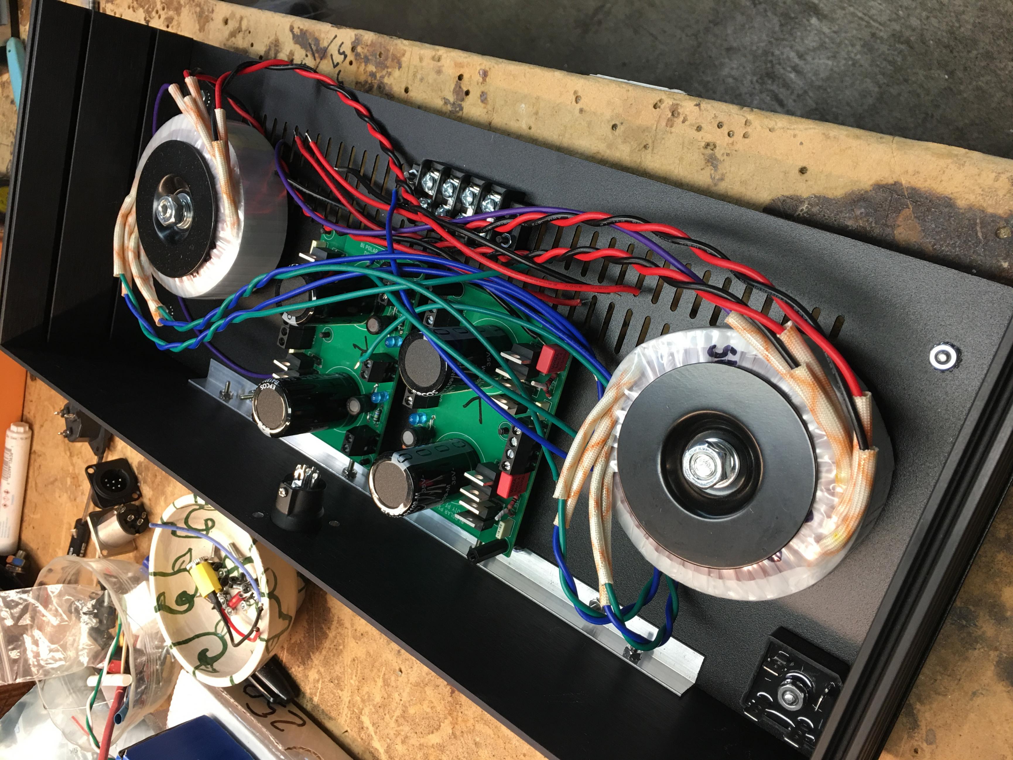

Making progress….supply close to completion.

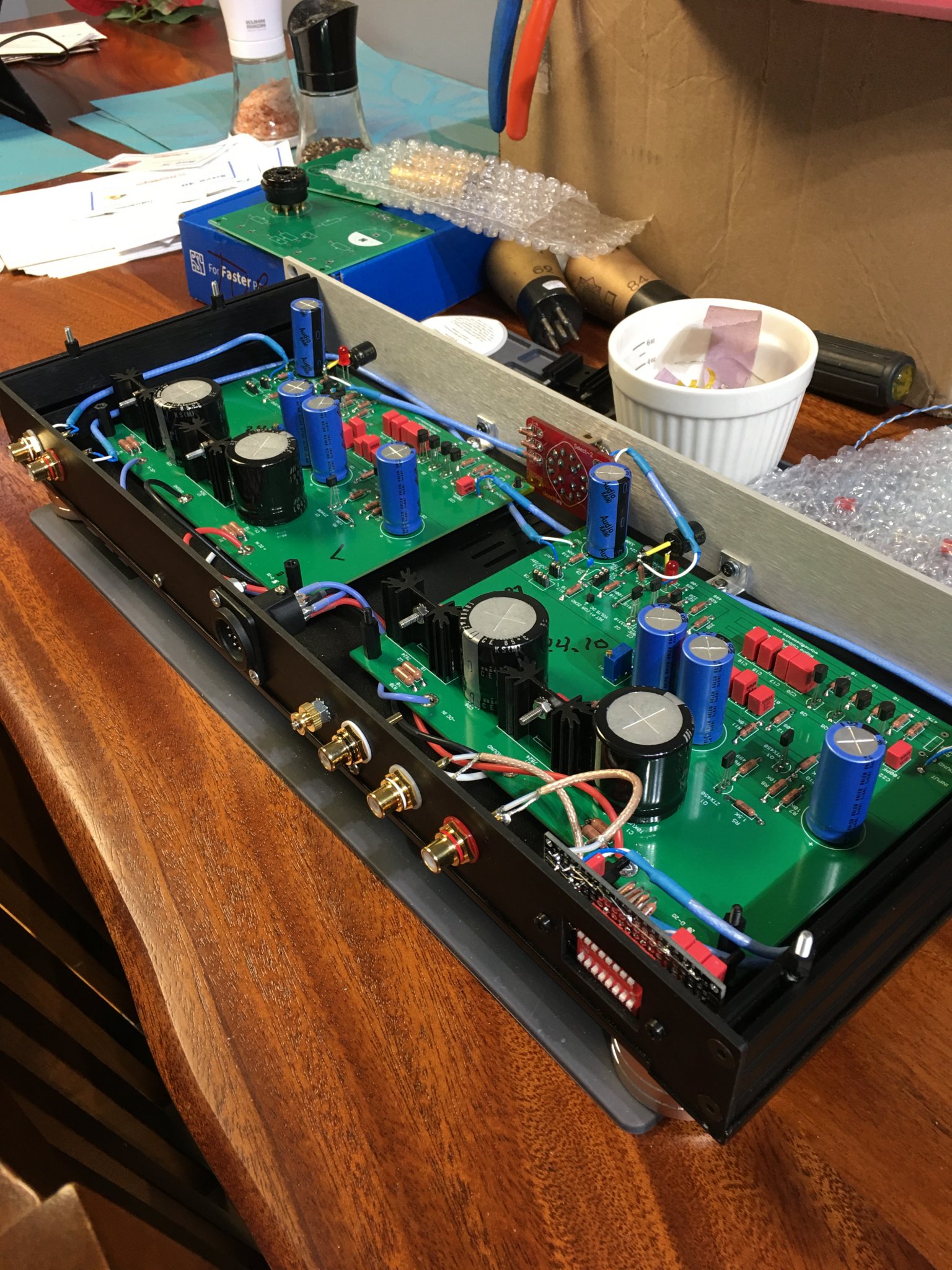

Finally got around to finishing up my Pearl 2. Everything seems to be ok (after a silly mistake), but I seem to run out of range on P1 when trying to adjust for 0v offset. I do have the cap in series with R14, but short it out for the measurement. Both channels wind up with around -70-80mv offset. Very stable at that point, but it won't go any lower. This is obtained when the pot is turned completely clockwise. Should I just fire it up and forget about it, or should I change the value of R6 and if so...to what? My boards are stacked, so I'd rather not put the top one on only to have to remove it! I'd like to be pretty sure that I'm good to go.
Joined 2004
Works like a charm. :rolleyes: Guess I need to get back in the habit of measuring everything before installing!

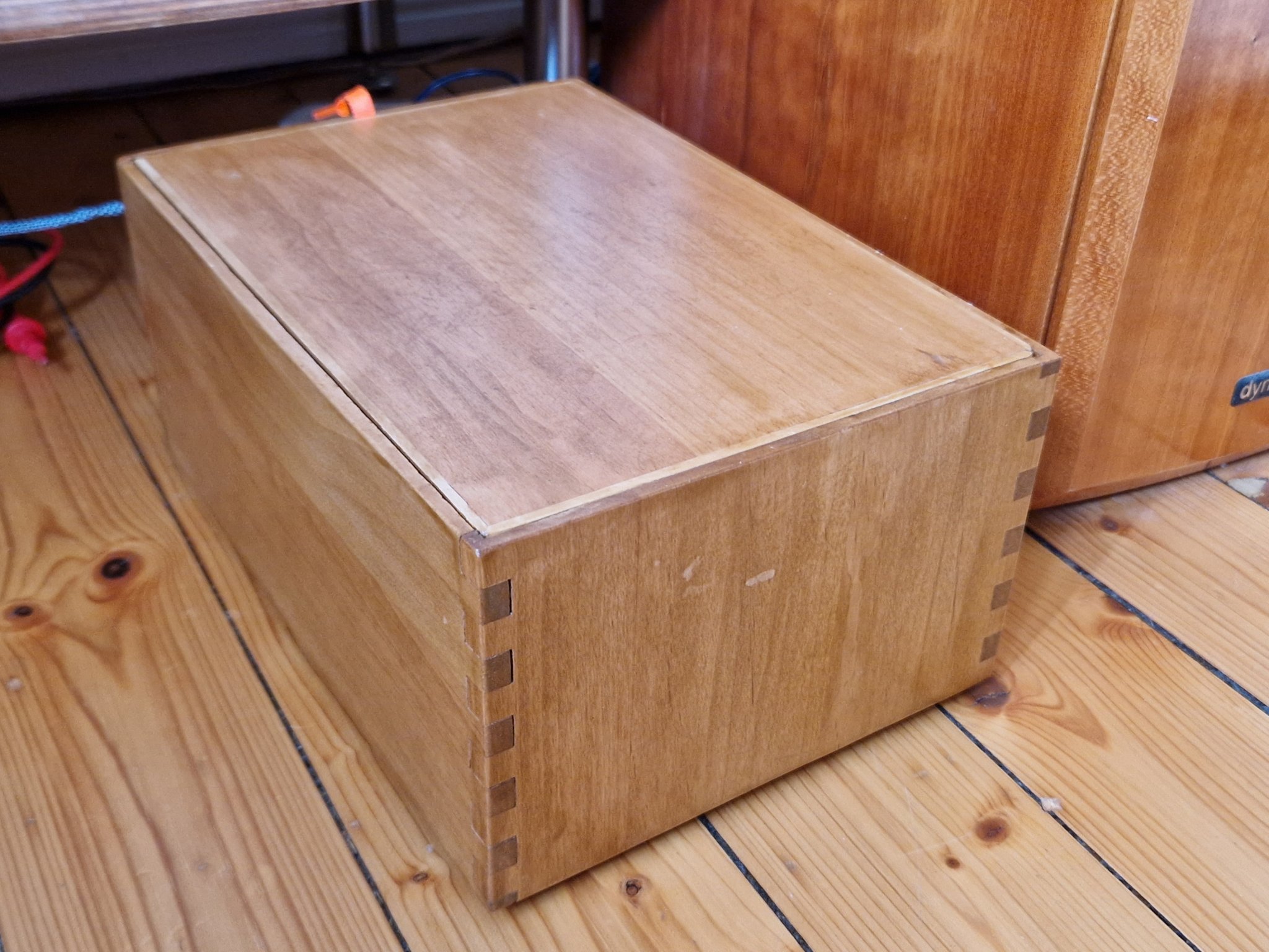

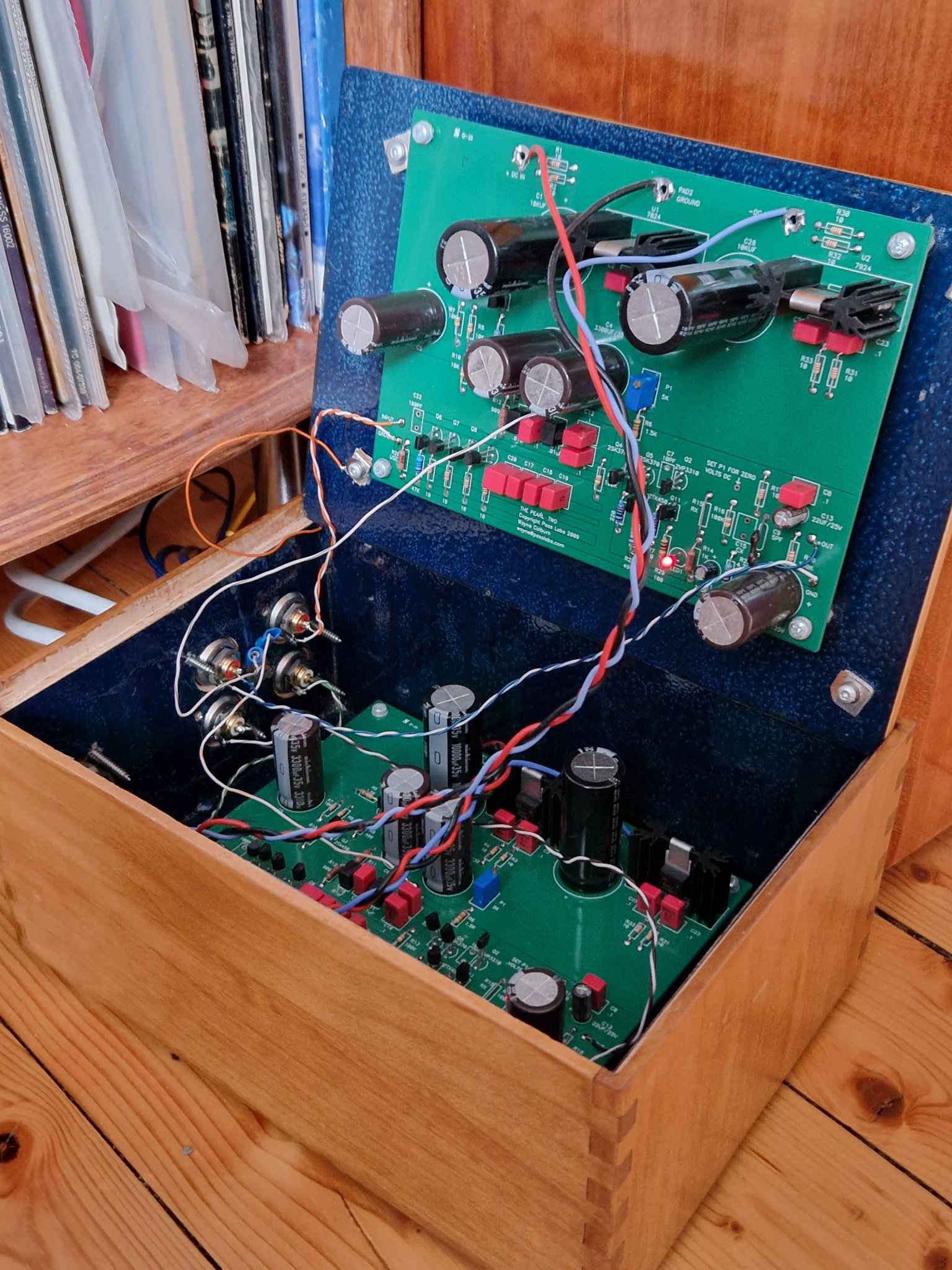

My Pearl 2 is completed. Performs above my expectations. No hum whatsoever even with pre-amp gain at full volume, only a bit of white / pink noise a little bubly. With good recordings it produces a great soundstage with good depth information. And rhythmic information gets throug so well over the frequency span. Very happy I am. :) Built a wooden box for it, and built a steel box inside the wooden box for proper screening, both magnetic and electric. That worked real well. The wood also dampens all tendencies for steel boxes to resonate. Favorite listening setup is playing from a Woodpecker with an Allnic rose pu into my Whammy and through my ZMF's. Bliss. Does also sound very good through my speakers..
