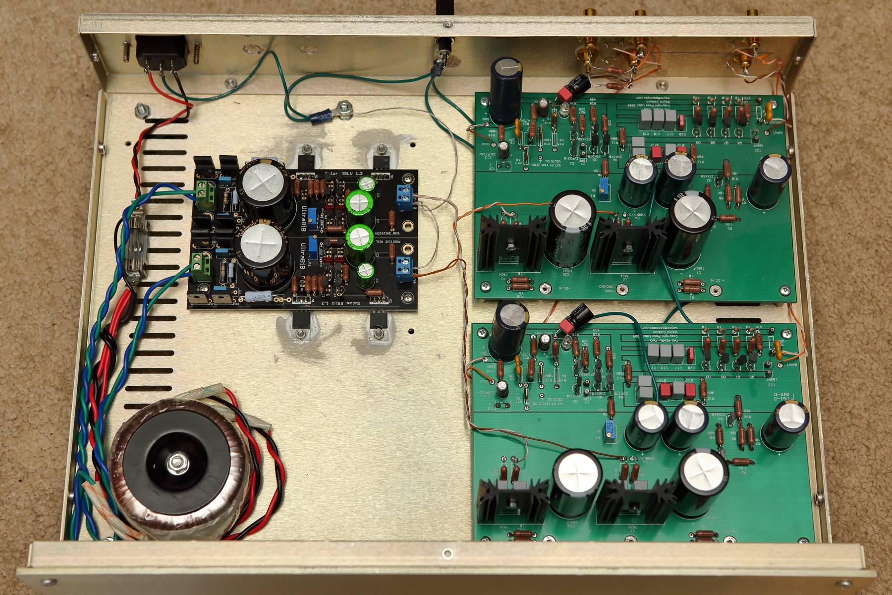

I've been planning to do this for a while and have finally found the time to rebuild my Pearl 2 with an internal power supply. I used an Antek AN-0225 25v 25VA transformer followed by a Salas BiB v1.3 regulator. I used 3R bias resistors for a 200mA supply for each rail. The mosfets make the floor of the chassis a few degrees above body temp and the transformer warms up a little too, but not as much as the chassis floor.
I was a bit nervous about having a transformer inside the chassis, but it turned out well. I rearranged the PCBs to keep the input signals as far away from the AC wiring as possible. This worked well with no increase in noise at all. Now I can ditch a separate power supply box, so I get a space back in my audio rack.
My ongoing thanks to Wayne for such a great phono stage! Running my SL-1200 into the Pearl 2, then to a B1 Korg, into a MoFo amp and my FHXL speakers really makes a GREAT combination - lots of synergy with this setup! :)

Eric:
Please explain the setup for the resistors r21 thru r24 (I can't see it clearly at the photo). What is the the attached component ?
I added an additional 10R to the existing source resistors for a total of 20R. I was having a problem with my 5mV MM cardridge overloading and causing distortion. A few people here have commented that this was the wrong approach, so my next step is to return these to 10R and use the approach that Mark did with a switch on R14. One step at a time...
