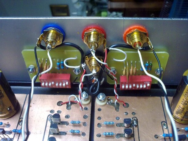

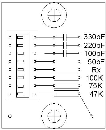

Actually I wouldn't (and, for that matter didn't...) make the loading on a separate board or switch arrangement. But, I don't tend to change cartridges all that often. If you do, it might be a good idea.
There are provisions on the PCB to add loading capacitors and resistors. Just determine the suggested load for the cartridge, it's in the cart's manual, and adjust those components as necessary.
If you want to make it a switched arrangement, the DIP schematic shown above is quite nice. :)

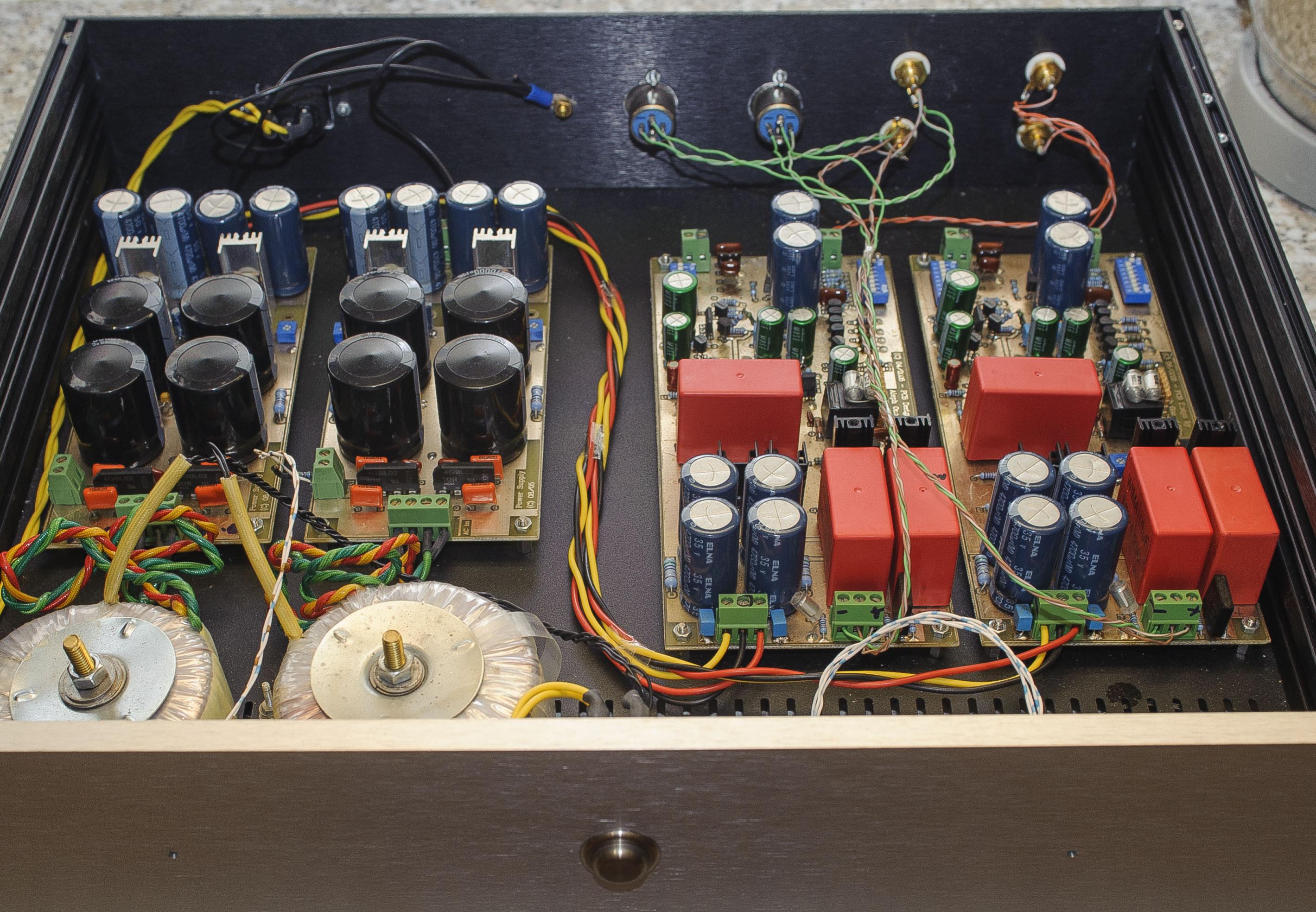

Having looked more carefully at your pics I realised that something was wrong...old age has caught up with me so I got the unit out to take a pic. It is NOT - as previously said - a Pearl; it is an Xono with boards dated 2005!
Apologies for wasting your time 6L6. Here is a pic anyway! If anyone has any experience of this amp I would be p[leased to read their impressions - especially with low output MCs

Everything I said remains the same, with the exception that the Xono will have enough gain without a transformer.
BUT, the SPU will always perform better with transformer loading.
Anyway, I'd strongly suggest getting another chassis and removing the transformers/PSU from the chassis, you''ll never get it genuinely quiet with mains transformers in the same box. The Xono is a jaw-dropping, amazing, wonderful design, fix whatever issues the builder had and I'm sure it will work well.
