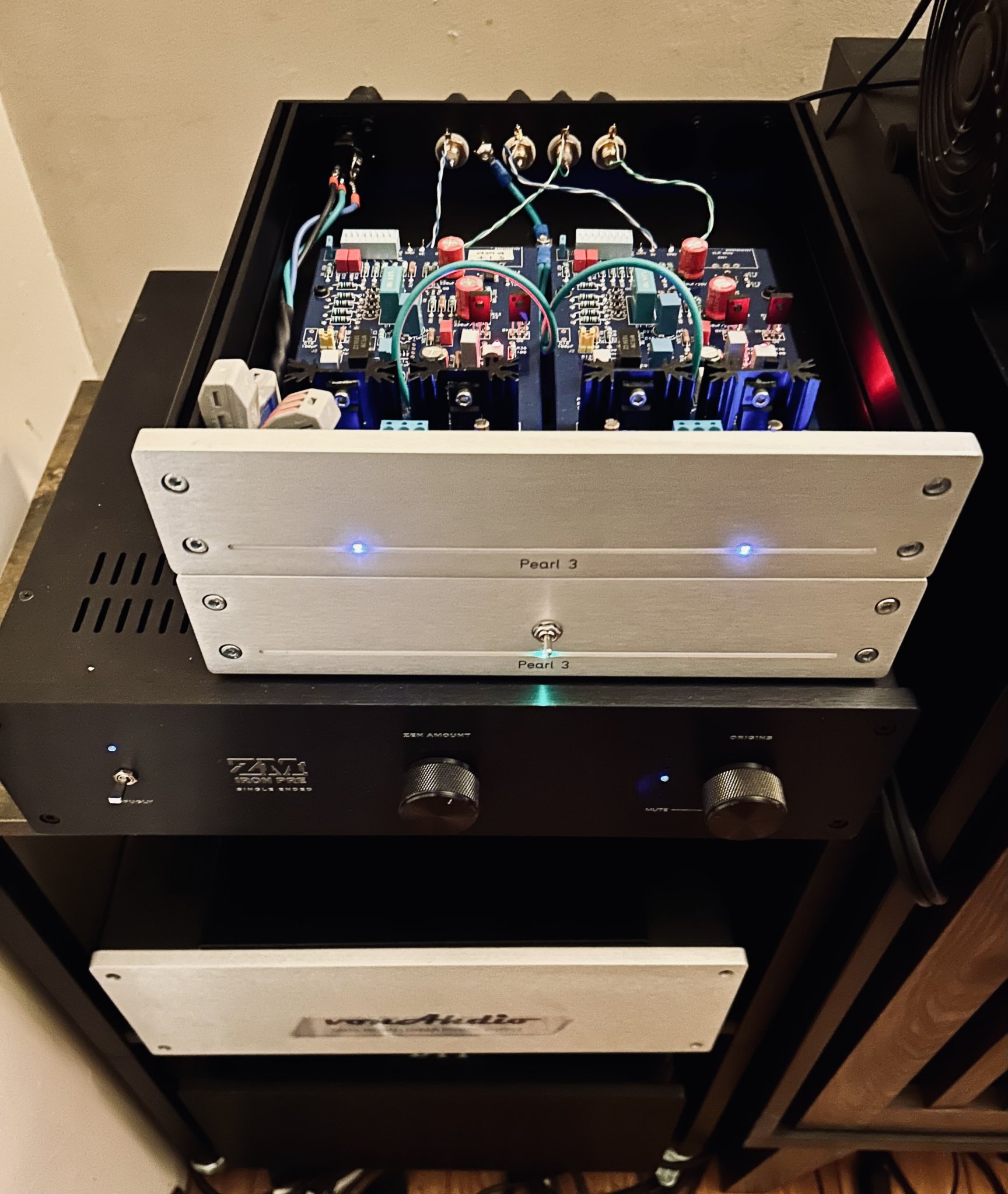

Success! Linear power supply completed with LED, switch, umbilical, cable gland (silly term ), and 4-pin XLR. It sounds wonderful, as expected.
Now I can use those Dell laptop bricks for the MoFo as originally intended.
Thanks to @6L6 for the great build guide that led me to keep the magic smoke in. And thanks again to @rhthatcher for the PSU GB and of course to @wayne for the superb design! I am a very happy audio loony.

Regarding the power cable between the two chassis. Which length do you plan for?
I can see many place chassis at top of each other. In this case power cable can be like 30 cm. But then it is not very flexible and regarding magnetic noise probably better to place units at a distance from each other. Then maybe best to make power cable 1m or?
But if amp total silent even if top of each other then best to have as short a power cable as possible?

one fundamental design premise is that the PSU will be remote to obtain the desired performance.
this being DIY you can make the umbilical as long as you like (within reason... you don't want to have excessive voltage drop) but not, perhaps, so short as to obviate the benefits of remoteness.
maybe choose a remote location that works for you... and make the umbilical long enough to reach?

I have already prepared for a captured umbilical at PSU end and I am lazy so I wait and let all you all do the "hard job" and then I will pick my solutionhere's a thought...
make the umbilical detachable at both ends and play with the length as needed.
But I will at least make cable long enough for at side by side placement. About 0.5m could be a good compromise. I feel that 1 m is too long.
At least 1M. 1.5 is better, more flexibility.
Good for photos, not for noise performance….
Nope.
What I am worried about is: noise pickup, DC-resistance (voltage drop) and I think noise pickup is the one I am most concerned about
Dont worry about those, just use a shielded cable, and wire as shown in the guide.
