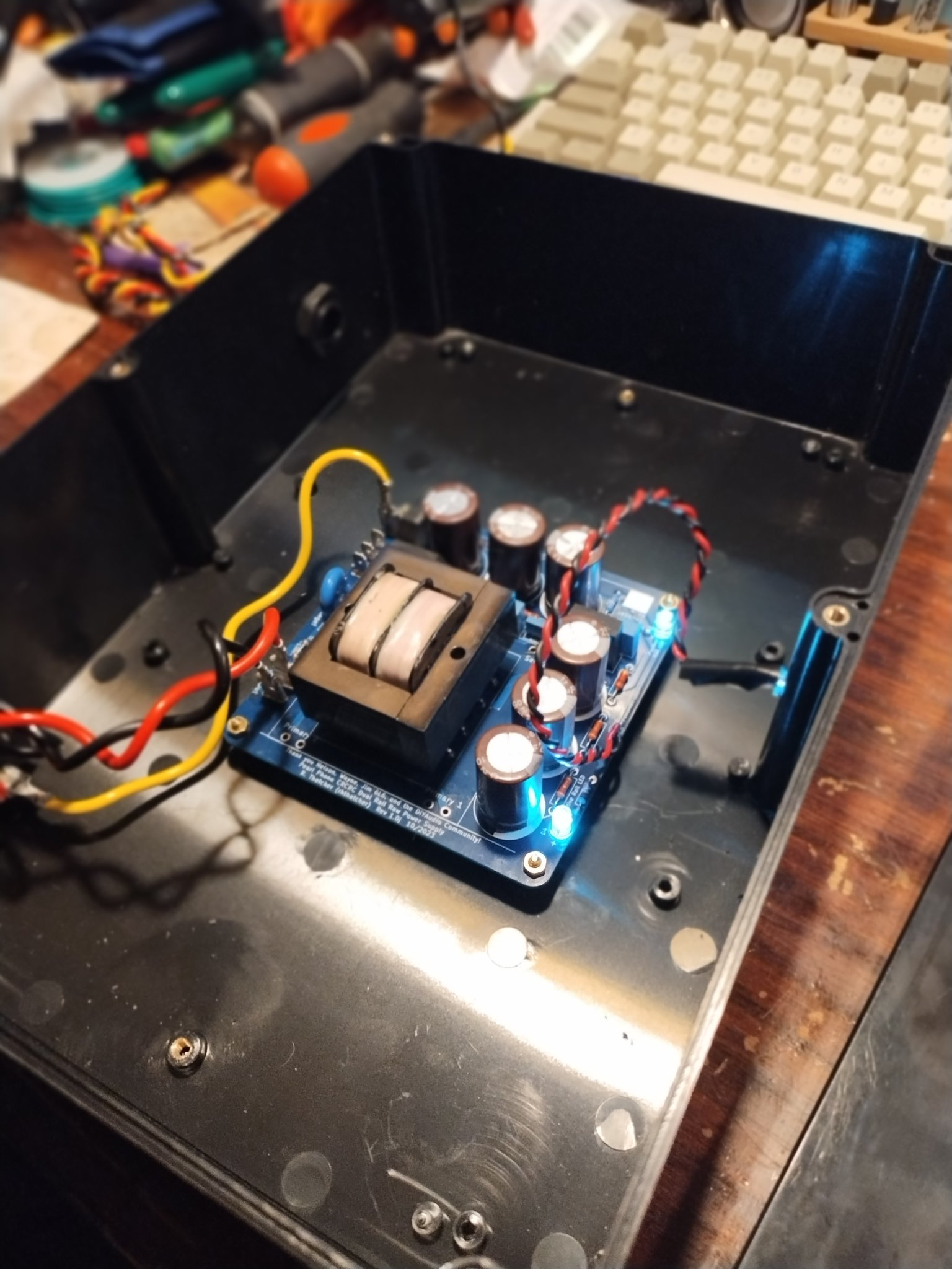

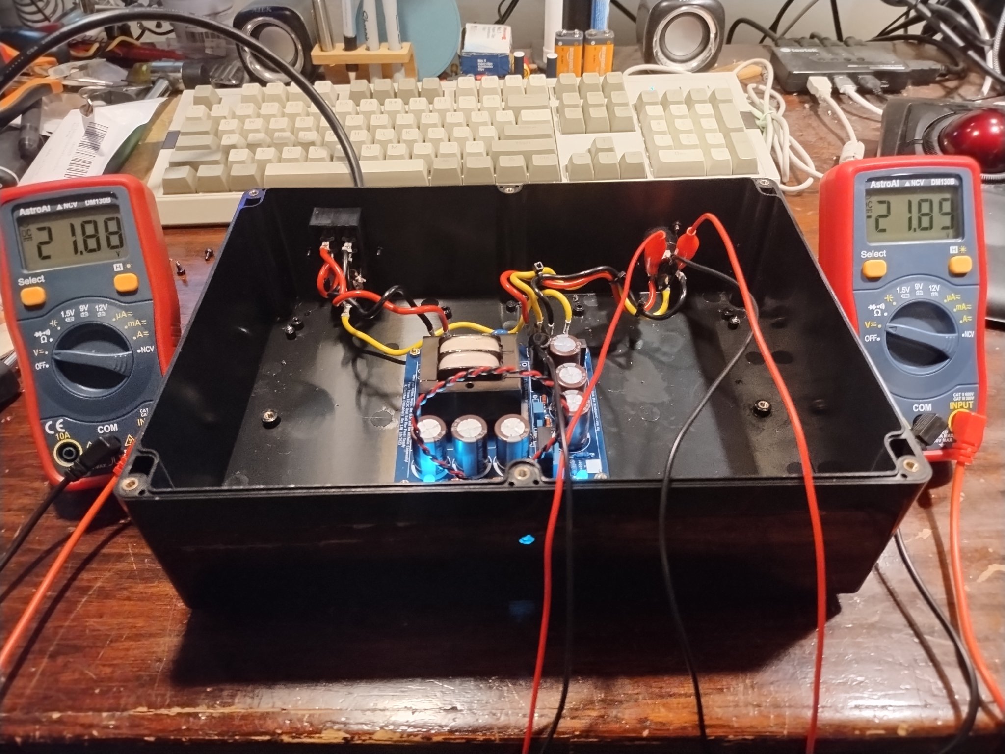

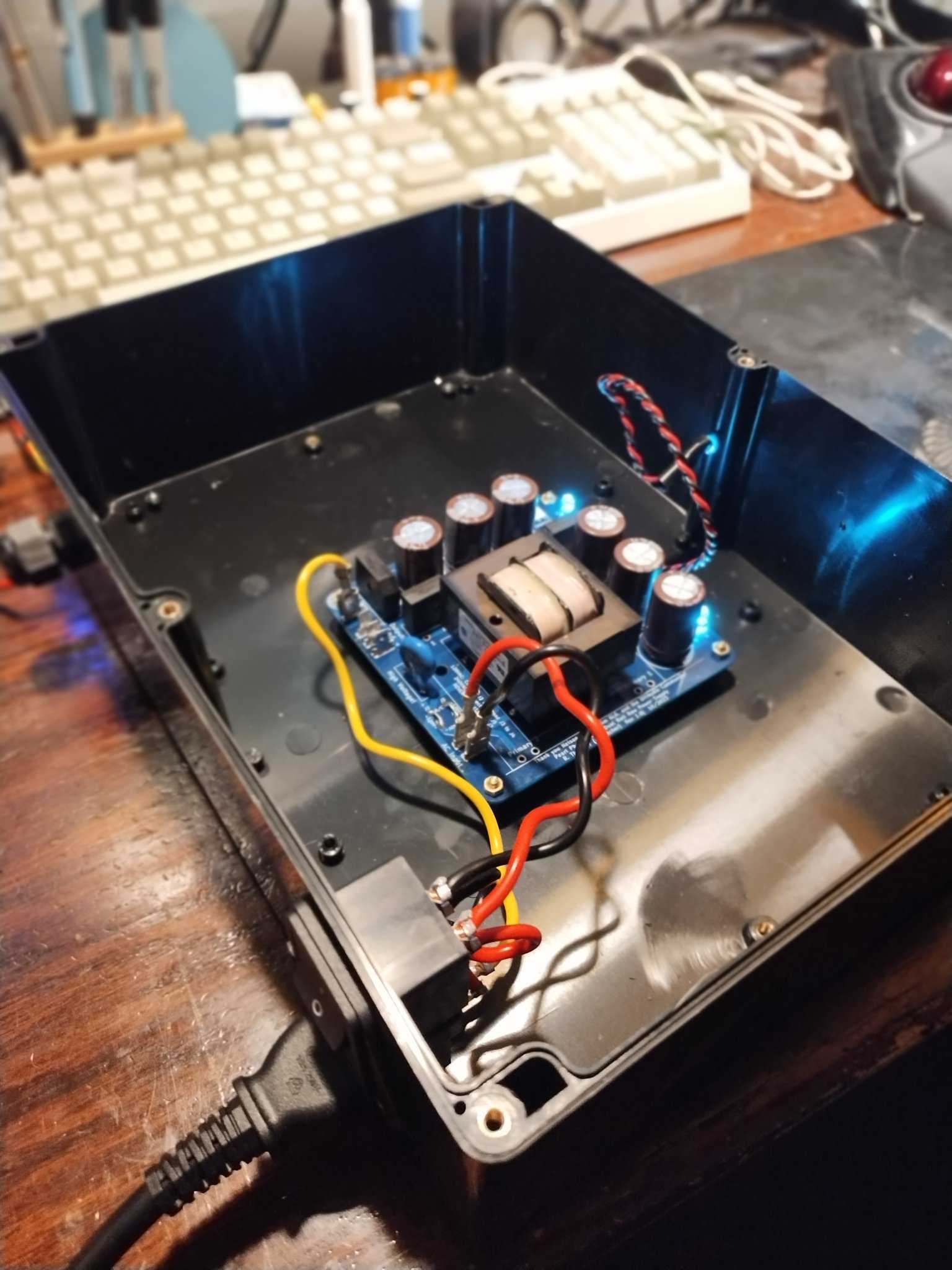

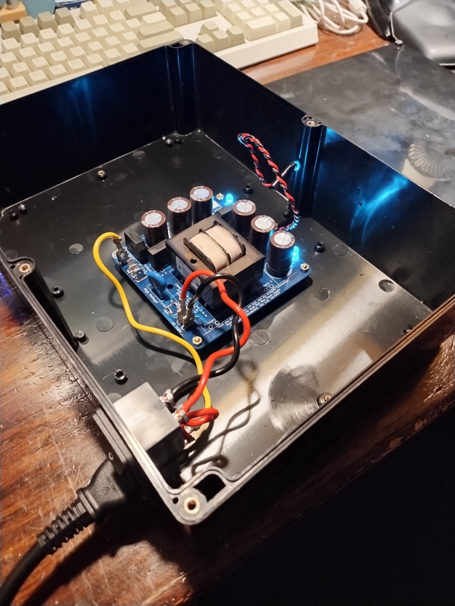

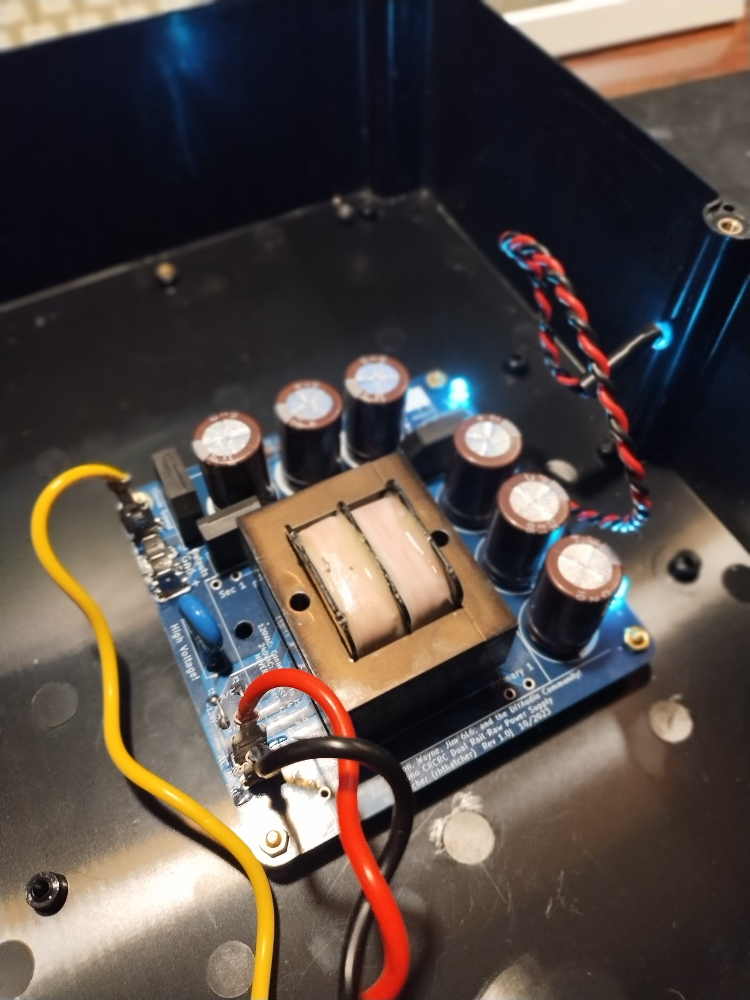

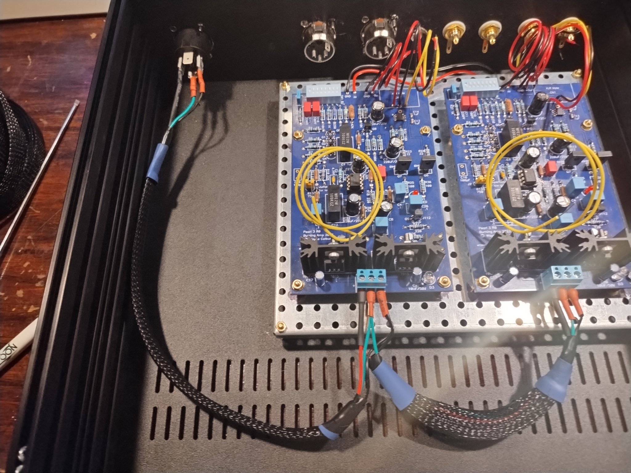

Just finished my Pearl 3 last night and plugged it into my system. Here are some photos of the build. First off is the PSU, in a separate enclosure. When under test I get 21.88/21.89 Vdc output.

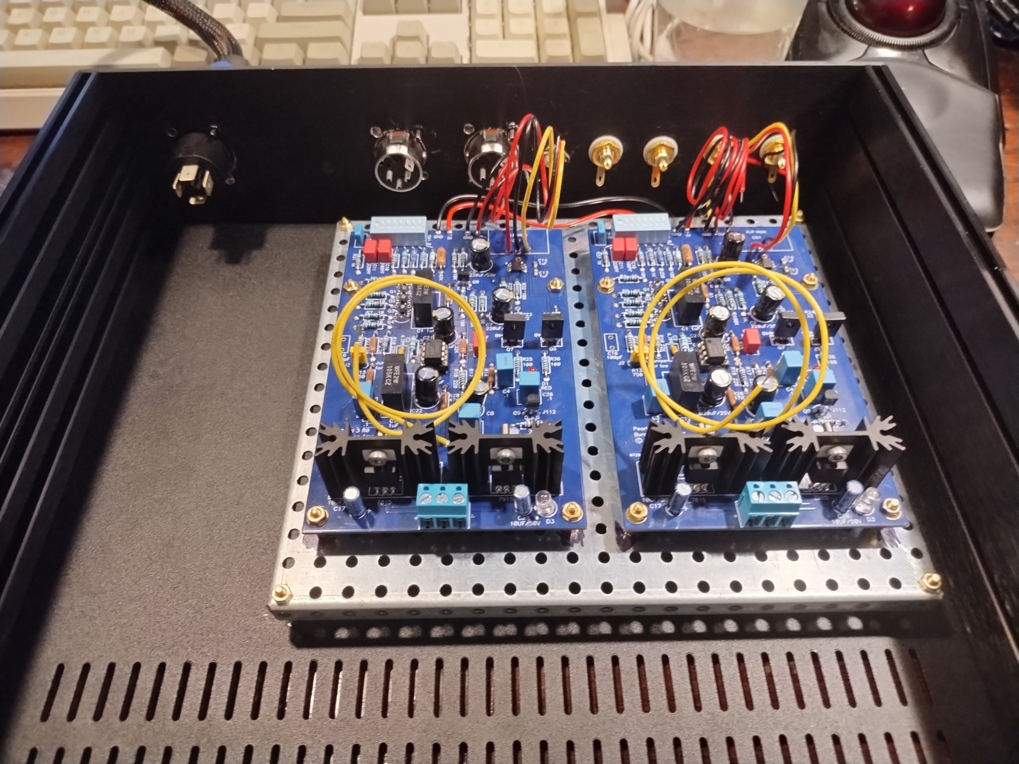

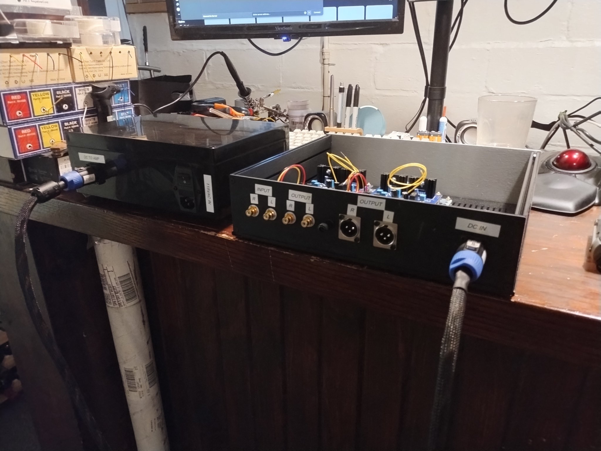

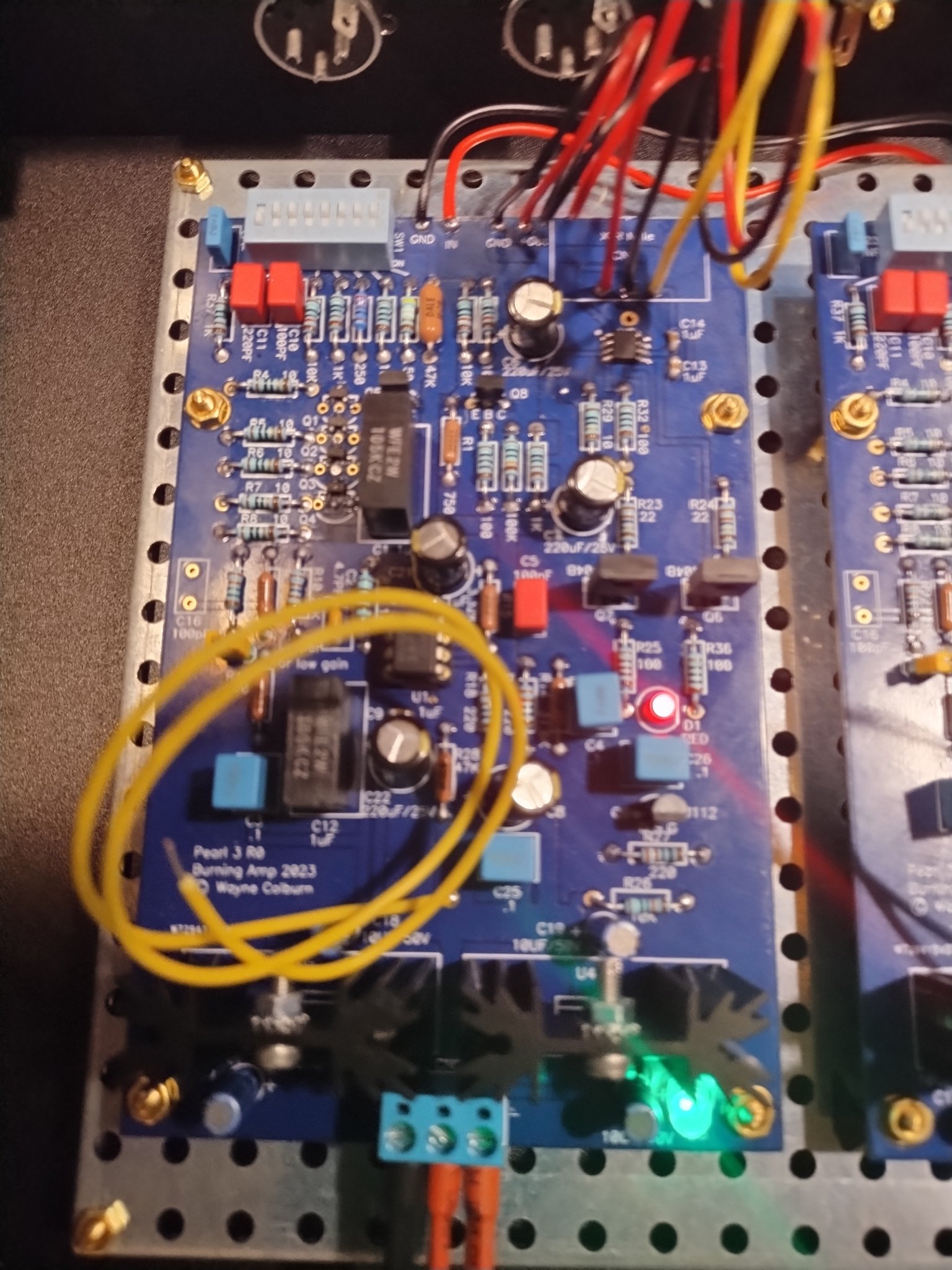

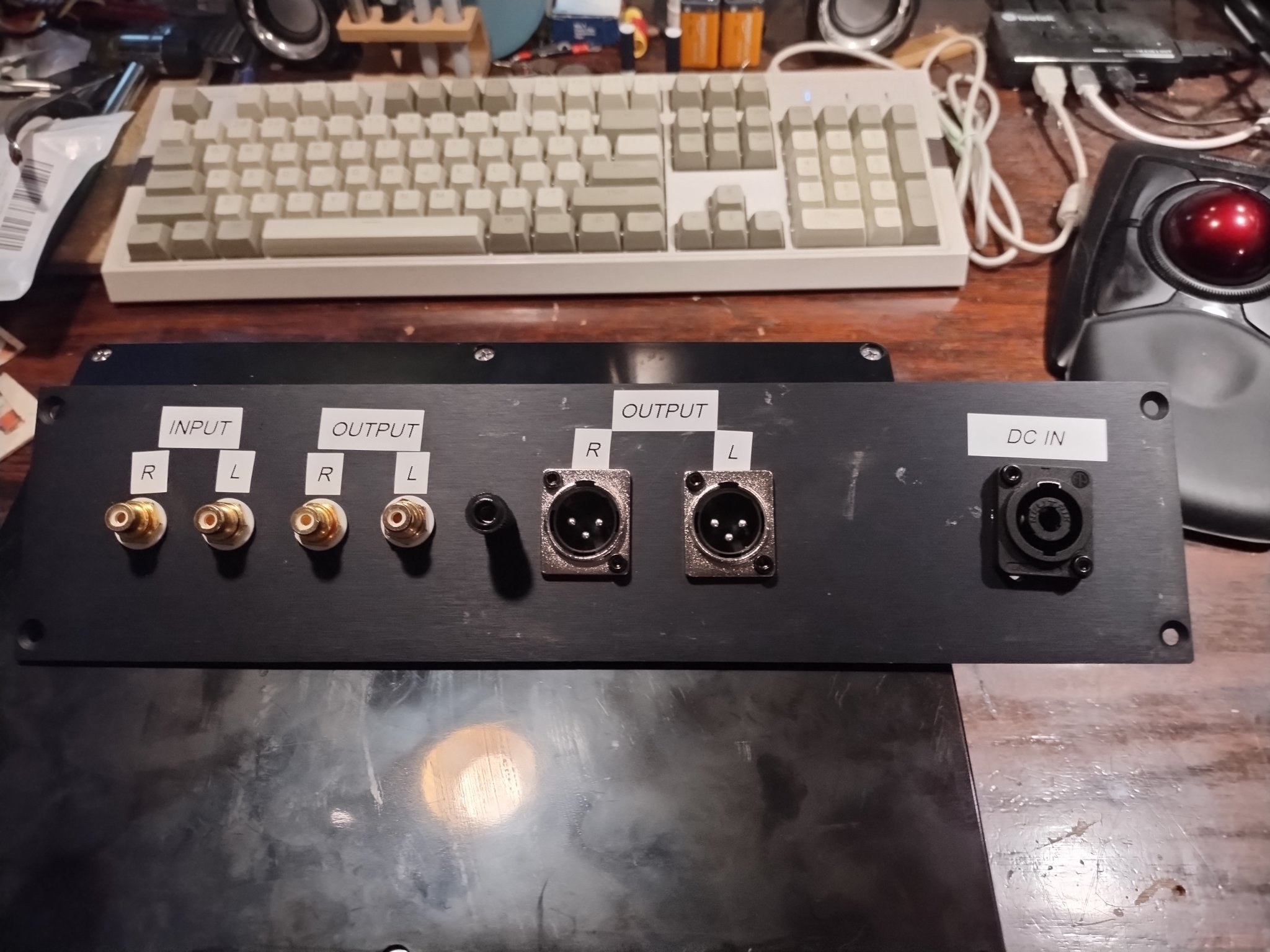

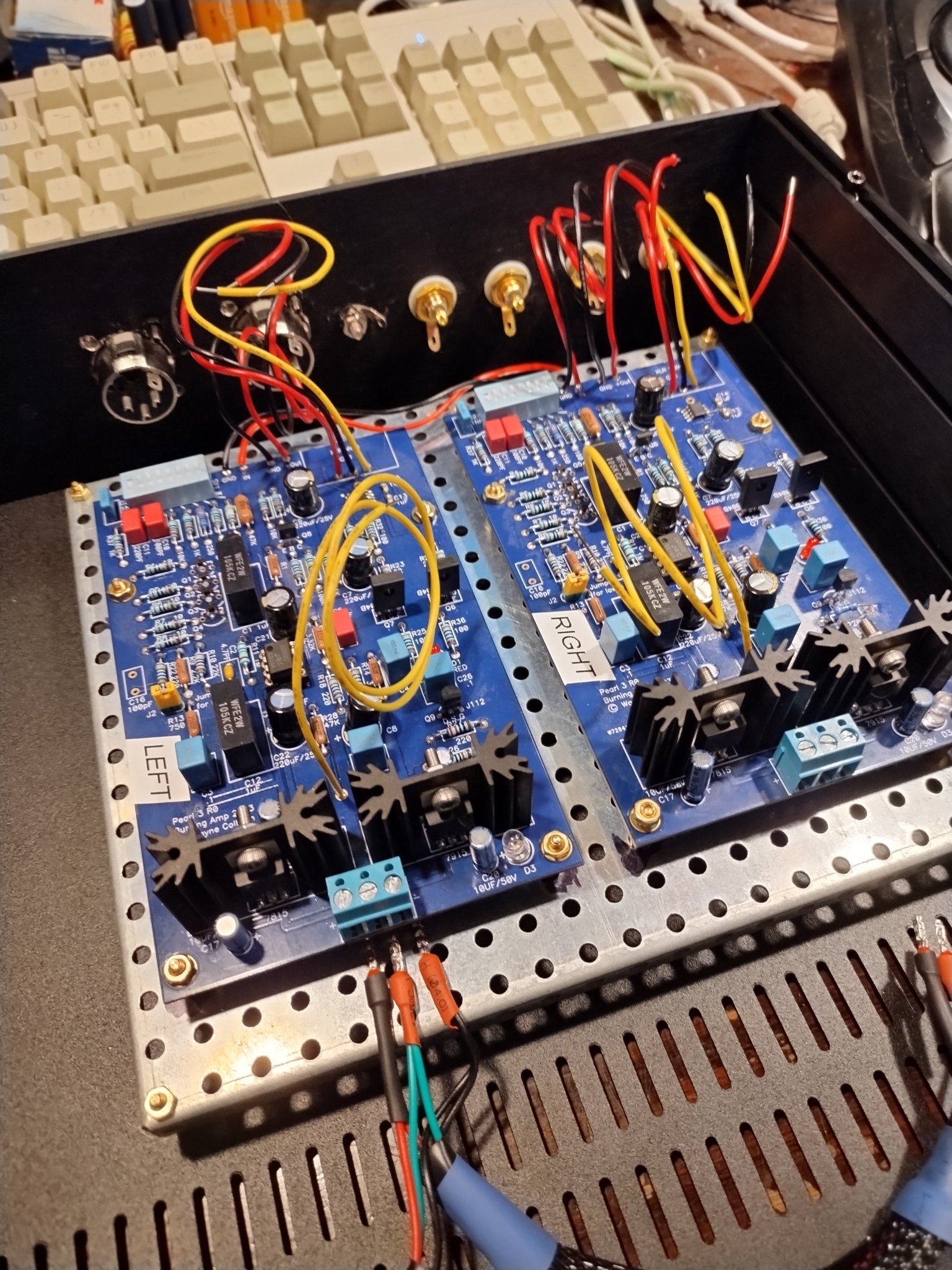

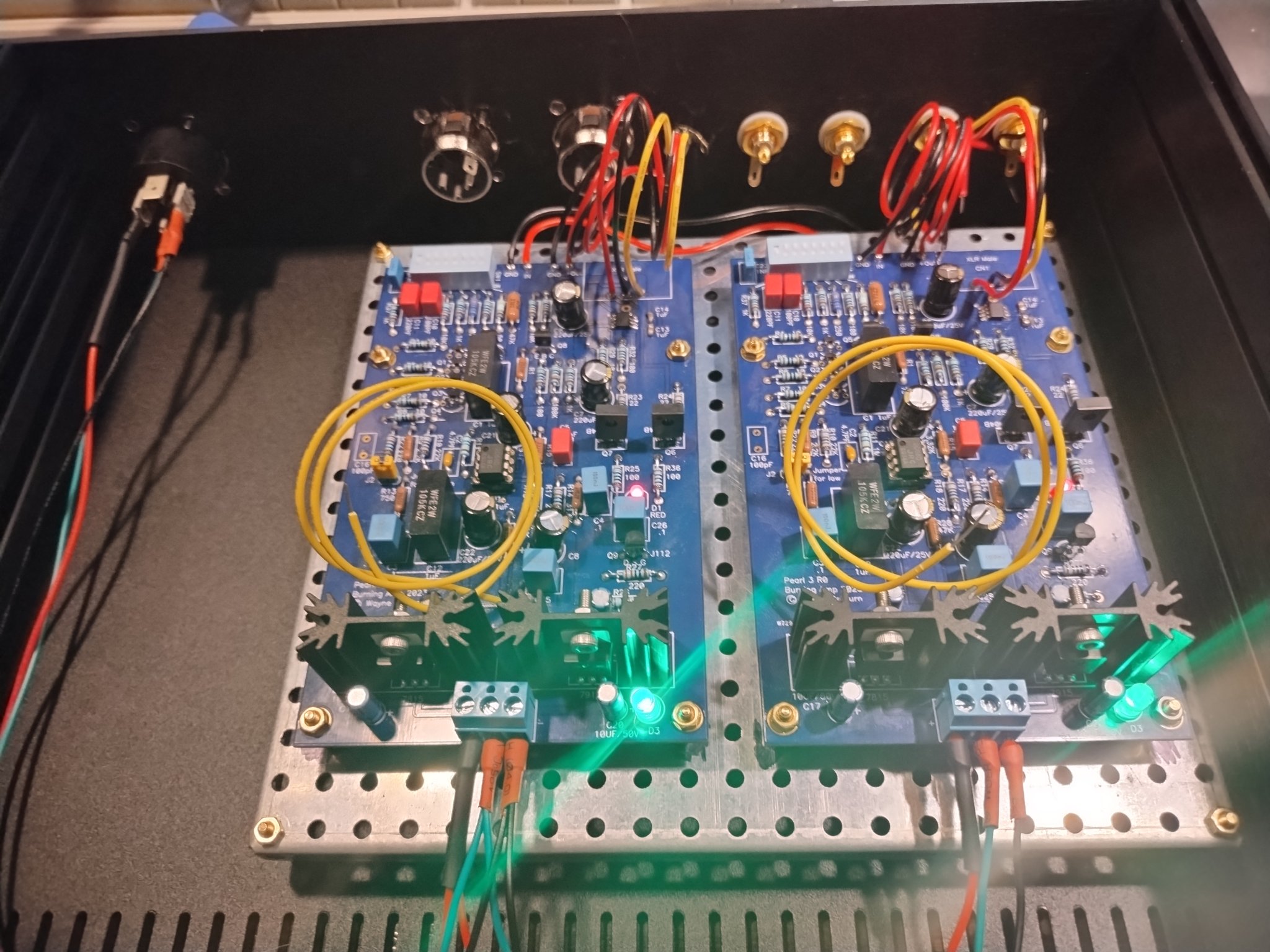

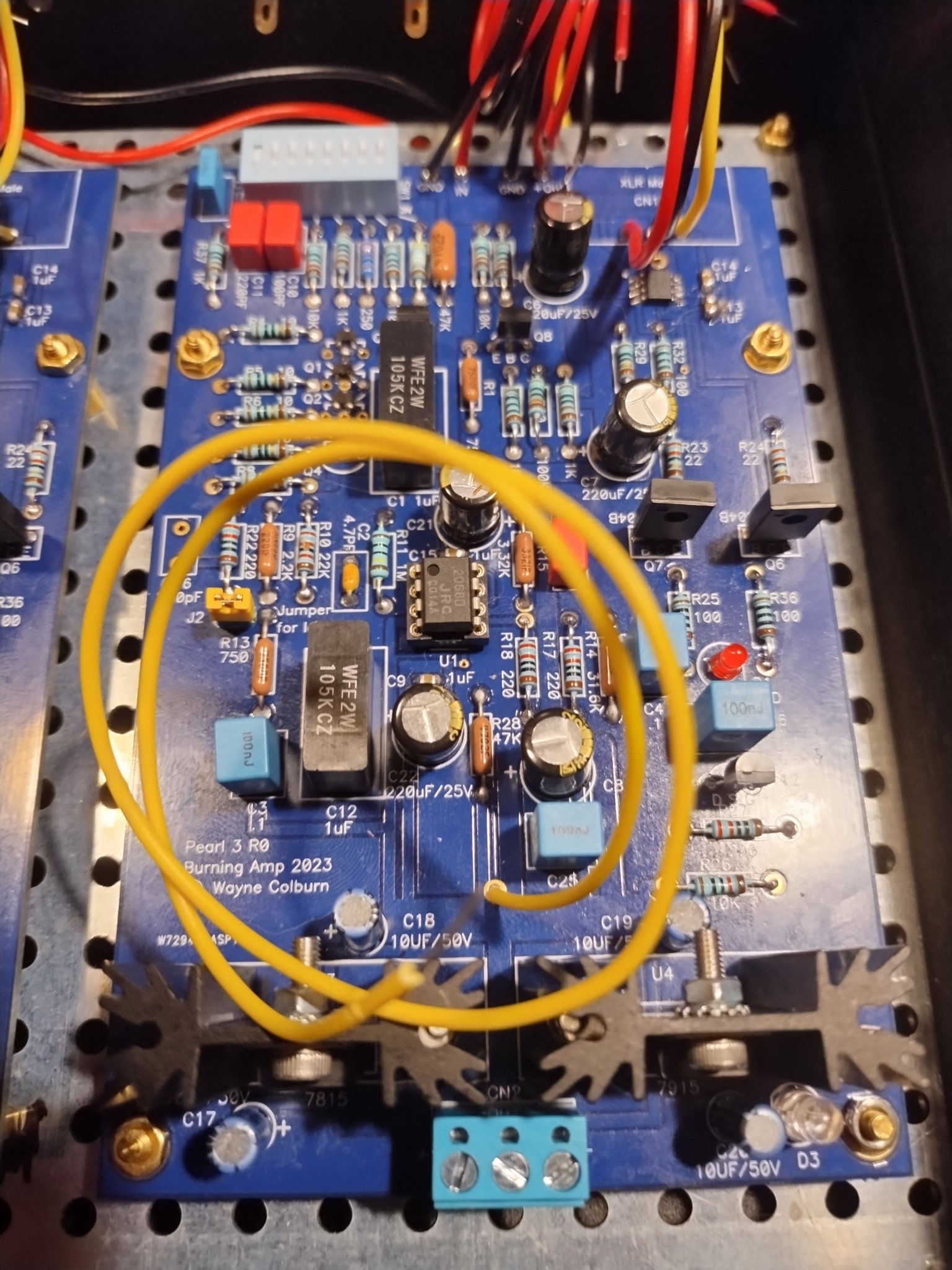

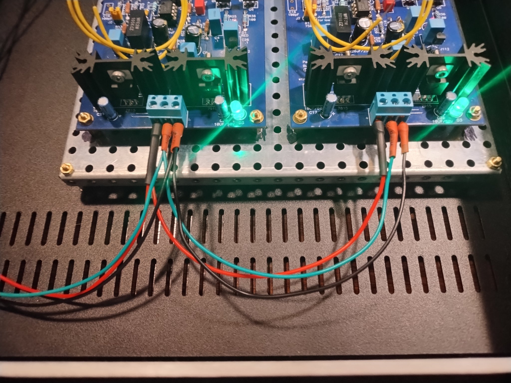

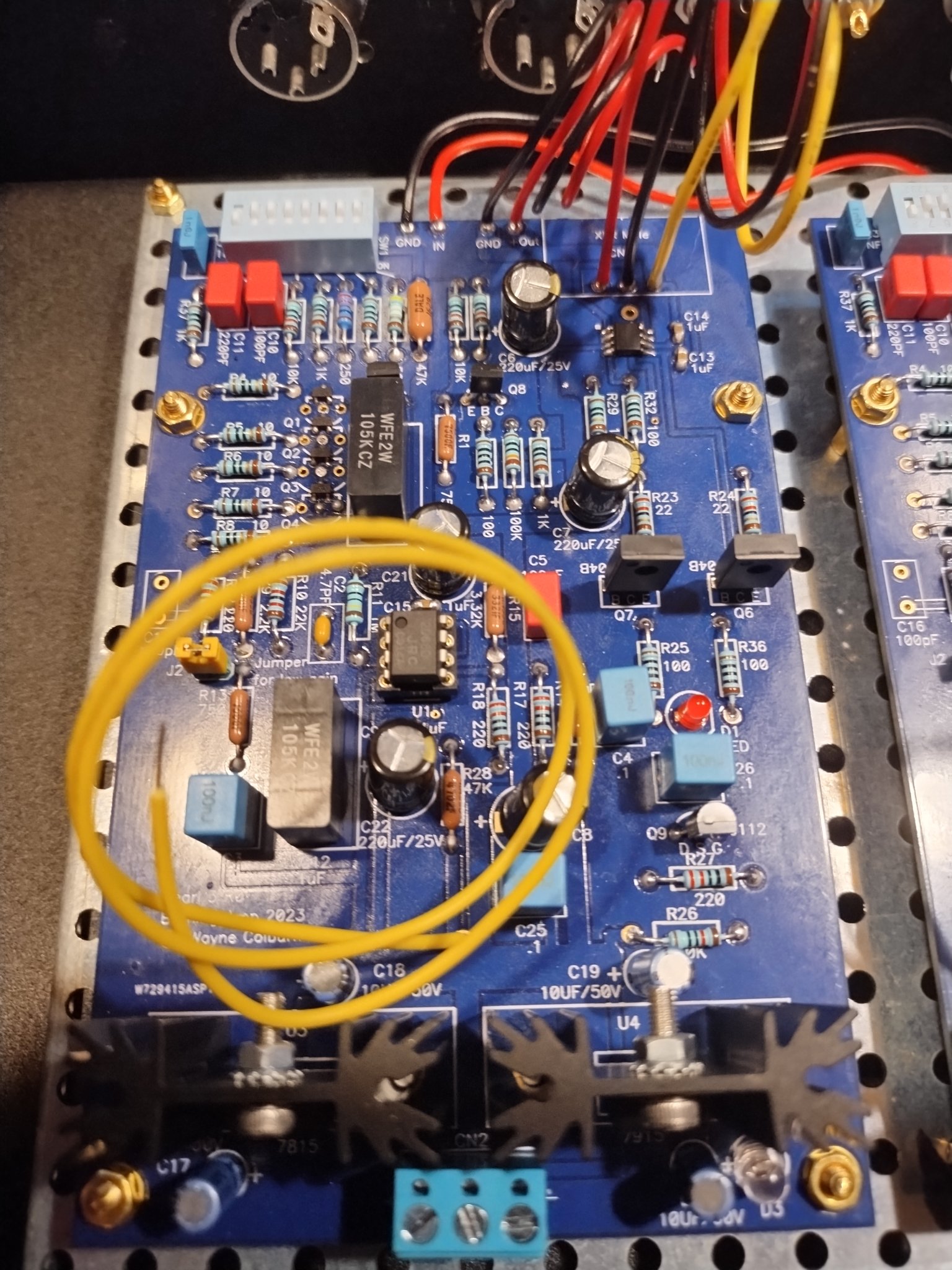

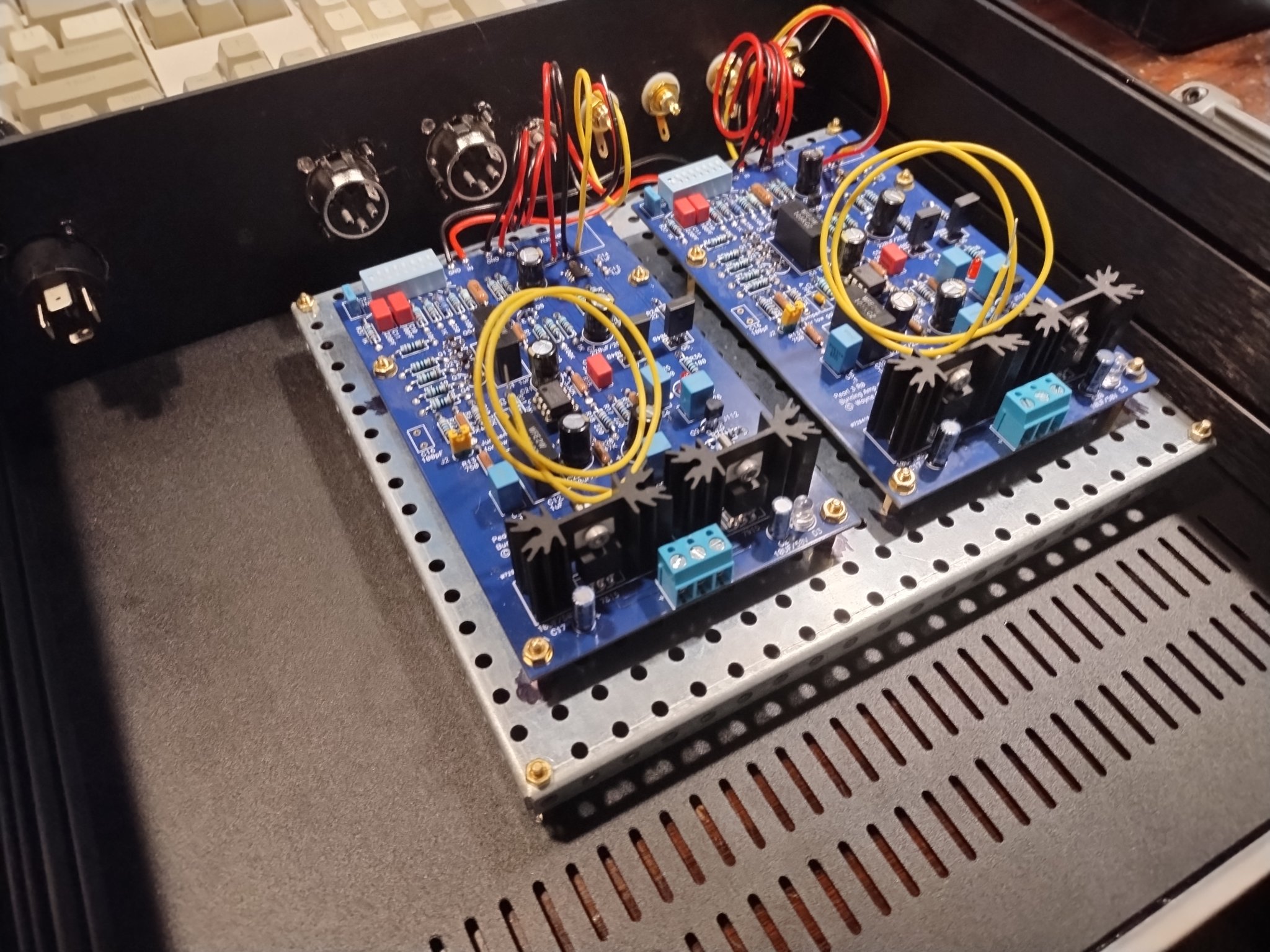

Next up is the enclosure, it's one from the DiyAudiostore. Boards installed and psu connection wired in. 14.99/15 Vdc on the outputs of the positive regulators and -15/-15 on the negative regulators.

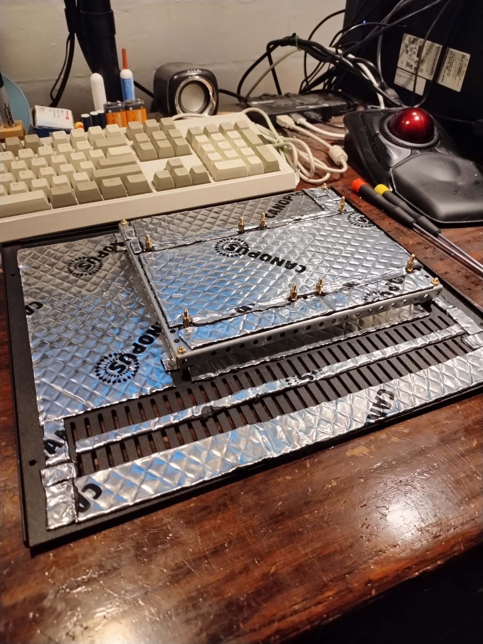

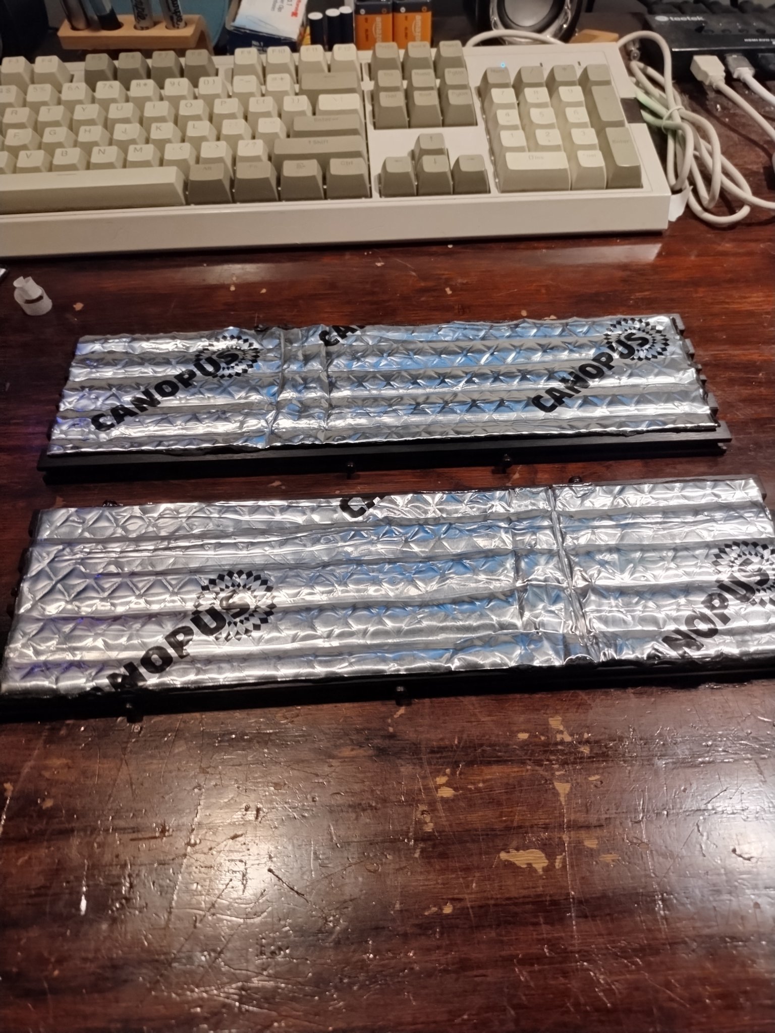

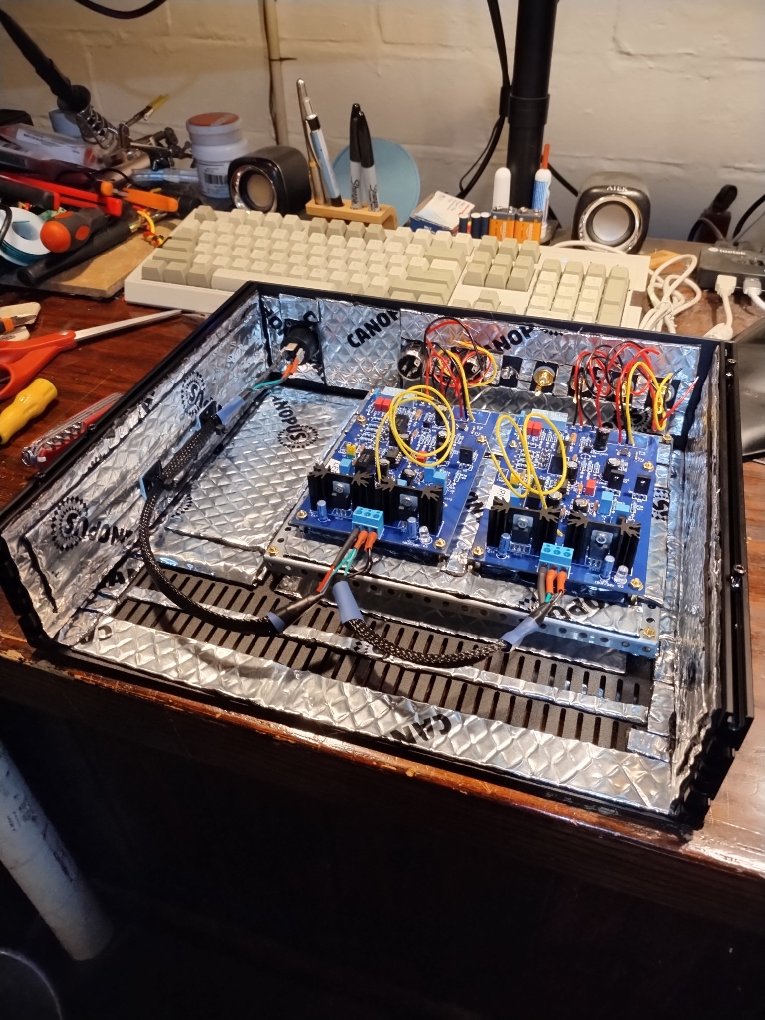

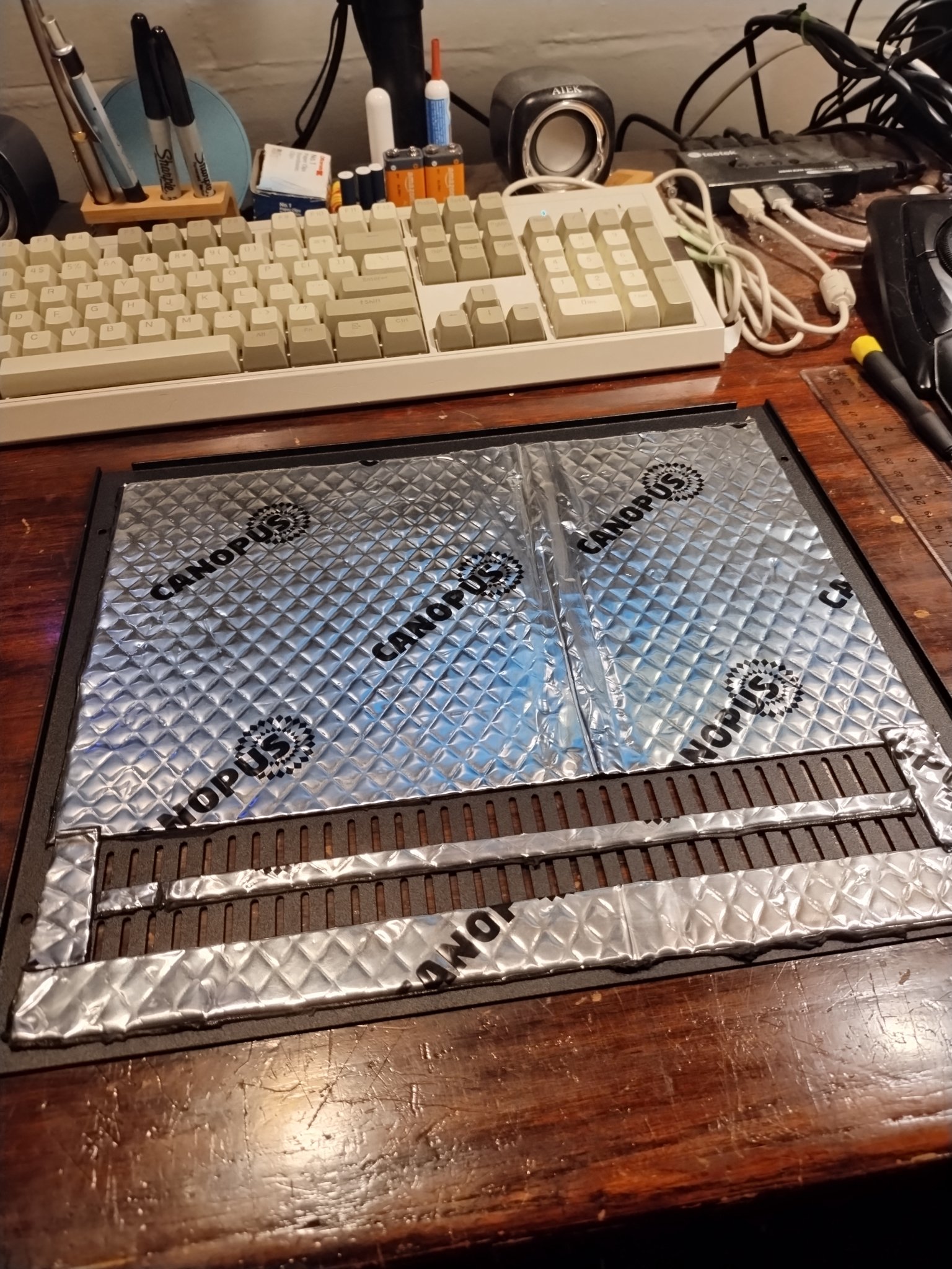

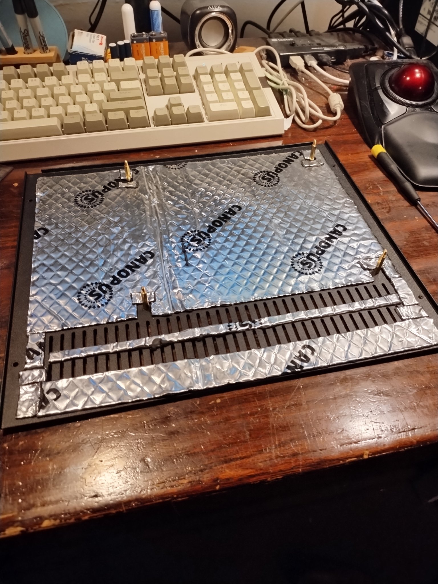

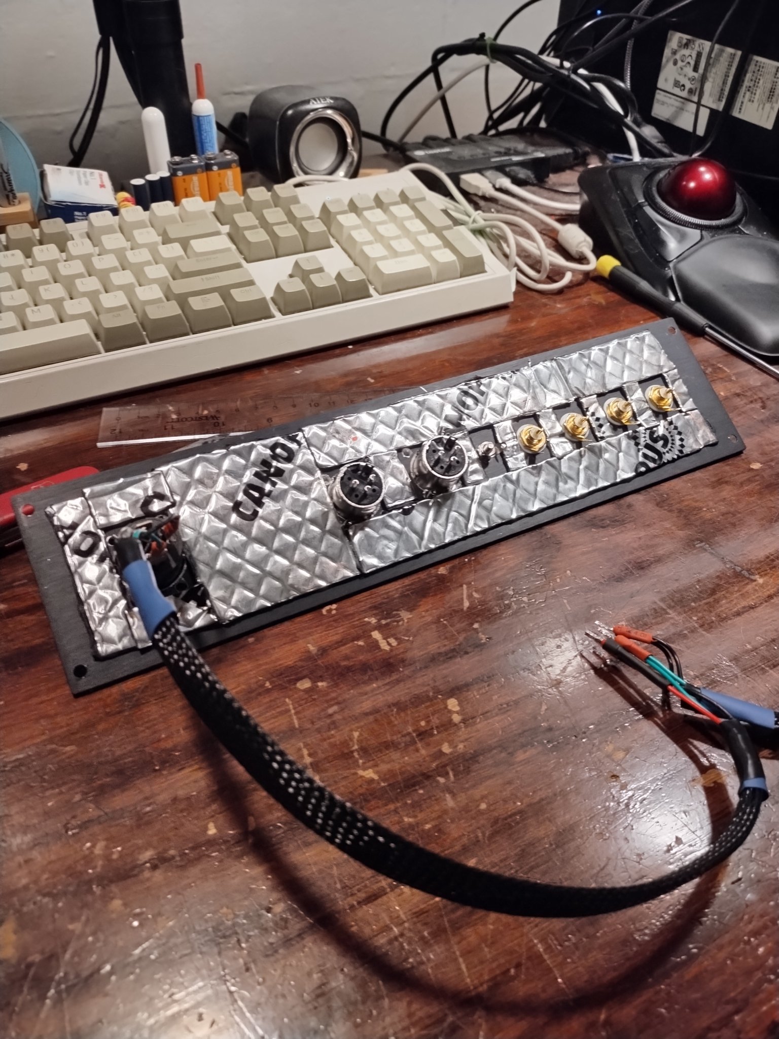

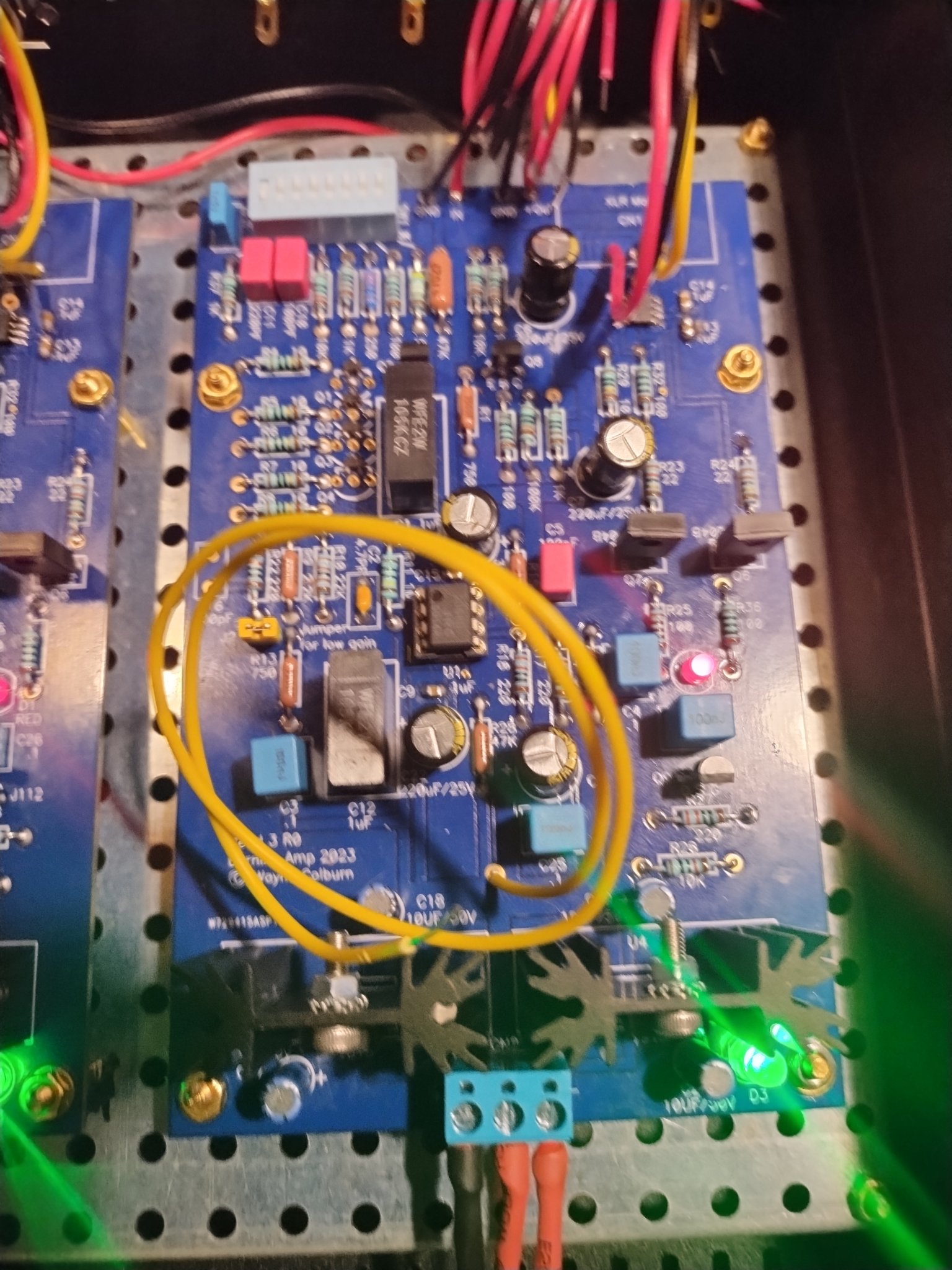

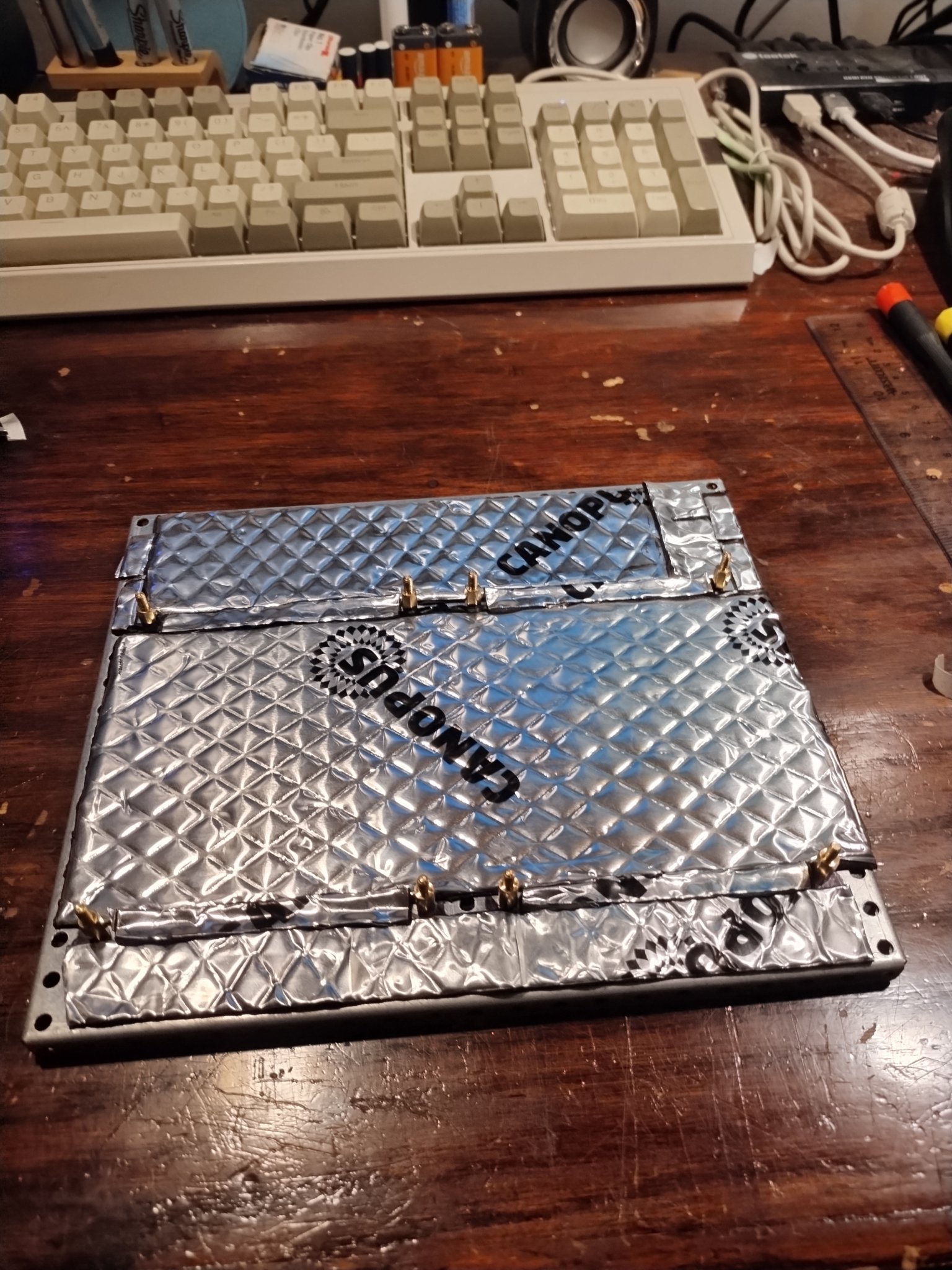

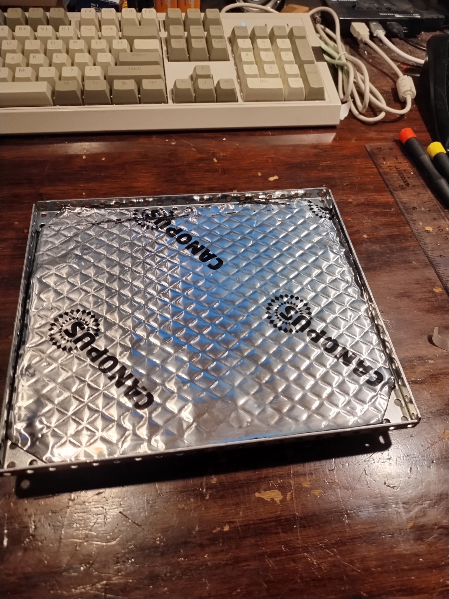

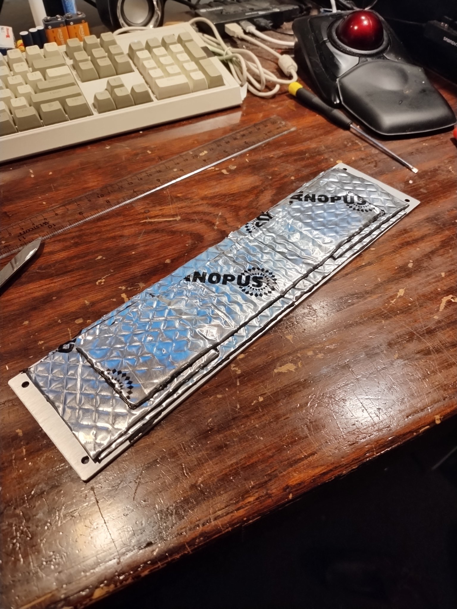

I decided to add dampening to the enclosure (not because I had to, but I had the sheets so why not) this is DIY after all. I also fitted the PCB's to a removable mounting plate so I could add even more damping material by the boards.
