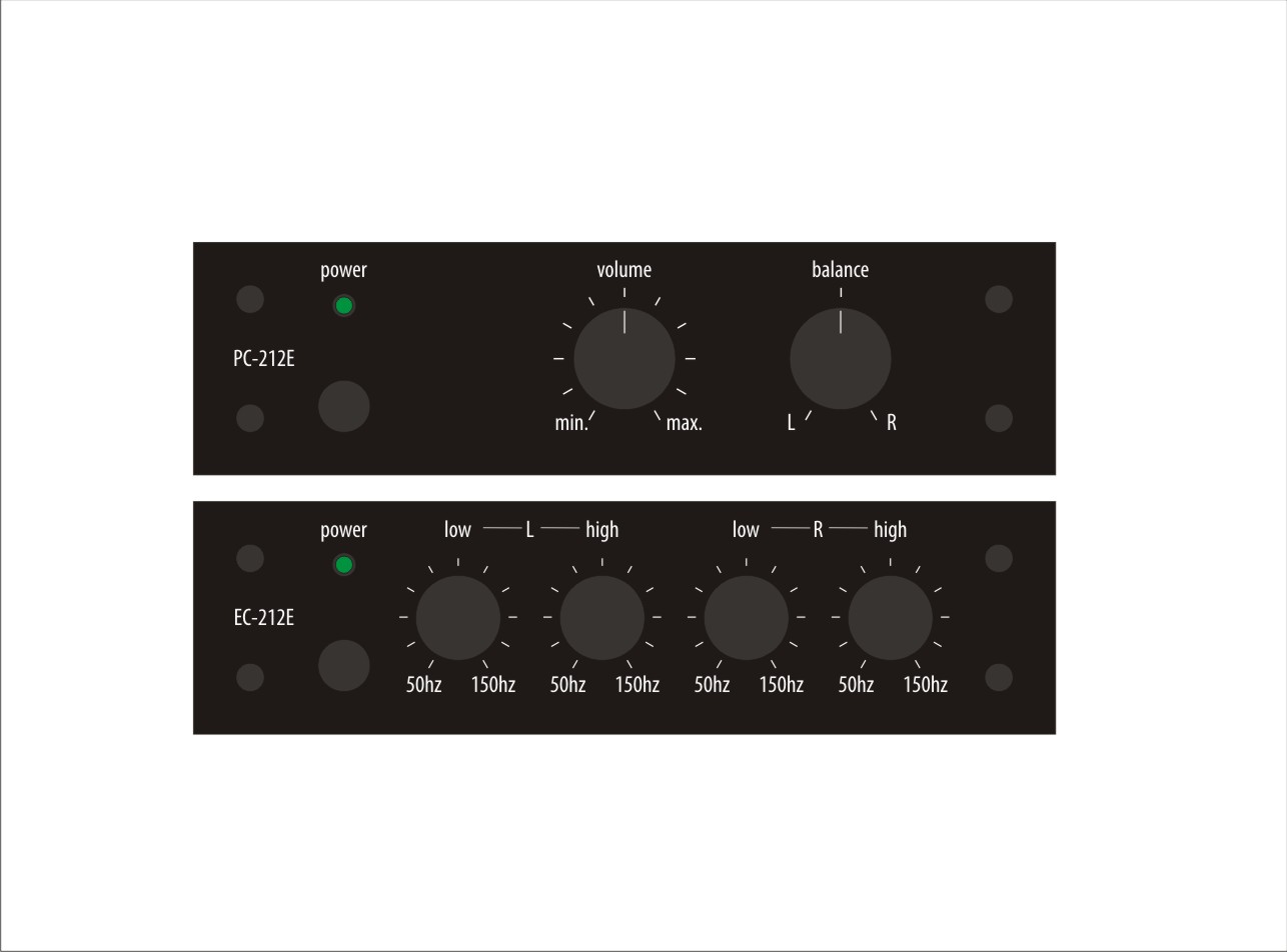

I'm making a new preamplifier and active crossover for my music studio. I have made one that I have for about 8 years. It is standard preamplifier with 4 inputs, volume and balance pot. It is ok but i need something better and with only one input.
Enclosure for preamplifier will be case from Teac cd rom. Active crossover will be in second old Teac cd rom case :)

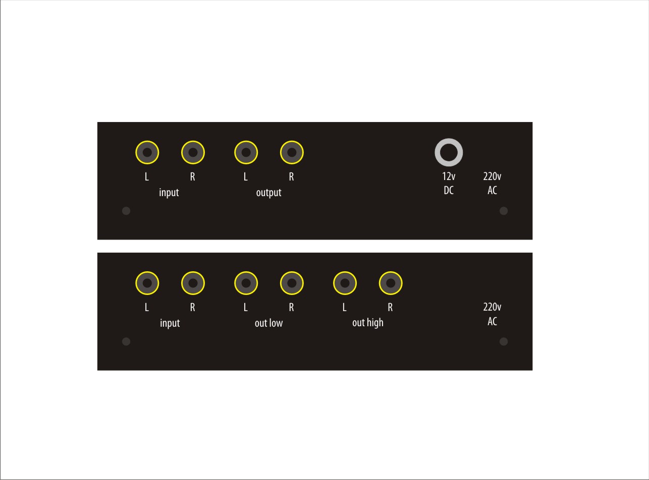

For now i have a picture done in Corel Draw, how will it look. Sides will be done with red acrylic, front and rear will be laser engraved with black gravoplast 1,5mm so the letters will be white. Top will be sprayed in black.

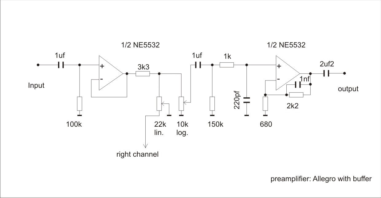

Here is the schematic for preamplifier :)

I'd lower the resistances on the +inputs to ground to something approaching the resistance seen by the negative input. This will reduce resistive noise and DC offset. At nominal input bias currents you wouldn't think it would matter, but in my experience with NE5532s in active filters, even 10K on the inputs resulted in >30 mV DC offset. I cured that by swapping in OPA2134s.
When designing your filters, I'd recommend sticking with resistances somewhere in the 2-3K range when possible.

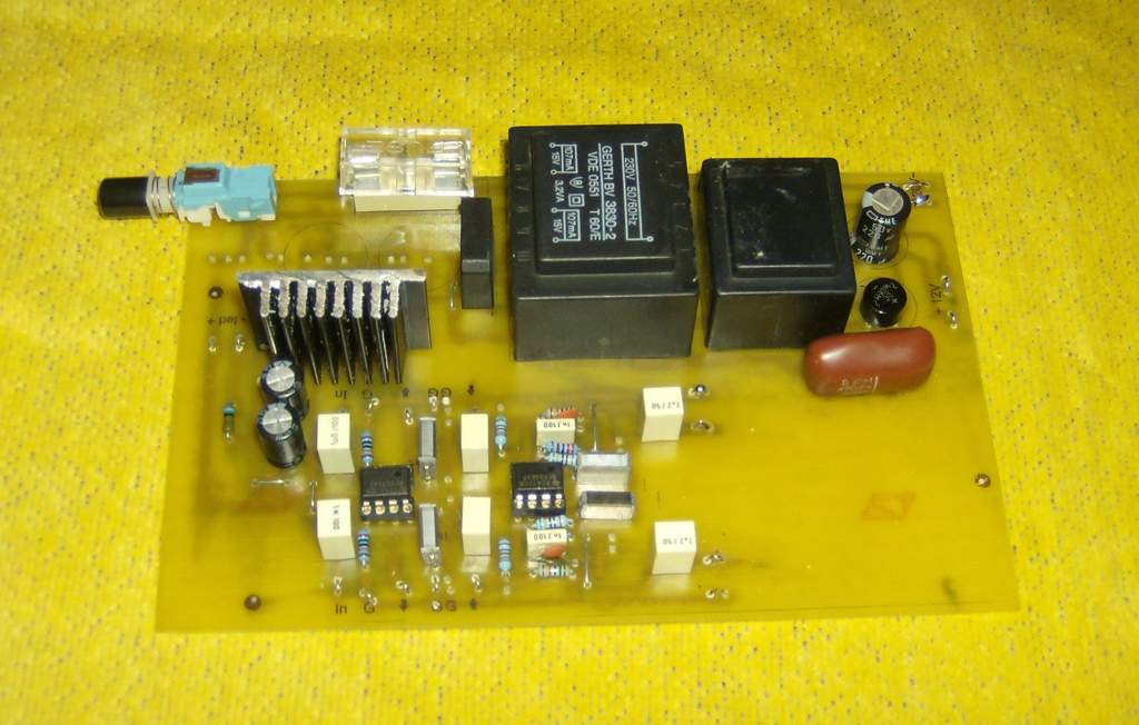

It is alive!
I've been busy so i could not post pictures so here they are.
First pic is preamplifier on board. The smaller transformer is 12v for remote rely which powers the main 220v for other equipment. The missing parts on pic are supply caps.

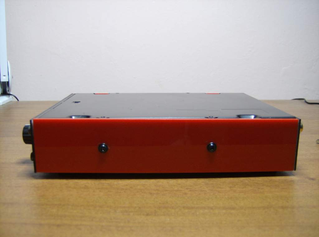

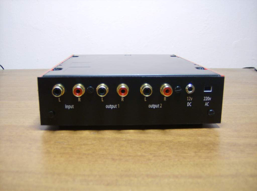

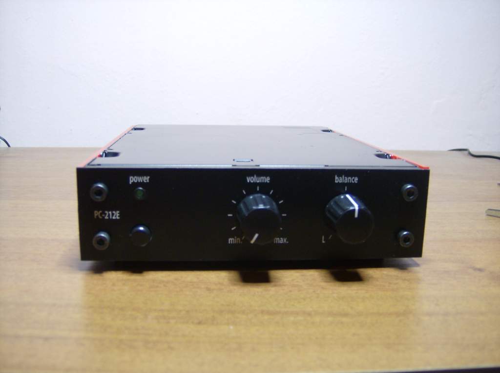

And the case.
Like I said before,the case is modified cd-rom case (without cd-rom of course :) ).
Front and back plates are made with gravoplast, some kind of plastic material made for laser engraving.
Sides are made from red plexiglass. Case if spray painted in black.
I work with laser so I did that myself :)
There are two line outputs because one is connected to active crossover, which will have similar case, and other can be used for anything else without interrupting or disconnecting the main speakers.
The sound? Very pleasant, warm, neutral and the most important, I like it very much! :yes:
