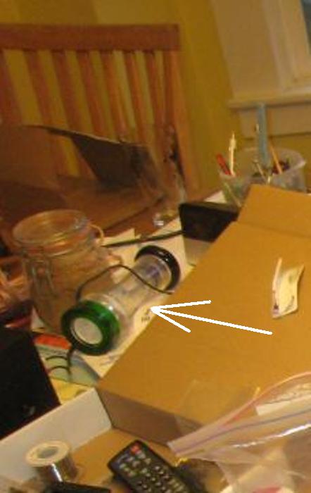

I even got the IR repeater working on the Squeezebox, so my ancient Pioneer VSX-4500S (Anyone know RMS on this thing? It predates available PDF docs) is now slaved to it for totally minimal control.
Yes, I have a dog.

We have a black female whippet. It's not topical, so I'll only put one picture in this thread:

Hates the cold & wet, so, hardly an ideal dog for Portland. They love comfort - fluffy beds, heater vents, cuddling, etc. Most are fairly aloof, but ours is atypical in several ways, and she's very social with humans.
How did you know we had a dog, anyhow?
