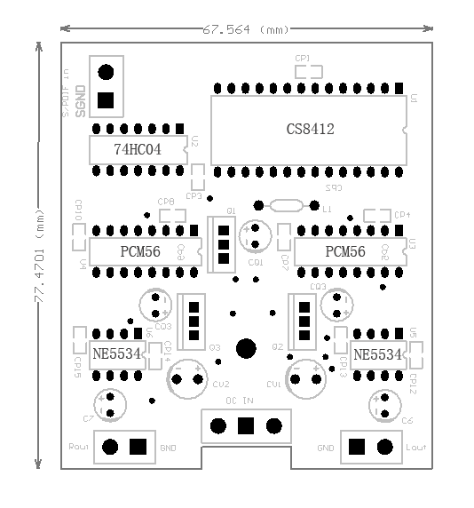

hi all,
so sorry to disturb U.
this was my old job before I sick. I will start to produce for it. I hold this will be another cheap version, slim size dac for diyers.
take a look for the PCB,
upgrade for this dac was
8414 to Dir9100.
large value electro-caps
upgrade better oscillator & 74HC04.
parallel PCM 56 chips.
very small size because power supply will use note book transformer power supply 18V.
thx
thomas

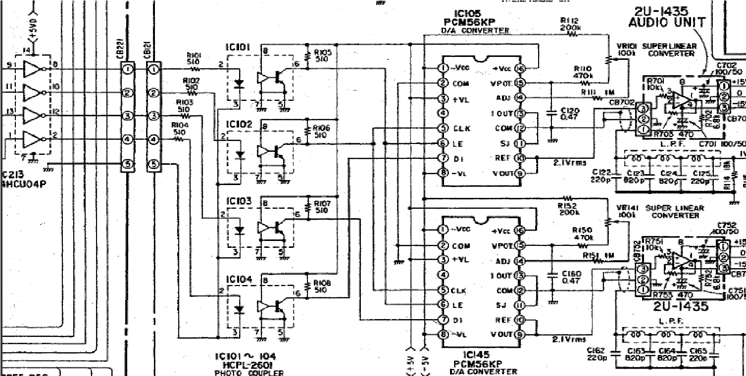

The PCM56, if MJ is anything to go by, is indeed very common in Japan but the TDA based nos dacs, commercially at any rate, outnumber the AD1865 ones, but I digress. The point is that removing the delay is not inherently a bad thing or as deleterious as portrayed not to mention the fact the stopped clock method has considerably less data jitter than any other method.
The stopped clock circuit is in the AD1856 datasheet. figure 14.
