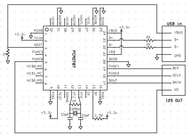

PCM2707, I2S out
thank you :) Pretty obvious mistakes :headbash:

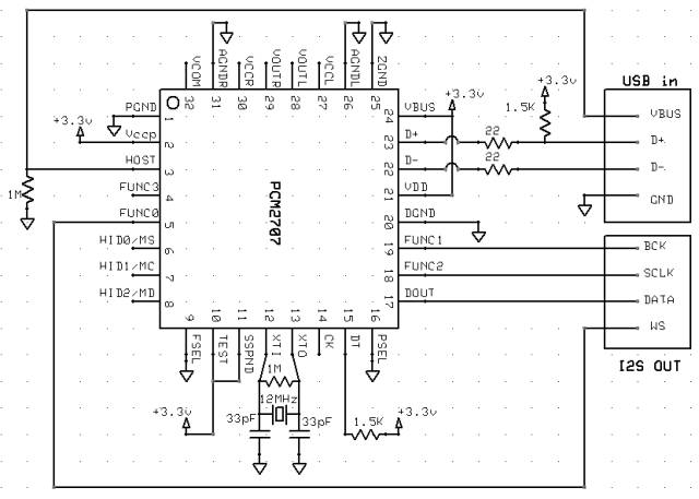

I've updated the schematic below (I can't see how to edit the first post :xeye: ).
Do you have some experience with that chip and external clocks ? The datasheet says that :
An external clock can be supplied from XTI (pin 28 for PCM2704/5, pin 12 for PCM2706/7). If an external clock is supplied, XTO (pin 1 for PCM2704/5, pin 13 for PCM2706/7) must be left open. Because no clock disabling pin is provided, it is not recommended to use the external clock supply. SSPND (pin 27 for PCM2704/5, pin 11 for PCM2706/7) is unable to use clock disabling.
Basically, the question is : is the SPACT system really good enough to provide a decent clock or should I try to implement a XO clock on it ?
No point to do it. You 'll not improve nothing. SPACT system has own VCO, which determine phase noise level of the output clock. XTAL clock only provide functionality of SPACT system, but it is not reference signal of SPACT. Phase random walks, which depend by jitter of XTAL clock, has enough high frequency spectrum to be eliminated by analog PLL, which followed after SPACT.

PCM1794 doesn't accept direct spdif. But the PCM2707 usb device is able to directly output I2S, not spdif. Why would we need another conversion ?
Our big problem now is : the pcm1794 needs the classical 3 I2S signal (LRCK, BCK and DATA) and the PCM2707 is able to provide those. However, the PCM1794 also includes a digital filter. This digital filter requires a system clock. This clock needs to be synchronized with the LRCK clock. The question is : is the sck output of the PCM2707 able to provide that sck a/ synchronized, b/ with low enough jitter ?
