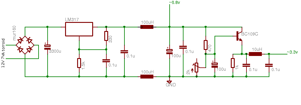

well good news! ive been fiddling around trying out some of your easier to implement suggestions and it seems much more stable now. in fact i've not yet been able to make it disconnect at all!

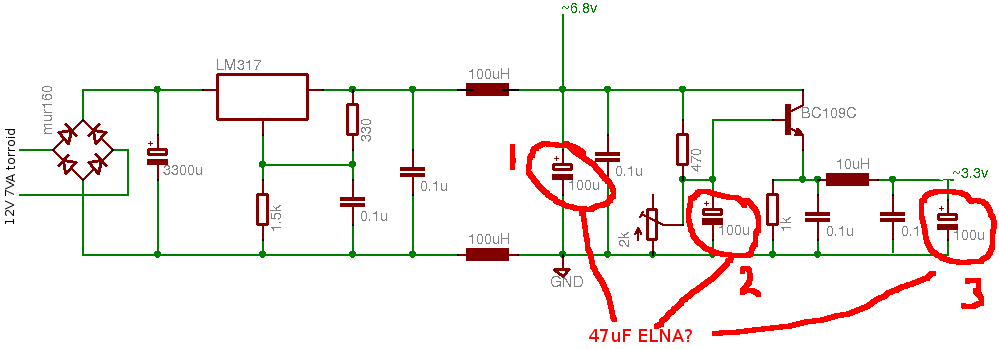

i've removed the inductors on the ground lines and hard wired them all together, added a 10ohm resistor to the base of the bc109 and a ceramic cap over the 100uF in the regulator circuit. the 10uH inductor is still in its current location as moving that was a little more work.
fingers crossed all my problems are now solved and i can start work on my enclosure
thanks so much for all your input. i reckon it was those inductors all along. maybe i should be on a physics degree rather than chemistry - it might serve me better in my hobbies

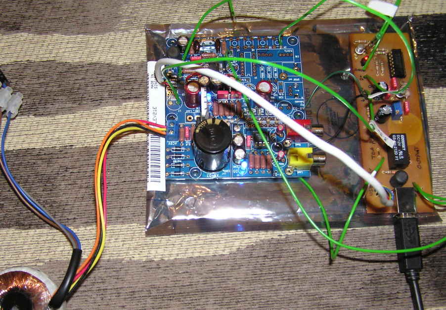

i thought i'd give my dead board another try to day - plugged it in and its working again!?!? :S that's despite me failing to get it to respond at all last week. this thing is seriously puzzling me, why does leaving it alone for a day/week suddenly fix it!? needless to say it lasted all of 13minutes and then disconnected itself again.
its so frustrating having something so close to perfect and yet utterly unreliable.
