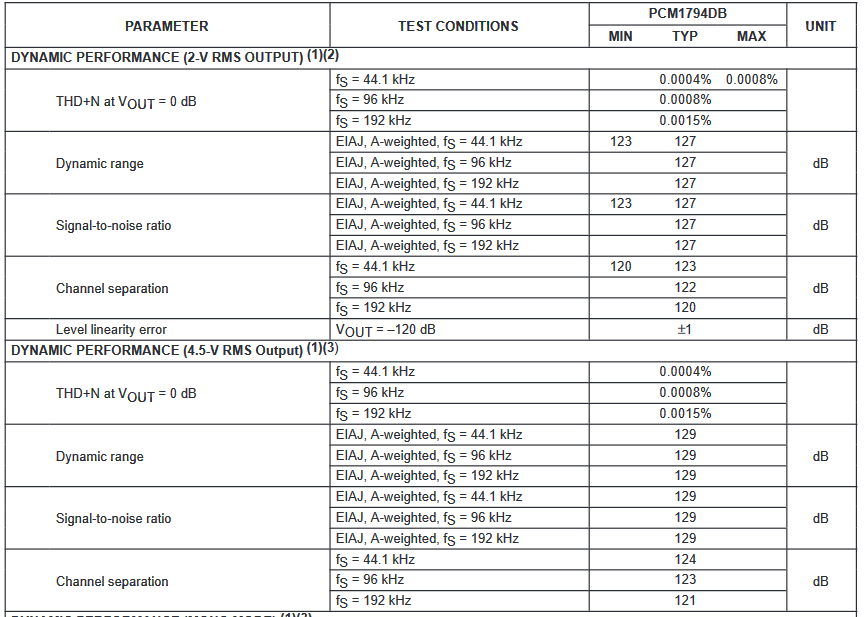

And how do you think they measured the DAC THD without a I/V ? The THD given for the DAC includes the I/V and filter stage.
All those figures attached are the figures for the DAC + I/V stage. So the I/V stage is at least as good as those figures.

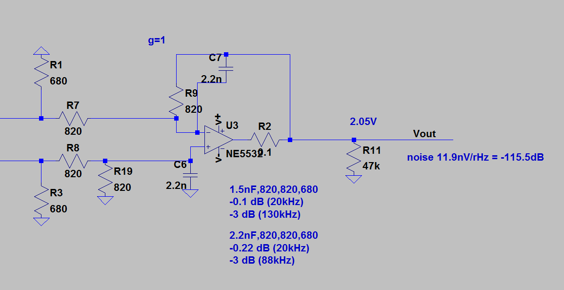

Did a few experiments. The measurement is quite good. The corner frequency is pretty outstanding. Is there a better IV stage in the market?
Freq. resp.: ±0.06 dB (20Hz..20kHz)
Corner freq.: -3 dB (40kHz), -12 dB/octave
Noise: 1.21 μV (-118.3 dB)
THD (1 kHz): 0.0003%
THD (20 kHz): 0.0004%
Out voltage: +6 dBu (1.55V)
BW: 20kHz

So what's the schematic giving you those results ? Out of curiosity, what are you using for testing?
