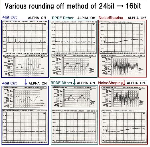

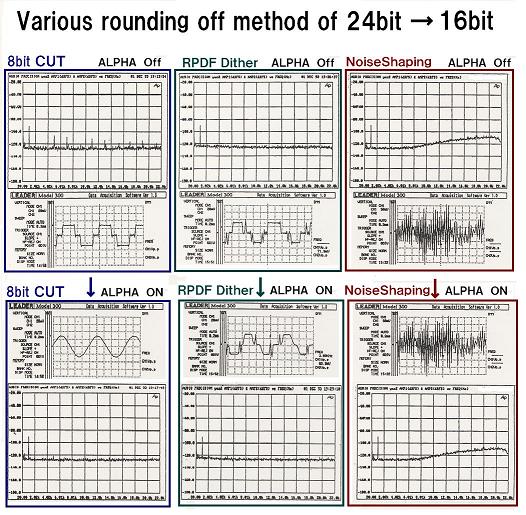

Oh! I'm sorry, 24 - 16 =�@8
I'm sorry, 24bit - 16bit = 8bit cut
This signal is showing if we edit 24bit digital data to CD's 16bit various method, how become neighborhood waveform of 1LSB /65535 steps 16bit(fs=44.1kHz).
In the figure, ALPHA off position is as same as common D/A converter unit with conventional digital filter.

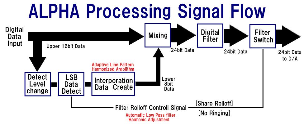

I can show you this all
This is ALPHA Processing Signal Flow, Adaptive Line Pattern Harmonized Argolithm and Automatic Low Pass filter Harmonic Adjustment.
If you create Automatic Low Pass filter Harmonic Adjustment function, please count ZERO data before rising over 2LSB.
** Adaptive Line Pattern Harmonized Argolithm is only interpolate in case of several sample points were same data, after step up 1LSB.
If over 2LSB step up, ALPHA is not moving.
