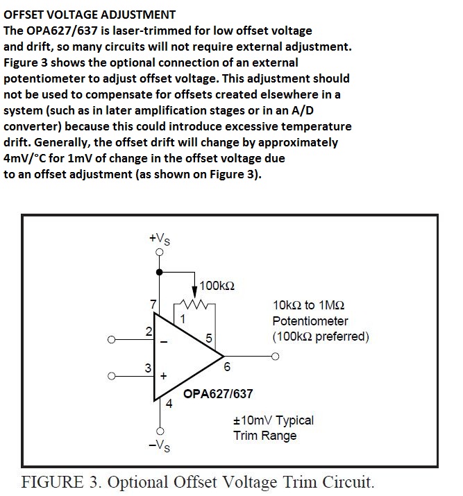

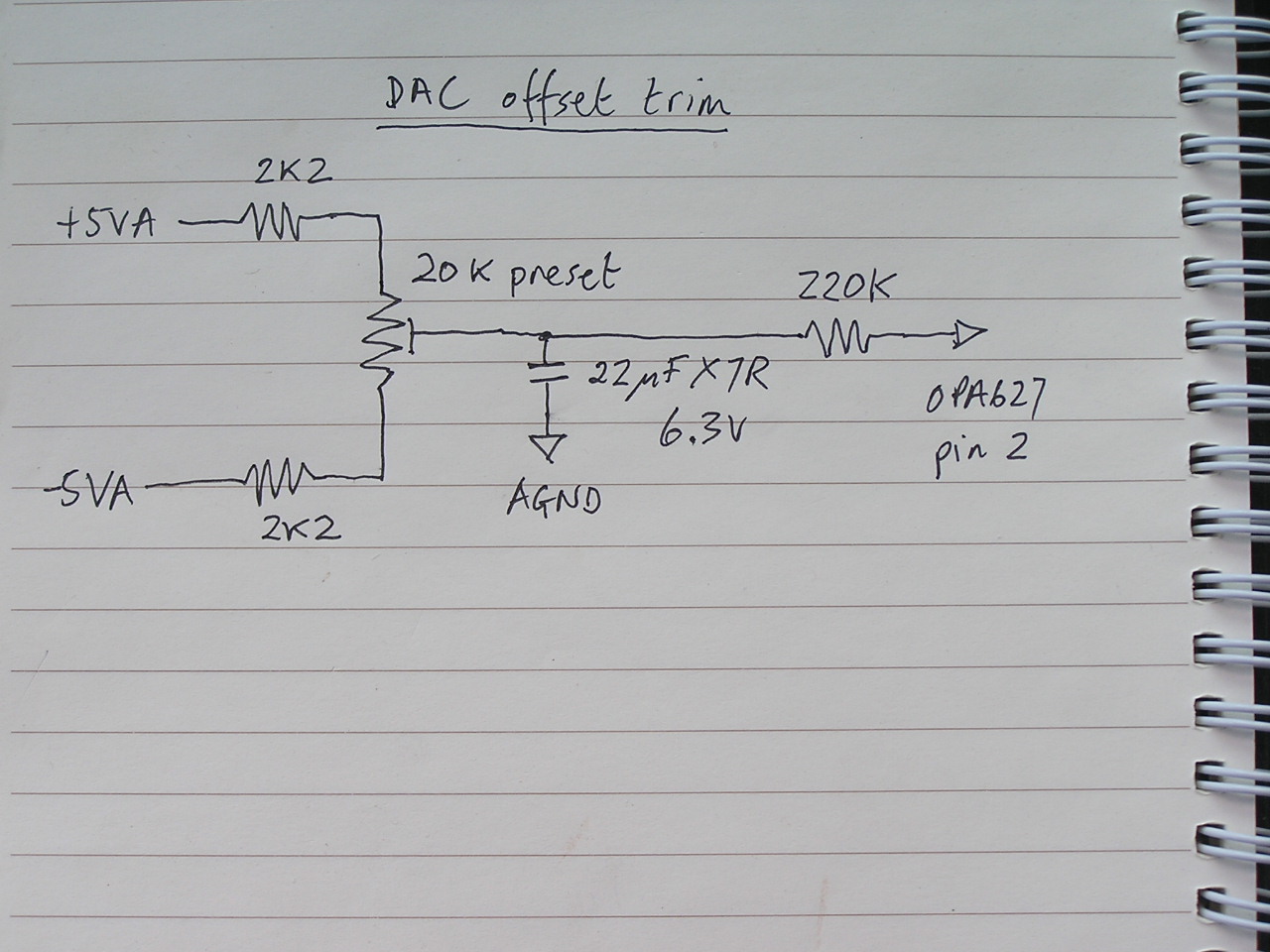

I'd bodge up a bipolar reference circuit driving a pot, or you could take the reference from the analog supplies then filter heavily with an electrolytic and X7R ceramic in parallel. A 20k pot between the analog supplies, the caps to agnd from the wiper then a 220k resistor into the inverting input of the 627 ought to work.
Could you maybe free hand draw that up and post it as I'm having trouble picturing it, in the mean time I have sent an email off to Cary again to get the schematic of the analogue stage, as this is so weird that it's something around the opa627 that be causing it.
Cheers George
Cheers George
Good thank's for clearing that up, should I get no response again from Cary, I'll give your circuit a try.
Is the 22uf 6.3v a bi-polar, it would have to be I think?

Hi abraxalito, thank you very much for the dac dc offset nulling circuit it worked a treat, instead of 17mV left and 50mV right comming out of the OPA627 I/V's, now I have +- .1mV I don't know why but the sound has improved very much overhaul esspecially in the bass. Is this possible, that the OPA627 as an I/V does not like to see any dc comming into it from the dac/s???
