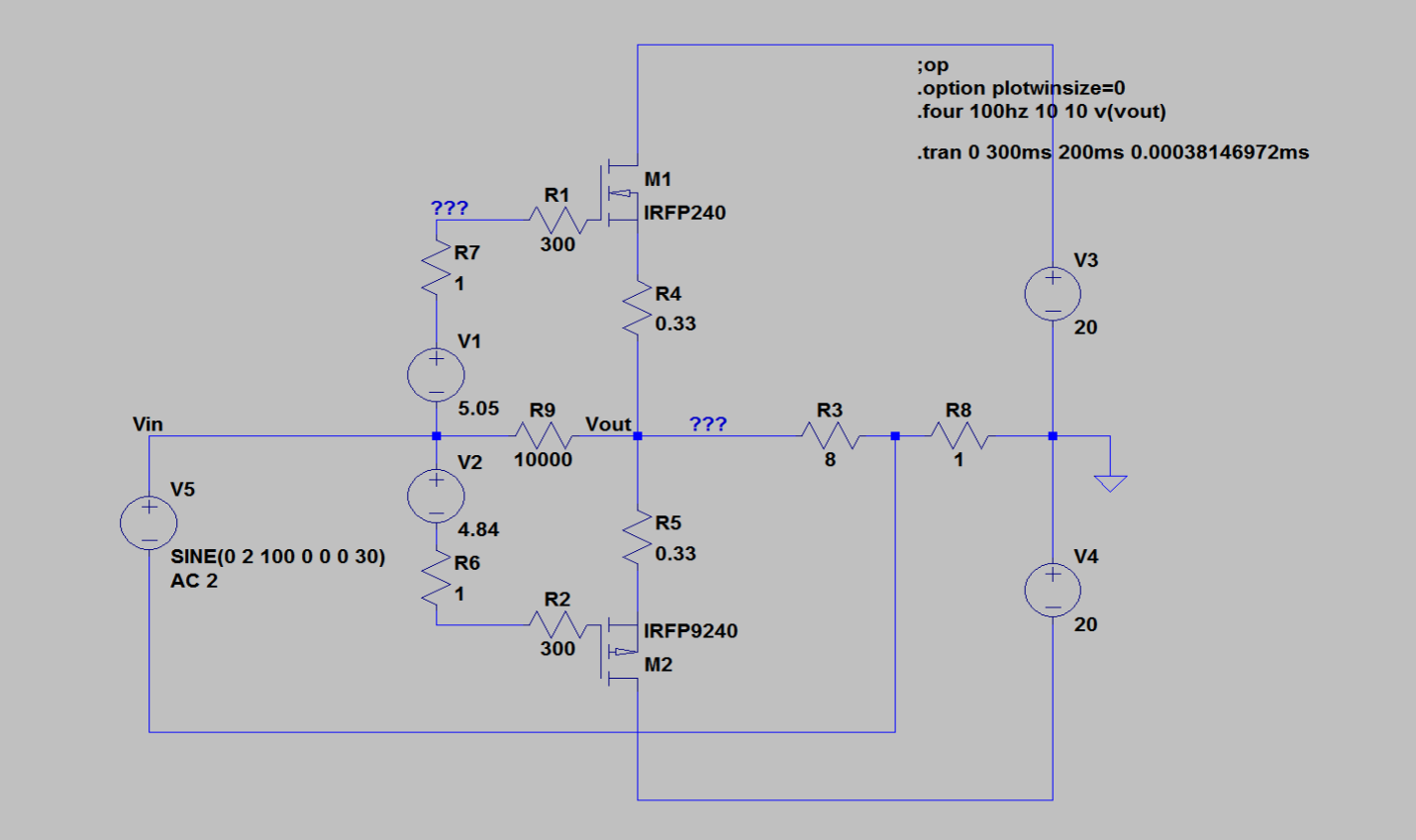

This is what I am playing with at the moment. I tested 1 ohm, 2 ohm and finally 3 ohms R-sense. Since I use a 2:1 stepdown autoformer (L1 and L2 in the schematic) the 3 ohm R-sense behaves like 1,5 ohms in a normal "OTL" source follower amp.
With 3 ohms sensing resistor the bass becomes more prominent and energetic. It is not a big change, but it is easy to hear when I remove the PCF by shorting out R-sense with a short cable and alligator clips. The amp sounds a little more sterile and "hard" with PCF.
I can't make up my mind if I prefer the amp with or without PCF in this case. It is a little bit like a tone control.
I would love to hear a F4 with some PCF. I guess a infinite damping factor or even a slight negative output impedance could make an interesting combination with some speakers which thrive with some vigorous control and muscle.
