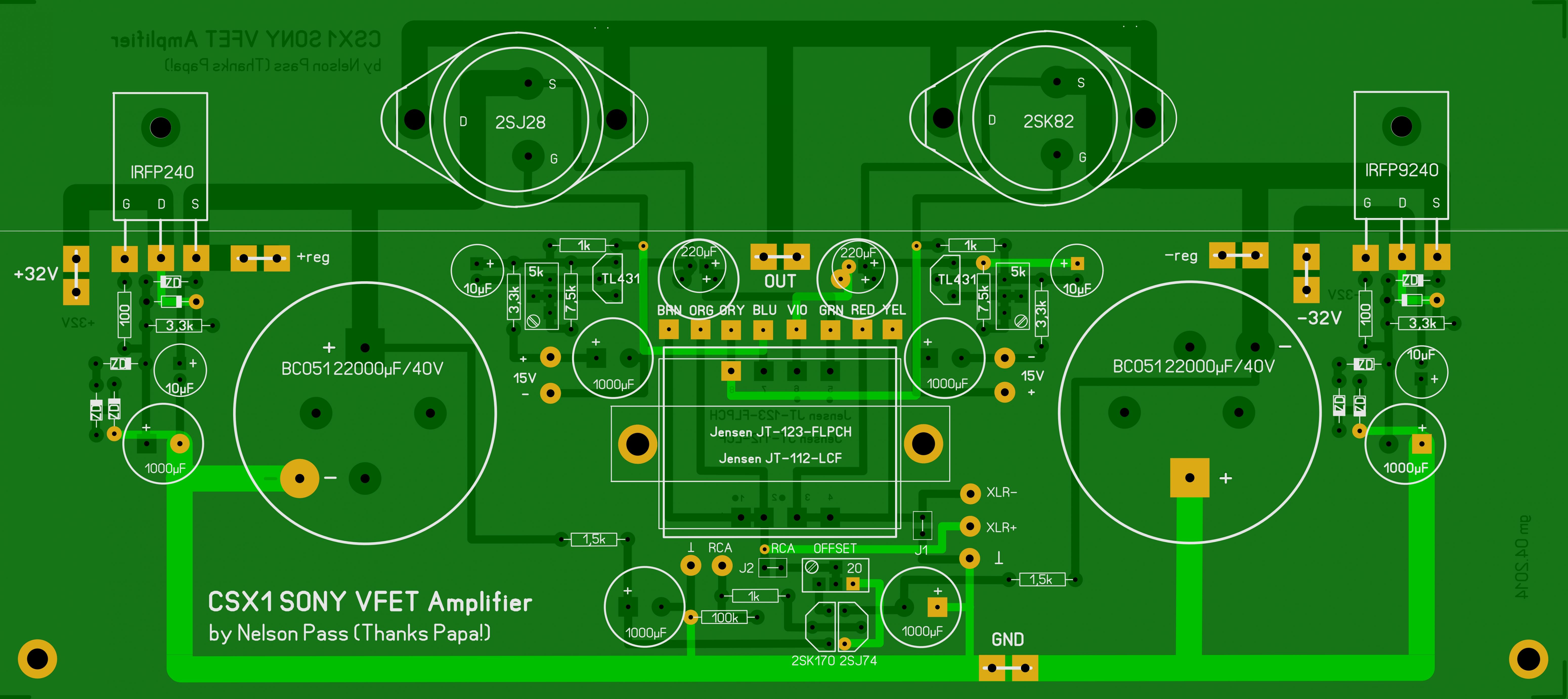

I did some minor changes. The negative input rail of the main supply (-32V) has been moved to the bottom side of the PCB. That dependably prevents any possible electrical shorting between the L profile and the supply voltage.
The rest seems to be OK so far and I’ll place the order to my board makers on next weekend.
