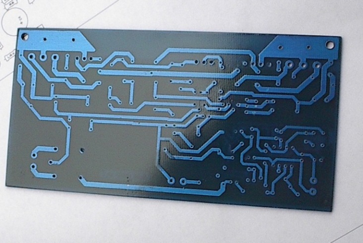

I bought a cheap Samsung Laser Printer £30 GBP. All you need is some thin inkjet photopaper and Voila. Boards for pennies.
Initial cost might seem high but once you've bought the printer you can make boards for less than £1 GBP / 0.1m^2
I only use the laser for PCBs as its far cheaper to use the inkjet for normal printing, especially if you refill the cartridges with bulk ink.

Hi marce,Why have a thick silver finish?? you cant realy solder through it.
For SMD and DIY ENIG will give best shelf life, also acceptable for PTH.
For through hole designs lead free HASL will do, and is probably the cheepest, not reccomended for SMD boards though.
OSP again for DIY avoid, limited shelf life, storage problems, same with immersion TIN and immersion silver, shelf life is limited.
Of all the finishes I use and prefer ENIG, good shelf life, good solderbility and nice flat pads for SMD.
