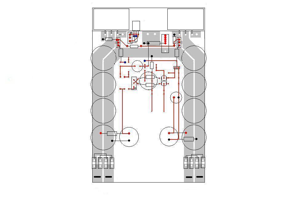

I dont know
This one has supply caps all the way from bridge to output
Maybe thats slightly different
Oh, connections from power transistors to speaker out will be solid core wire
Well, the whole thing might be hard wired, or just part of it
I should say this too, its a Dx amp

Mr Evil said:
Indeed, you want the two rails as close together as possible, to minimize loop area. However, it is a lot easier to lay out a PCB with one rail on each edge.
That example posted isn’t any good but a rail on each side can be perfectly fine - it's where the power leads terminate and where the current flows that counts. And "visual symmetry" isn't and evil either. There are a number of designs around with both symmetry and rather large “loop areas” (due to mechanical constraints) that still achieve very low distortion.
Also, laying out a class B or AB power output stage with the power supply rails overlayed is often misguided because the field of one half wave will not cancel that of the other.
Same goes for twisting supply rail wires together without the ground return.
from ....a post from user
Eva ....
the ideal pcb will have a small power and ground traces ( lengthwise ) and have this type of stracture :
from left to right ...totally left side the power things outs drivers vbe multiplier ..... in the center ,ground may be power caps ( if no more than 4) and on the totally oposite side right area the small stuff like LTP ccs VAS and goes on ...
ground plane can always be tricky
destroyes your star ground pholosofy
can create capacitance between the other layer

Eva said:
Visually symmetric layouts with rails on the sides and small signal stuff in the middle are the worst.
Yeah, thats what I have been told numerous times in relation with another design, but it works ok though, as Glen says
Though I wonder if the ground loop issues might be different, when common ground is placed at the end of power supply, close to output stage
Ex-Moderator R.I.P.
Joined 2005
That was the point
That the benefits from having supply lines and ground plane end right at the output stage holds enough benefits to override the other issues on hand
And there ought to be some benefits from having no supply wires at all, other than trafo connections
Compromises there will be anyway
Below is from Holton site
Could be an option, but seems to me like there might be other issues with bridge so close to amp curcuit
Additional noise from wire connections etc
Probably works fine though
