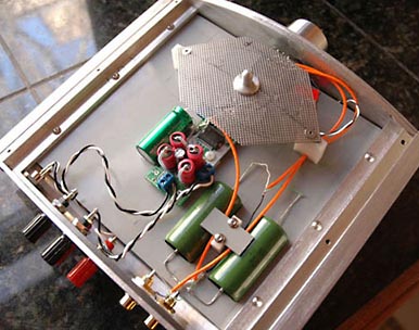

Well, here's an example with its sheet metal removed.
This is a heavily modded SI board. The gray sheet across the whole bottom is an ABS sheet. You can see one of the nylon screws holding the board down to the plastic chassis, and it's screwed into glued-on raised pads. The board is cut away behind the chip to allow some airflow. You can see little blocks used to hold up the screen that serves as ventilation. The round button in the middle of that is the on-off switch, which is set into the plastic chassis as well. The input caps are actually sunk halfway into the board.

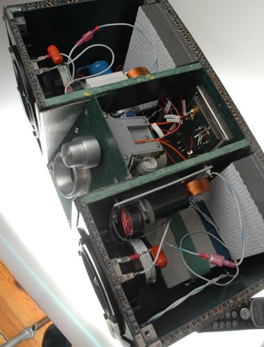

I built a boombox that has a pair of SI boards, plus the pot and all the signal caps and power distribution block built into a fairly complex glued-up subchassis. I built the thing to come apart into several pieces to allow access to various levels. It actually surrounds the tuning port on the front of the box. I'll see if I have a decent picture of that.
As an engineering aesthetic, think of the guts of a cheap consumer boombox or clock radio, and how everything kind of hangs on that one molded part. Very efficient use of space that way.
