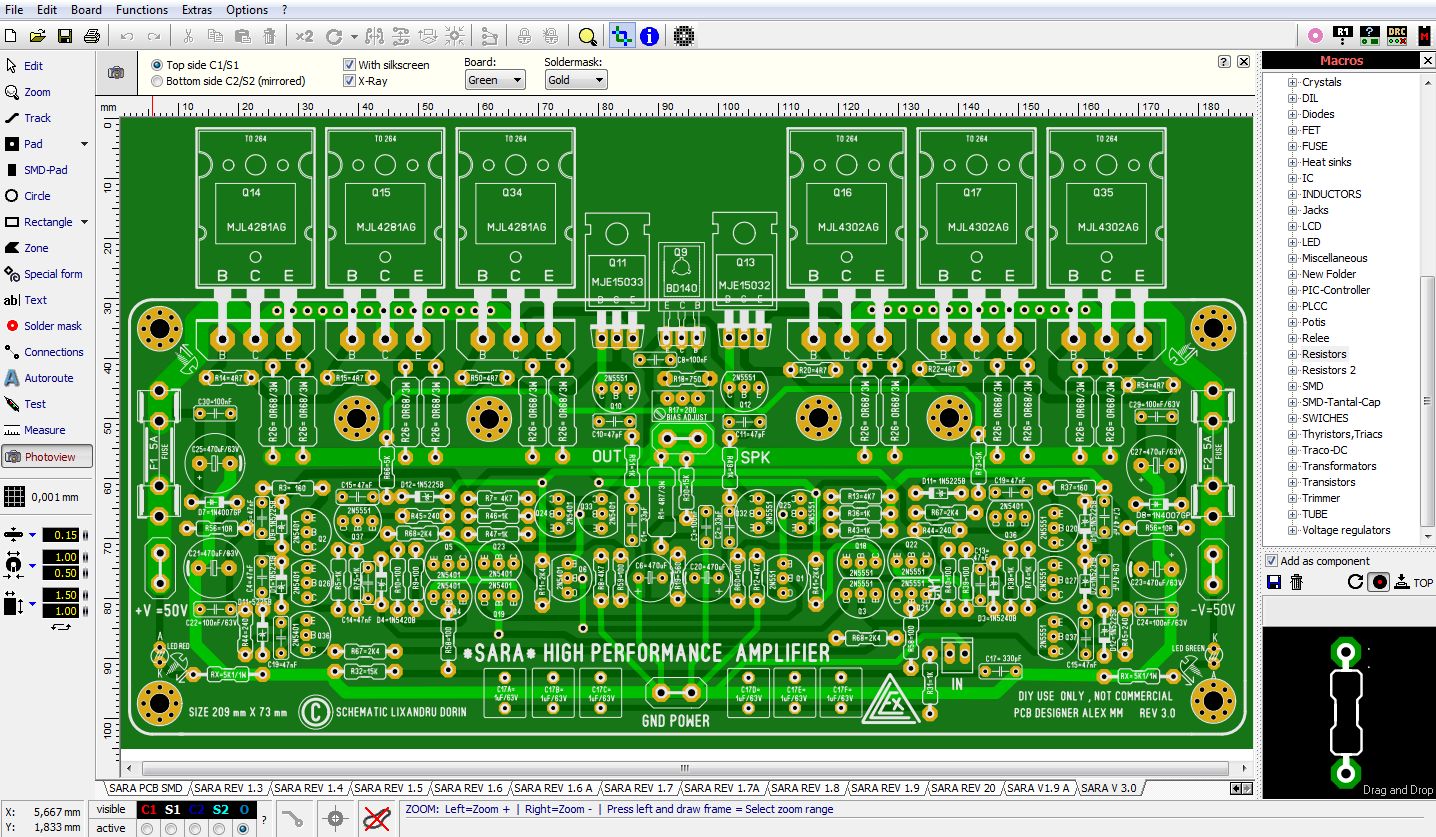

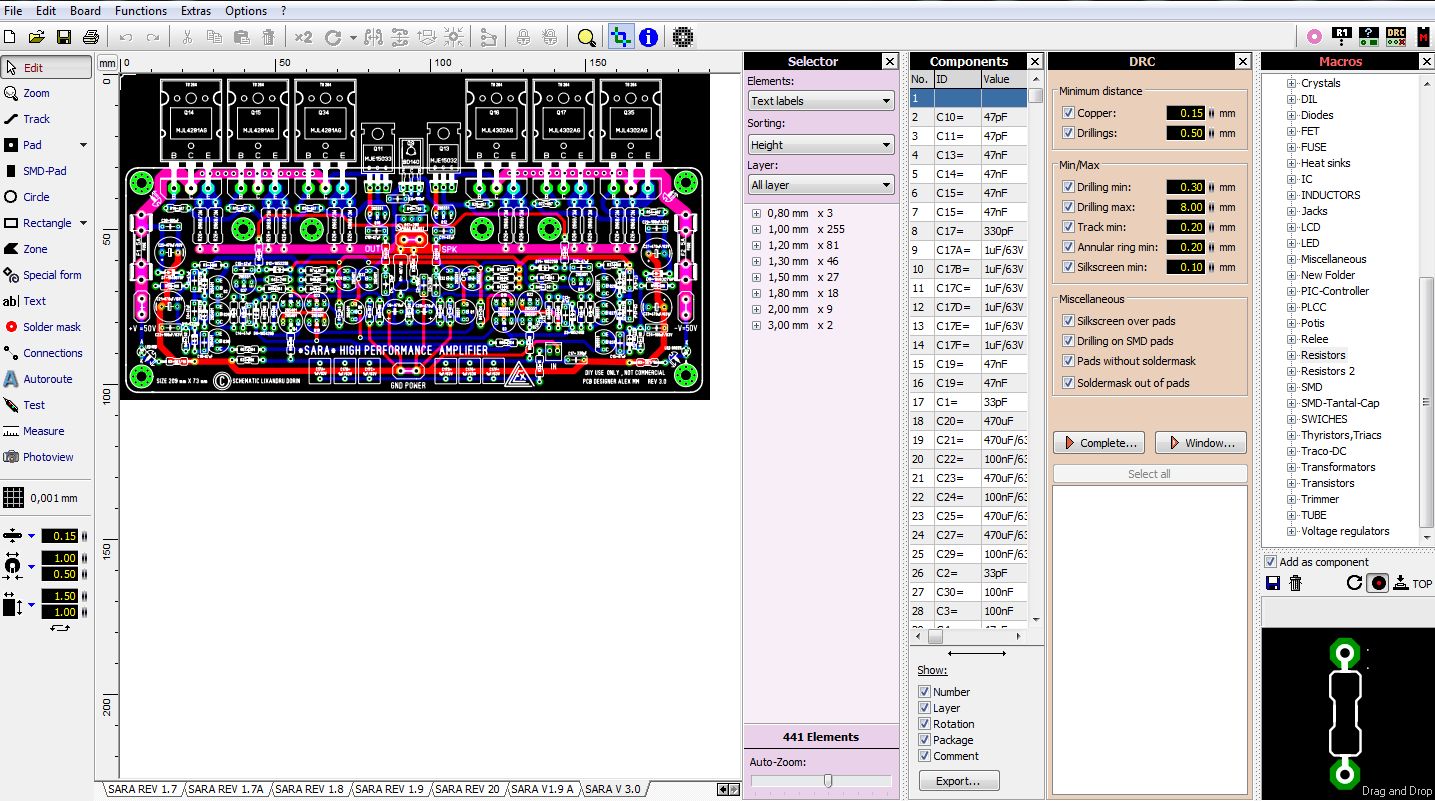

Try Sprint-Layout!
Cheap (40EUR), simple, effective. The best unprofessional PCB software on the market!

I tool a look at Sprintlayout from Abacom, but it does not seem to have net list support. Anyone know if this is the case or not?
It does not use netlists. Otherwise brilliant though, and perhaps because it does not use netlists is one of the reasons it is so easy to use.
And audio amplifiers (like RF amplifiers) are layout-driven. Working from a netlist/schematic is one of the easiest ways to get a layout with very poor EM compatibility. Which translates to more noise and distortion than your simulations would indicate. Or class D amps that blow up inexplicably. Layout-only tools actually help generate good layouts. You've just gotta be ultra careful to check everything throroughly.
