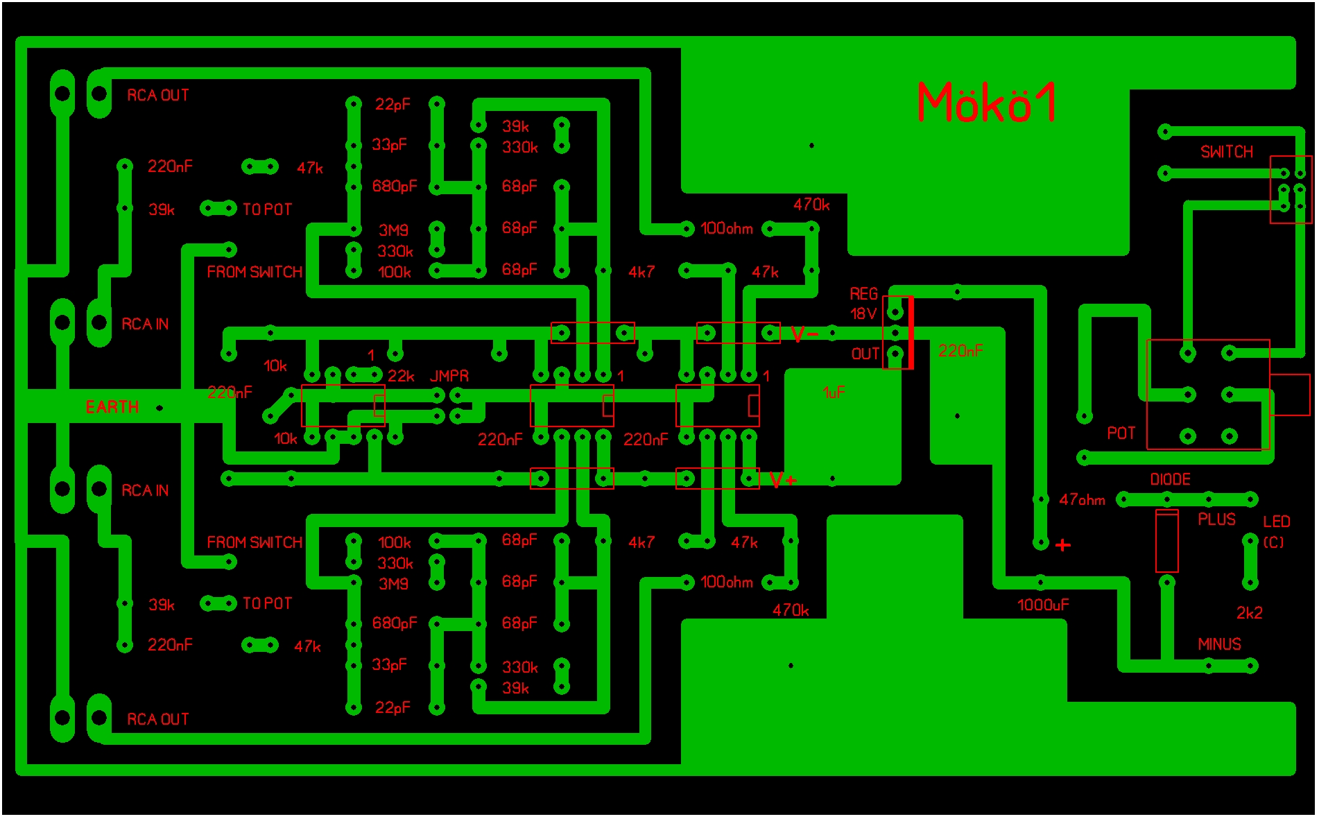

That is true. In Sprint-Layout program the pcb-outline color is white. See attachment.

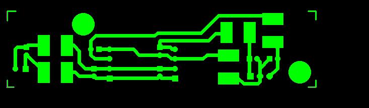

Could someone help me to identify the problem with drillings on my layout? When I create drill file in Sprint, it says 239 drillings on the silkscreen layer and they will be ignored. As a result, exported drill file have all drillings in one corner of PCB.
Also, how to save in Gerber files cut out area in ground plane? In Sprint the layout is fine with applied cutouts, in gerber all cutouts disappeared.
