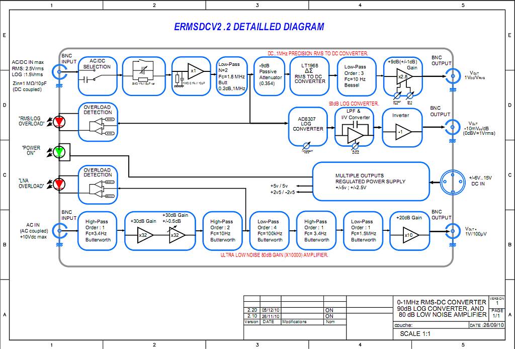

I add a little note about this design.
I have designed a prototype of this design using new ICs (LT1968) and the log converter (AD8307) has been added externally with my preferred "on the fly" design way..
When i've drawn the final schematic and the PCB, i've took great care to do it in "the art rules" to avoid any issues.
