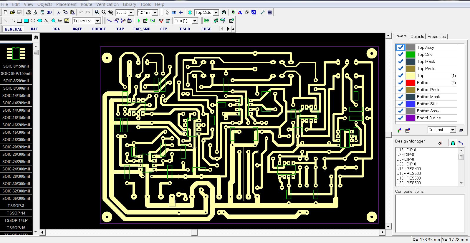

my personal opinons:
i like diptrace. if you want schematic capture and pcb layout integrated together in a single package, it's worth spending a little time to understand why diptrace isn't working for you. it's easy to use and you get a lot for the money (or use the free version).
if you just want to do layouts, it's hard to do worse than sprint layout. i would use this much more if didn't care about integrated schematic capture.
many people use Eagle. I've tried it but determined after several evaluations that "Eagle's user interface does not align with my intuitional expectations." Is that diplomatic enough?
I've used Altium, P-CAD, Mentor Graphics, PADs in my day jobs. For my home projects, i like to apply KISS. :D
