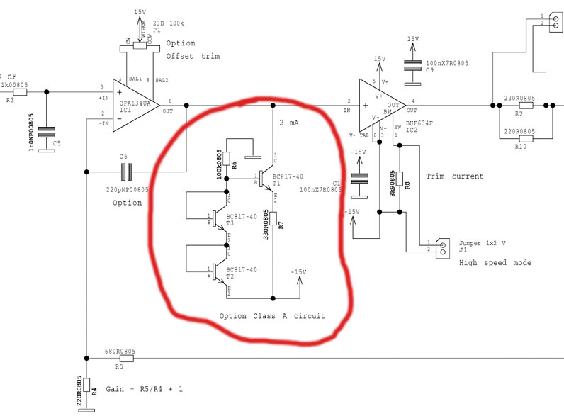

More gain?
Per,
I think I did overlook something. R10 and R12 is a voltage divider, right? Omitting R12 will give me more gain at a factor of. 0.5? If this is right I will have plenty of gain.
PS: I'm comparing my new built preamp with my old NAD preamp. In this a and B test I can hear that the commercial preamp has more gain. I just want to reach the same level.
Per,

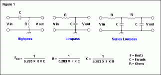

Yes, the first two but not the last. It's a little bit more complicated but you can approximate if the last link has at least 10 times higher impedance than the first. If you want a second order filter it's better you use an active filter, maybe from Walter Jung's excellent books!jazzpeter65 said:I'm trying to calculate the lowpass-filter at the input.
Is this the way to do it?

Re: More gain?
Most signal sources have around 300-1000 mV out and that's is almost sufficient for full output power, meaning you need gain of 2-5 in normal cases.
Maybe so but you need only gain for full power. More than that gives you only noise and hum.jazzpeter65 said:I'm comparing my new built preamp with my old NAD preamp. In this a and B test I can hear that the commercial preamp has more gain. I just want to reach the same level.

Pavel,
This is funny.....
I really like the sound that you "don't like"!!.........it makes me laugh....
I just cut the 51 ohm at output going to ground and put some music on to check.
Sound is much better. It's tighter and more present. Bass is incredible, rock solid. Also the midtones seem in balance.
Maybe it's the added gain that puzzles me, I don't know, but I'm happy.
BTW: After this mod I got all the gain I will ever need. IT'S VEEEERY LOUD NOW!! I better turn it down before I have my neighbours at the phone...
Thanx for the tip!
