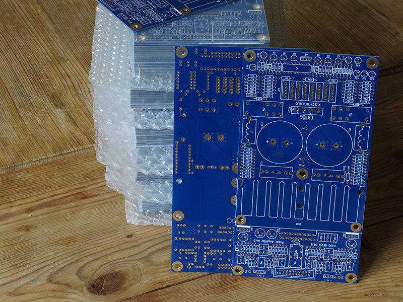

Can i order two "blue" PA03? I Signed wiki as CestmirD.
Regards
CestmirD
@CestmirD, yes. A Paypal invoice is already sent.

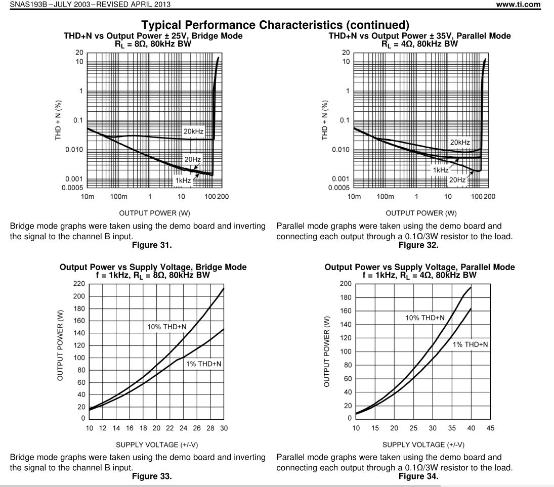

Theoretically yes, but I think in real life, around 100W total output will be maximum. The 2x60W in 8ohm is using 35V power supply, and 0,5% THD - so on the ragged edge you might say..
PerAnders recommends using 33V DC (24VAC x 1,41 and rounded off) as maximum to avoid excessive heat dissipation from LM4780.
Also I get the impression from TI datasheet, that even 33V is too much if bridging. See attached excerpt from page 14. As I read it, if you want to bridge, it is best to stay around 25V (unless your speakers are very high impedance, like 10-16 ohm), and for parallel use around 33V (and max 35V) is ideal.
So it would be best to decide the mode of operation before buying transformer. And the deciding factor here, is the loudspeaker impedance curve: If it is 8 ohm or higher (without significant dips) bridging can work well, but else parallel configuration is better. If you want to keep all options open, use 25-26V PS. All in my humble opinion, and more experienced people may know better.
