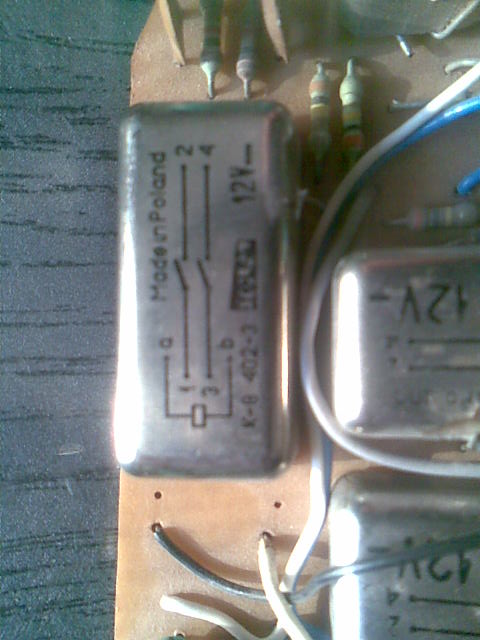

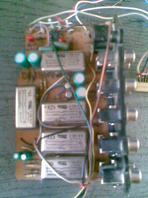

If You wanna patent this - there is my "prior art" . I built this more than 10 years ago. As relays switch I used mechanical switches, but SAS580/590 can also be used (if still avaiable, datasheet is on datasheet4u.com), so it can work like Yours. Beside input switches there are two buffers. One with op-amp for amplifier, and one with these two metal-case transistors (emiter follower) for tape output. Schematic is in my head, but there is nothing more than written above - just input switch and two buffers.
P.S. sorry for photo quality - it is the best than I can get with my cell phone.

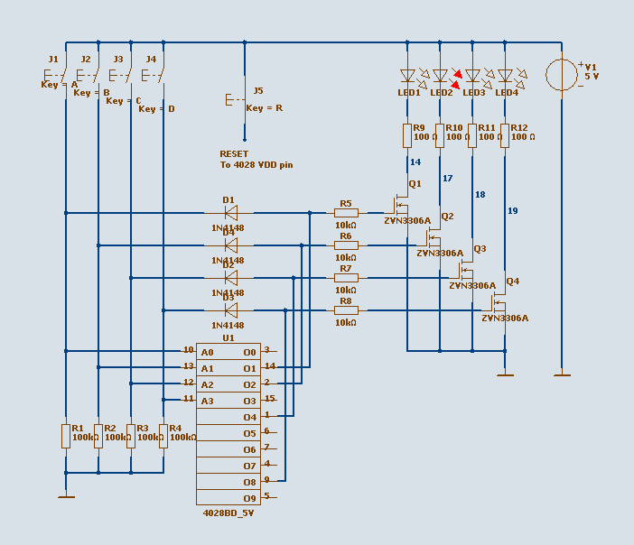

4 Channel relay controller, for 5 Volt audio relay
This is one usual way
to make simple 4 channel audio relay controller.
Uses one CMOS 4028 BCD to 1 of 10 decoder.
In this circuit i have uses LED+100 Ohm in place of 5 Volt relay coils.
Not much to explain.
a) Each time we press one push button ( J1 - J4 ) the other 3 are set to zero.
There can only be NONE or ONE channel active (high output from CMOS pin)
b) At power on no relay is activate.
c) I have added one RESET button.
This is attached to VDD, power supply pin of 4028.
Lineup

* 5 Volt 3pin regulator
* 4028 logic IC (low price)
* 4 + 4 100k/10k resistors
* 4 push buttons, NO (normal off)
* 1 push button, NC (normal closed)
* 4 transistors (mosfet or bipolar)
* 4 relays for 5 Volt DC
*Note:
You can use 12 Volt DC relays.
In this case you need one 12 VDC regulator, too
To supply relays and the open collector of those 4 transistors
This circuit is a standard solution.
I have seen such applications a number of times.
My simulation (see attachment in prev post) was setup from my memory,
and worked well right 'out of the box'
Simple. With One little restriction:
Max four (4) audio channels can be used.
In order to add more than 4 channels,
we can complicate things and make a chain of two 4028 CMOS
and add some reset triggering function between those.
This would give 8 Audio input channels.
But not often we need more than 4 audio inputs.
In some normal preamplifier or Audio Switch Box
Lineup

SAS580/590 are simple analog circuits - no oscillators, no software (read dataheet). These was used on old TV receivers to switch memory. It work's like circuit posted by lineup. These chips also don't require switches - they are driven by touch.
Adn about my op-amp buffer and tape output - these are extensions
