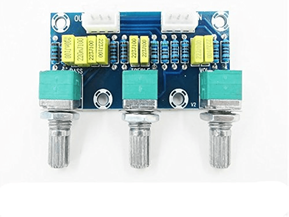

passive tone control (flat response potentiometer position)
This module is easily availabe to me. Its passive tone control with volume, Bass and treble. Wanted to ask. What would be easy way to know flat (Original signal with no equalization to bass and treble frequency) response position of the controls ?
Reactions: 1 user
Use REW software (free download) to measure the frequency response. This will also let you see the effect of the controls as well as where the flat positions are.
I use a low cost PC audio interface (Behringer UAC222) but a PC or laptop's sound card would do.
