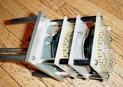

I also think that L Pad is more prefferable choice, yet when looking at Connoisseur production photos (below), it seems like their attenuator is of a series type using 39 resistors (although, I might be wrong here). Because of both surface mount and naked type, they probably less intrusive sonically, even when so many are in series. I would be interested in Jonathan's comments on choices made here.
My approach to preamp is that when you don't need it, don't use it. This narrows my selection to only one source component, but this is what I mostly listen to, so why make sacrifices by complicating signal path with switches and additional wiring and jacks?
I'm using CD source and separate DAC with a volume built in at the output. It consists of a fixed series resistor (50 ohm Vishay) and variable switch with 24 resistors selection to ground. Some may think that it's not enough, but for my needs it's more than enough. I'm mostly using selection between 15 and 20th position. The switch is based on Elma and I like it because of a small size. Initially I had some pops but after spraying contacts, they are fine. Resistors are variable between 0.5 - 500 ohm and the output resistance is usually 100 ohm.

Don't be too hasty in thinking that Jonathan's attenuator is a 'series' job, merely from the picture.
I hope Jonathan will share some more of his valuable comments with us, but, in the meantime, I don't know if you are aware of it but a 'true' 'L' pad (impedance matched) should switch a different shunt resistor *and* a different series resistor into the circuit at each stage. This is needed to preserve the same input and output resistances seen by the cables and the surrounding components (i.e. source and amp) to suit their output and input impedances.
Most, (including mine!) don't because of the doubling of the already high cost, and the poor availability of good-sounding resistors in the required values.
In normal positions of rotation, the use of only one 'fixed' series resistor is a reasonable compromise, but, as I kept on telling Rarkov, such things are still a compromise, nevertheless, and the input and output impedances of the passive will vary according to rotation etc., which can have bad effects on the surrounding gear.
Somehow, I cannot see Jonathan going for any such compromise, and it is my guess that he uses the full 'L' pad arrangement, but this is only a guess and we will have to wait and see if he kindly replies to us.
Edit: Incidentally, that picture you show looks to me like a Shallco, alright, and they are superb switches from the sonic aspect!

It may be true that having a fixed series resistor and changing only shunt resistor's value is a compromise, but to me the impedance change between let's say 60 ohm and 250 ohm (this is what I'm mostly using) is much less compromise then having a switch in a signal path and a longer path as well. Please correct me if I'm wrong.

As I said, I am quite content with the same kind of arrangement as you, and if it wasn't for the impedance matching with surrounding gear, there would be no issue here, so it will (to some extent) depend on the parameters of what you use. Again, this was why it was impossible to give Rarkov any definitive advice over this.
You do really need to know the various impedances involved, to ensure proper and adequate signal transfer.
I only mentioned my thoughts on Jonathan's setup (and I could still be wrong, here!) bearing in mind that it is possible at extra cost and complication, to avoid this particular compromise, and I don't see Jonathan doing much in the way of unnecessary compromising, if I am any judge!
I hope he will tell us.
