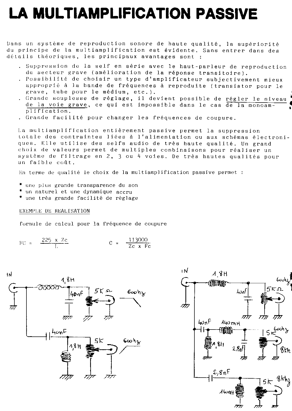

passive bi amping french style
Hello,
I would like to use a 12db passive filter between pre amp and power supply. The pre amp is tube based with a tango output transformer giving a 150 ohm output impedance. Above 600 hertz there will be a tube power amp which will have a 470Kohm input impedance so probably no problem there.
In my other set up i did start using a Virtue sensation tripath based integrated amp, recently did switch to a battery power supply with 40AH batteries.
Turning up the volumecontrol will turn it into a power amp with 50K ohm input input impedance. There used to be one with a Gary Dodd tube buffer which will give it a 100K ohm value.
There is a new Virtue out there but it will have 15 or 18K ohm input impedance depending on if you jumper out the pot.
There is a set of Ice block amps available which has the tube buffer built in. BUT it has an absolute overkill on power to use on my altec 104db system.
Maybe i could raise the input impedance on the new model using a cinemag ( which one? ) transformer. Loosing some power there is okay I will probably go for battery power on the new virtue amp if i decide to go for that one.
Not sure if they will match well with my voice of the theatre with 16ohm woofers instead of the usual 8 ohm ones. They dont need power but still can be difficult to drive well. Usual tube amps will do well.
Any thoughts are welcome to make my choice easier.
Sincere greetings, edward
P.s i can have the new virtue boards without a case so i can just built a big chassis containing the batteries, the filter for the lower frequencies ( or better to place it in the preamp?)

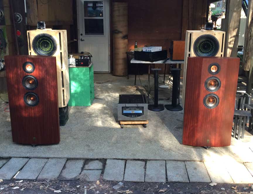

We have even taken this to the point of taking a 4-channel Sure Class D amp and building switchable PLLXO into the box (can be seen sitting on the corner of the green stand). That experiment showed its weakness in the Class-D amps ability to do the top — it got clobbered by a couple other amps brought to diyFEST.

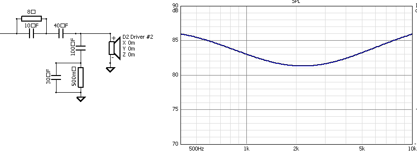

You can achieve any crossover slope and/or equalisation with a passive circuit using reistors and capacitors. A full crossover can get complex without the help of a circuit simulator. It needs to fit appropriately between the driving and driven impedances and will represent a loss in level, so noise and gain need to be considered.
If you understand your amp there is more than one place you can apply such a filter so you can break it up into pieces. Practically speaking, the PLLXO is well suited to simple portions of a crossover so you could dispense with just a part of your passive speaker level crossover and try to get most of the benefits along the way.

Passive Line Level is usually somewhat unique in that it runs at a higher impedance making chokes larger, and more susceptible to Cw so either more challenging to build or less available. Of course if you can get (or repurpose) them then you should. At any rate at least the source and loads are usually resistive and are surrounded by gain.
So if you find yourself up against using only capacitors and resistors you have to get creative. Here's an example, getting sharper curves is possible too if you can work at it. Don't be afraid to trade off a little gain in the process and optimise it back later.
P.S. in a real PLLXO the load will not be a speaker, it will be a resistance. I just happened to use a speaker simulator to make my point ;)
