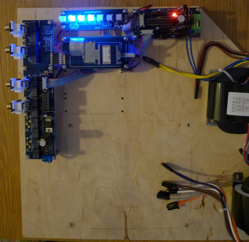

This weekend i had finish my "breadboard"
Looks good & a lot of fun
