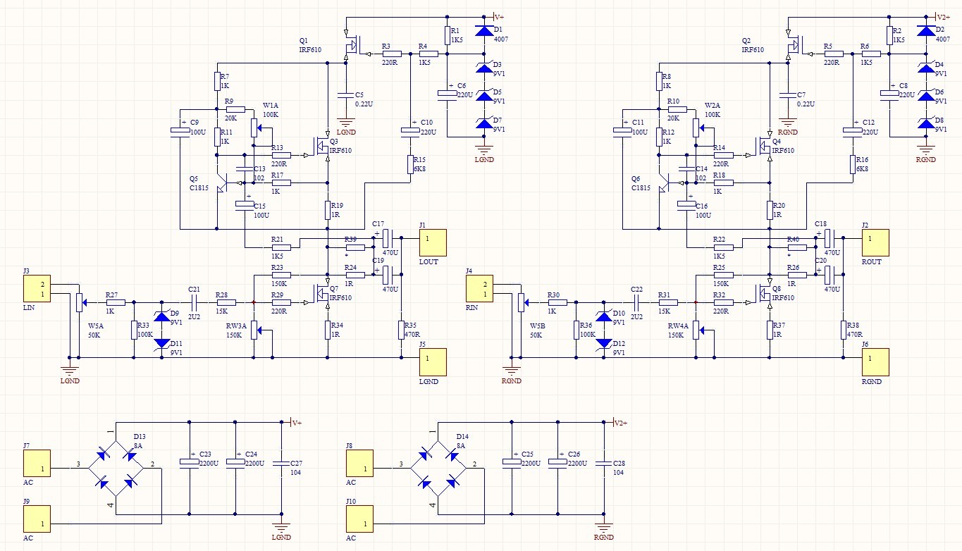

Here the schematic, ordered from there:

My build went pretty smooth and the amp works. BUT:
I do have hum :(
The Transformer is about 20 cm away from the amp sitting on my desk, as I am still waiting for the case...
Connecting the case to signal ground didnt make any difference.
Any help is apprechiated :)
more info
I have the same amount of hum with inputs not connected and volume turned down completely. I dont measure any DC on outputs, and it doesnt make a difference either, if I shorten the inputs…
Hmmm, do I have to connect the input grounds on the PCB with a wire? As the PSU caps and the the rectifier are on the PCB...
