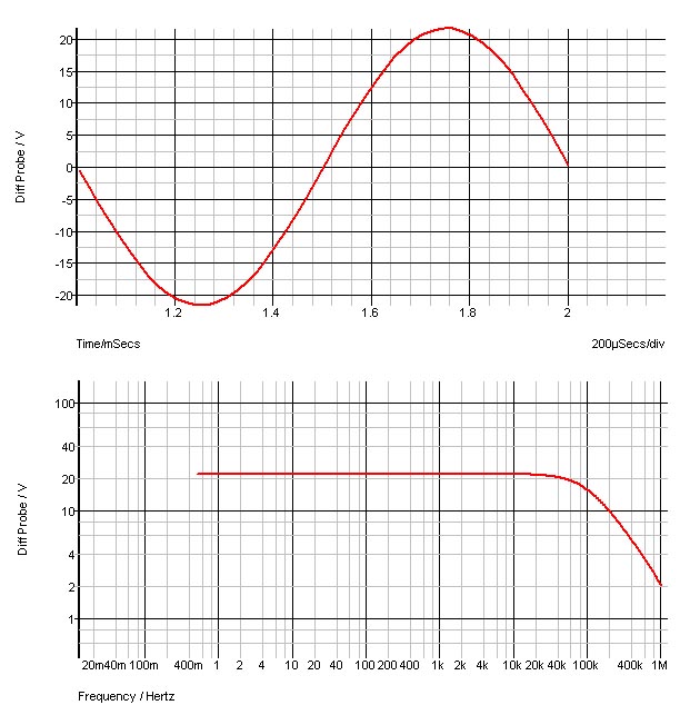

Here is some graphs:

Some more questions about choke loaded SOZ:
-Should I use the inductors instead of the all power resistors from 1 to 6 or only of the 1-2? (numbers are from the original article )
-Need I make the 1 H inductor resistance as low as possible or it is not important.
-Should I use torroid core inductor? I read somewhere that it will not or not so much saturate when the magnetic field gets strong like the classic Iron core inductors. So I would get very low resistance ca.2 Ohm. If I would use an 1H air core, than I would get with 16 gauge wire 5.2 Ohm or with 18 gauge 7.6 Ohm, but both can handle over 300W and I would get the "super inductive power resistor" with much heat like in the original circuit.
-How can I calculate the bias and the needed PSU ratings, heat sinking?
Tyimo,
The inductors would replace the Drain resistors only. You'd still need resistors (or current sources) under the MOSFET Sources.
The DC resistance of an inductor should be as low as possible. There's no benefit to be gained from higher DC resistance...okay, maybe the output power would be slightly higher, but not enough to matter. In all other ways, low resistance is good.
The best core is no core. Think in terms of air coil inductors. Any inductor with a ferromagnetic core can saturate. Your job is to keep that from happening. Air doesn't saturate.
Nelson provided graphs for the heat, power, etc. in the SOZ article. Be forewarned, the circuit's a power hog. People were all the time running up against the need for huge heatsinks, etc. and wanting to know if there were ways around the problems. That's why I started this thread--to supply a few ideas as to how to make the SOZ a little more practical.
