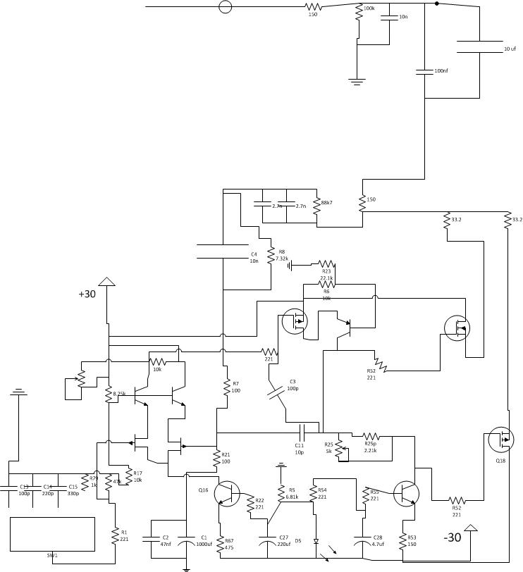

I appreciate the help! I'm getting .344v across r27 and r28. I'm currently comparing my working channel against my broken one. So far the largest discrepency I've found is Q3.

Edit: I traced the circuit out by hand and drew it up in Visio.

So let's see -
(in the following I assume 30V rails, depending on your exact rails voltages might be slightly different)
Good - the push pull mosfets are correctly biased then. Is that only for the good channel?
27V at Q3-gate sounds ok (~1mA trough R4 as it should be).
27V at Q3-drain is too small; check that you get about 20.6V at R23/R6; if you get that value, check/replace the cascode transistor Q6.
Actually all these values of the good channel do not make any sense; for example source of Q3 cannot be at +0.4V as it should be connected to +30V.
Sounds ok! (Your rails are only a little low, 26.7 V instead of 30V and it seems you have about 1.5V dc offset).
That's really strange, seems your biasing arrangement (Q17,Q6,Q3) is messed up. You need to investigate there first.
Hannes
Q3.
Did you really measure 4V at G3-gate? Sounds more like you measured across R4.Q3.

I'm getting 27v at the junction of r23 and r6 on the bad channel. 19.1v on the good channel. 10 volts across R4 on the bad channel, 3.3v on the good.
We're getting somewhere - there is no current through R6.
Either the ground connection of R23 is loose or R23 is open. With 27V at this position, the cascode Q6 does not work, leaving Q3 infunctional.
All current goes through the left (input) half of Q5; but fix first above problem with the voltage divider.

I'm measuring a .7v drop across R6 and a 27.1 drop across r23. I double checked the grounding and it looks okay, so I'll pull the resistors out and make sure they're both operable
Seems Q6 is conducting and the little drop across R6 you see here is due to the 0.07mA base current of Q6 which sounds reasonable if Q6 has a beta of 100 or so. That's a little low, are you using 2SA991 or something else?
Check R23!

It's definitely a BC560. I pulled R23 out of the circuit and it measures 22.1k. This is what I'm reading on Q6:
You are aware that the BC560 has a different pinout than the original 2SA991?
Good channel behaves exactly as it should be, bad channel not yet
The problem with the bad channel is that only half of the differential pair Q5 is conducting, so Q3 is fully turned on and likely pushes too much current through R25/R25P.
Did you followed one of my previous posts and checked in the meantime the pot R25P and wether it influences this?
