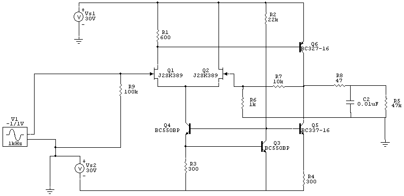

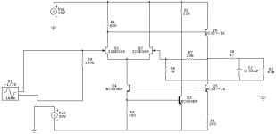

has anybody built the discrete single ended Class a gain stages?
I would like ot use this circuit as an opamp. How much would the resistors be?
The current source would be 100 Ohm for 6ma bias in the input pair. I guess that would be at least 200 ohm for the output stage.
The resistor to +Vcc would be around 4-5 Kohm so there is a dc of around 1/2 +Vcc when Vcc is 30 Volts. There is also one more resistor which I think sets the gain. What would this resistor be?
Is the real circuit more complex or so simple?
I've built similar circuits with stuff I've got on hand (mostly Motorola and Fairchild) with excellent results. Currently, Nelson is prone to using the Zetex parts for bipolars, so it's very likely that you're looking at 450s and 550s there. The dual JFET will be the 2SK389. The front end bias will be something on the order of 5 mA, plus or minus a few. The output and its associated current source will most likely be a bit higher, perhaps as much as 10 mA. The resistor values will pretty much fall into place once you select rail voltages. Shoot for 15-30V, looking to keep the voltage across the '389 around 15V. Though most op amps have truly scary amounts of gain, Nelson's circuit is going to be quite low in that regard. You'll need to decide how much gain you need for your system before you start assigning R values for the front end load. I'd say that it's likely that most of the gain is coming from the output stage (in Nelson's circuit--you may want more), hence indicating fairly low values for the JFET load resistors.
Grey
Grey
well for the input pair it can only be 2SK389.
the either resistor I refered to is not for gain but connect the +Vcc to the bases of the 2 current sources I think so the third transitor can turn on. How much would this resitor be? I guess so much as so the voltage across this transistor is 1,2 Volts with a bias of 3ma. 60-1,2 = 58,8 Volts. 58,8/3ma =20 Kohm.
