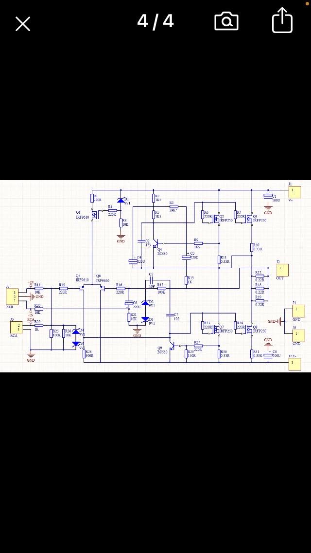

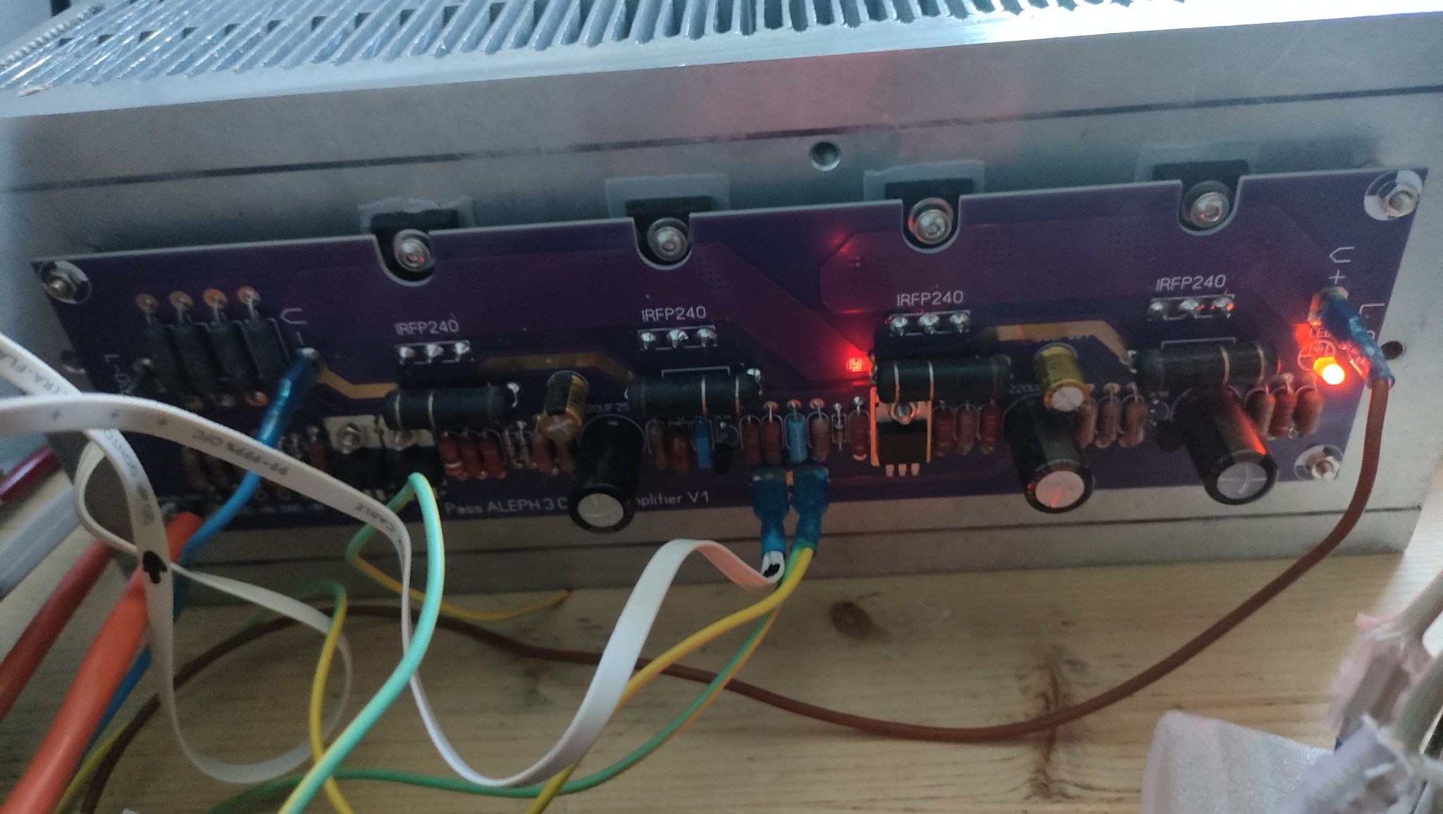

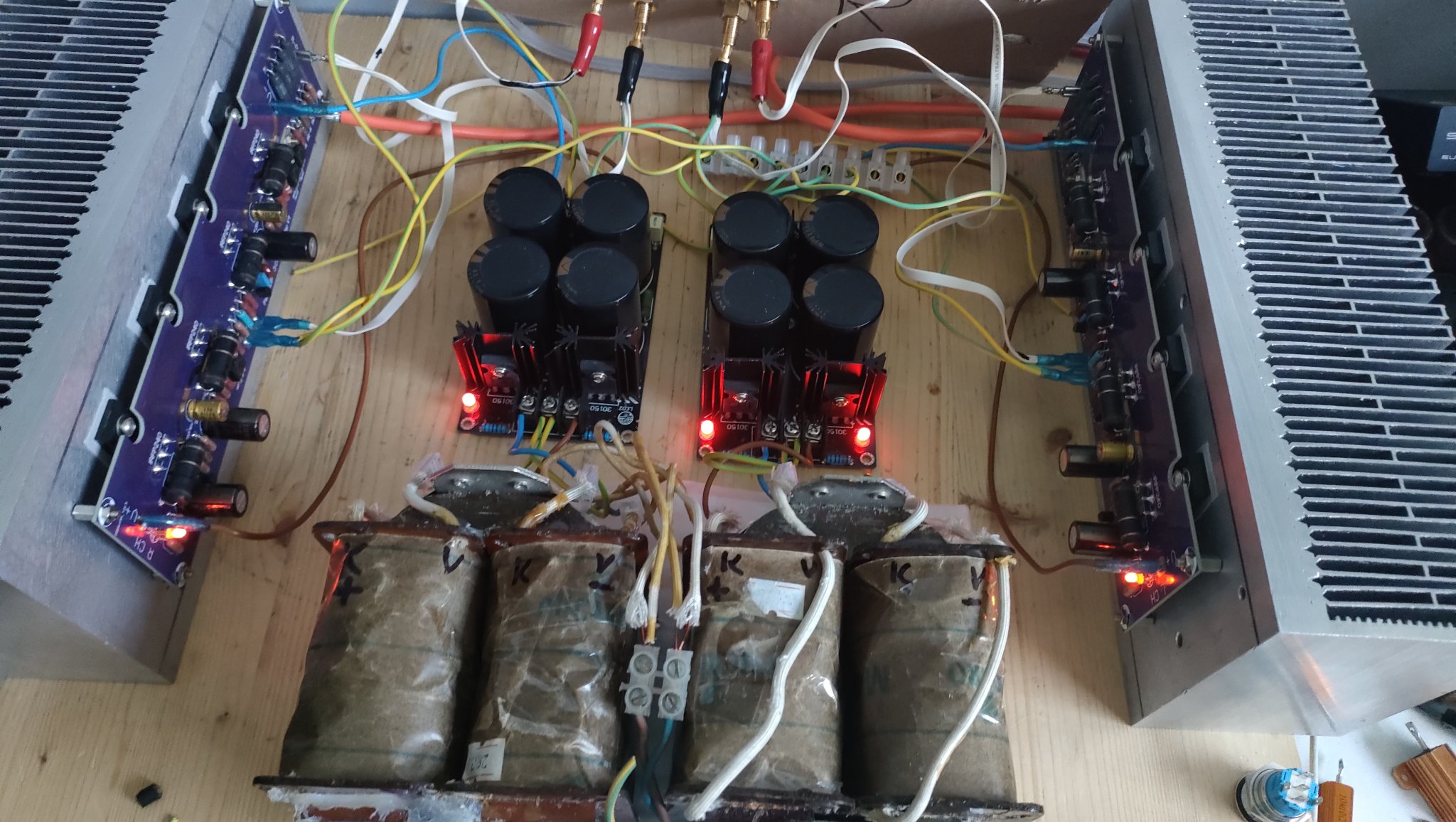

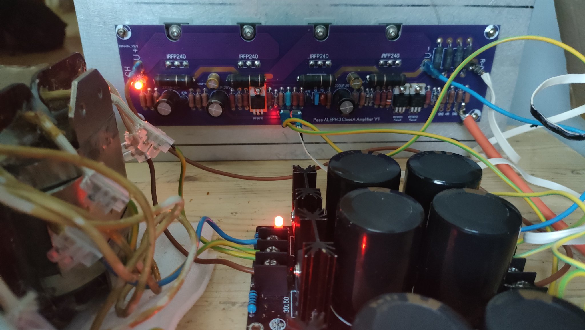

Me and my father built a Pass Labs aleph 3 amp and the problem is that when we turn the volume up on the preamp, at the bass it distors a bit.
The question is what can we do with it

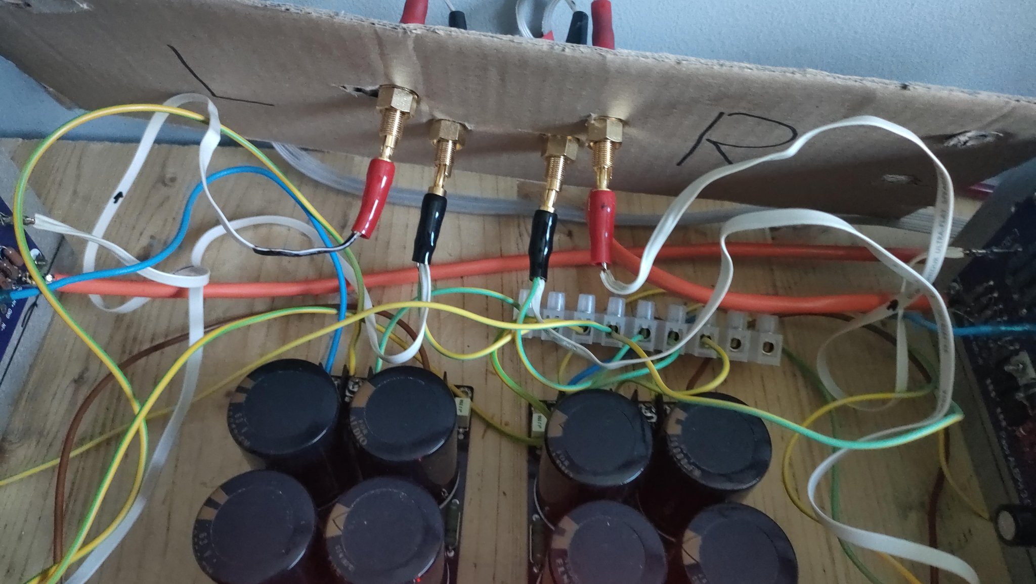

I atached some pictures of the amp if the problem is with the cables

We must have the correct schematic to go any further. There are many different schematics of each Pass amp.

You really need to find the schematics that you used.
It was in 0.48v and 0.57v
This is the only schematic that i can find

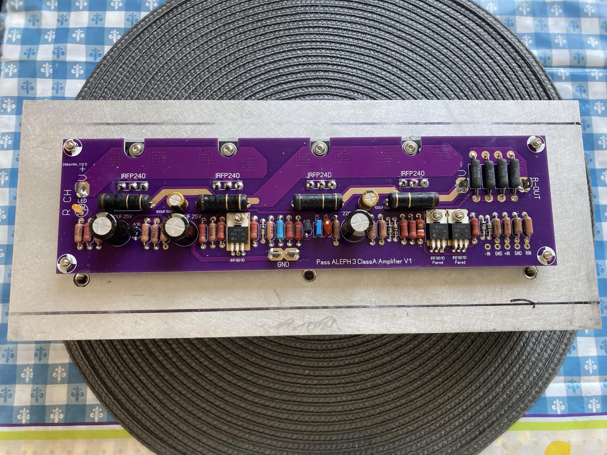

And this is the board that i used

Ok, that schematic has four output transistors.
What is the DC voltage across each output transistor's source resistor?
Have you verified all installed polarities for diodes, capacitors, transistors?
Were all the resistors measured before soldering them on the boards?
What does the distortion sound like?
Is it only present on louder parts?
Is it only present on bass?
