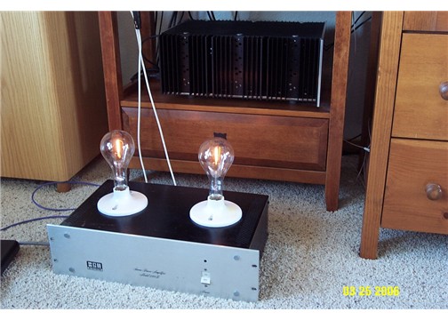

Anyone who has Zen Ver 4 boards can easily configure the boards for the Pass JFET amp with a few cut traces and jumpers. You would get a regulated supply and constant current source.
Thanks to Grey for the FET group buy I have one channel of a Zen "light" ver 8 with a regulated supply and single 300 watt light bulb biased for 1 amp burning in.
I had an old pro amp that has been waiting for such a project. The transformer is 325 VA and the heatsinks are only good for about 50 wattsper channel, hence the light bulbs.
The Zen ver 4 boards worked great, didn't even need to cut any traces, just some careful placement. In the future I can reuse them if I decide to add an Aleph CCS.
The source resistor on the FET is 1 ohm, 2 two ohm resistors in parallel. The 25K ohm pot. was adjusted for half the supply voltage at the output. The bias came out to .98 amps and 2 volts across drain to source of the fet.
I hope to listen to the one channel tonight after some brief tests.
BDP
Here is a picture of the finished Zen Ver 8. I did some measurements.
Frequency response was 80KHz with 600 ohm source.
10Khz square wave looked good with slight rounding of the edges.
My heatsinks could take a little more heat so I upped the regulated supply to 50 volts and adjusted for half the supply voltage at the output. The bias current ended up at 1.2 amps. Voltage across the FET was 2.7 volts.
I'm driving a mid tweeter in a Bi-amped pass Hi/Lo/ Moamps electronic crossover so I can't comment on the bass at this time. This amp is very smooth. Once you get to this level of equipment the difference in speakers becomes huge. The Audax PR170M0 mid becomes very detailed but never harsh. Listening to this amp will be fun.
In the back ground is my Aleph mono amp.

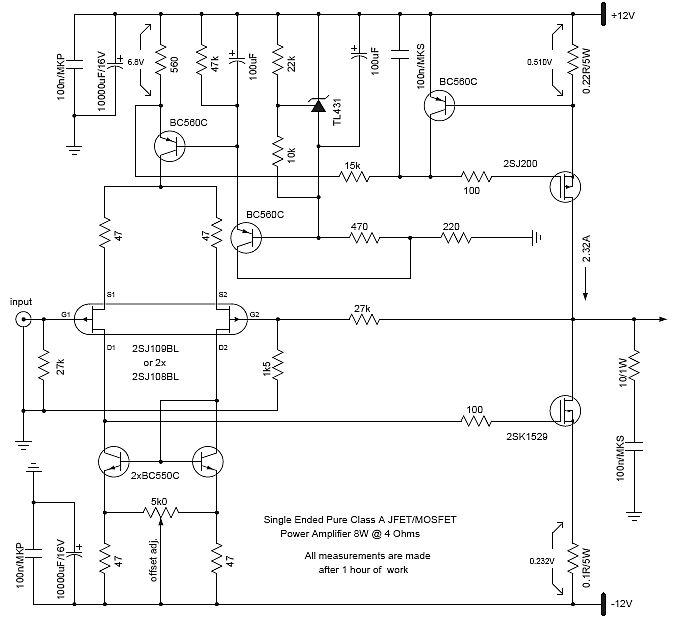

Junction FET
Can I use this device from Fairchild?
http://se.farnell.com/jsp/endecaSearch/partDetail.jsp?SKU=1094998&N=401
Re: Junction FET
Looking at the data sheet, this device has at least double the input capacitance of an irfp240, so your highs will be more rolled, but better bass due to the higher transconductance.
It would be similar to the Aleph 3 that uses two irp240 in parallel.
It would probably still sound nice for using one amp for a full range driver. If biamping then you might want to consider a lower capacitance for midrange/tweeter.
Bill
