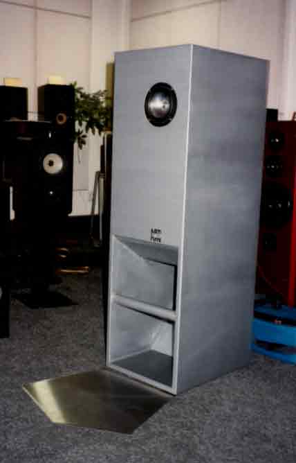

Hello,
think about my TUBA for me the best JX92s enclosure.
The j-low horn ist to short to much mouth, for the size less bass.

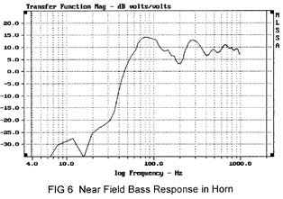

And did somebody bother to read Nelson's lengthy article about the design and consider its objectives?
The J-Lo measures decently and conforms to the design criteria clearly set out. It is not intended to extract the maximum possible extension from the driver, but to provide plenty of gain down to ~50Hz (-6db), to allow louder listening levels. As you can see from the attached frequency response taken from Nelson's article, they easily achieve this. In fact, they need a high pass filter on them (or additional damping) as they provide too much gain as-is. Digitalmind seems pleased with his variation, so if you'll forgive my mentioning it Horst, I can't quite see why you're once again rubbishing somebody else's speaker design and telling them to build your own. Especially when they're happy with what they have, and you don't quite seem to have understood the objectives of the design.

ach Scottmoose,
The TUBA goes down to 35 Hz and is only 30 % of the J-low Size.

Originally posted by hm The TUBA goes down to 35 Hz and is only 30 % of the J-low Size. [/i]
And your point is...? Nelson & Dana did not design the J-lo to go down to 35Hz. It's designed to provide a large amount of gain down to 50Hz - 60Hz. Which it does. Nor was it designed to be small. It provides full horn action down to 60Hz. Technically, it could do with being 1/2 wavelength, rather than 1/4 wave long for maximum efficiency, but it doesn't need the extra -it's already got more than it needs.

Nelson has measured and tested his J-lo design -I gave you one of the FR graphs from his large article. So your point is...? (and why specially for me BTW?)

So has Nelson -I thought you might have liked that. All in his lengthy article.

The J-lo is tested, as I've repeatedly pointed out, and the data & measurements you enjoy are provided in Nelson's lengthy article. You obviously haven't read it -here's a link: http://www.passdiy.com/pdf/j-low.pdf
