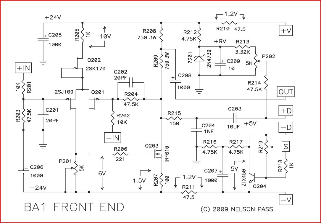

I think the outputstage is an F4, there seem to be SK170 and J74 on the right side and the source resistors seem to have 0,47 Ohm.
you dropped the correct parts for biasing, it is done by the F4 components....TL431
and the output semiconductors are marked with different colours so they could be complementary.. but mr push pull can look!
at the input of the outputstage is 47k and 1k at the j-fet input (last picture)
or are my eyes bad...?

well - without gong too much in possible issues ( except already mentioned that every discrete OP , which used BA FE is , needs elaborate PSU reg ) I can say just one thing - my F4 specimen , known as Papa's Koan , is blameless as much one power amp can be blameless ;
if paired with proper speakers - it will sound exactly as gain stage in front of it .
accent is on "if paired with proper speakers" .
no-one can expect miracles from 25W/8R amp .
