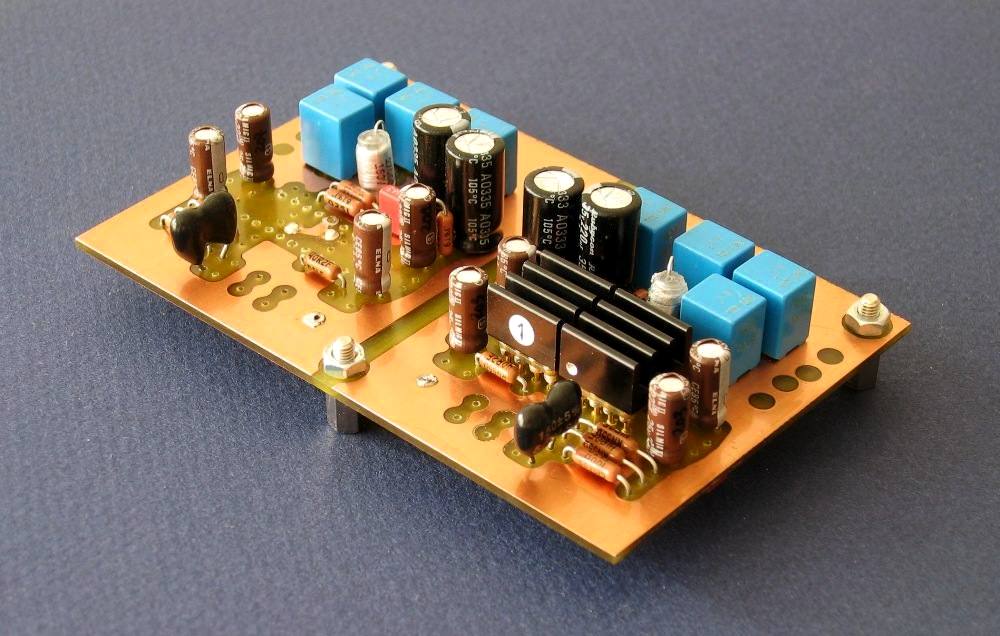

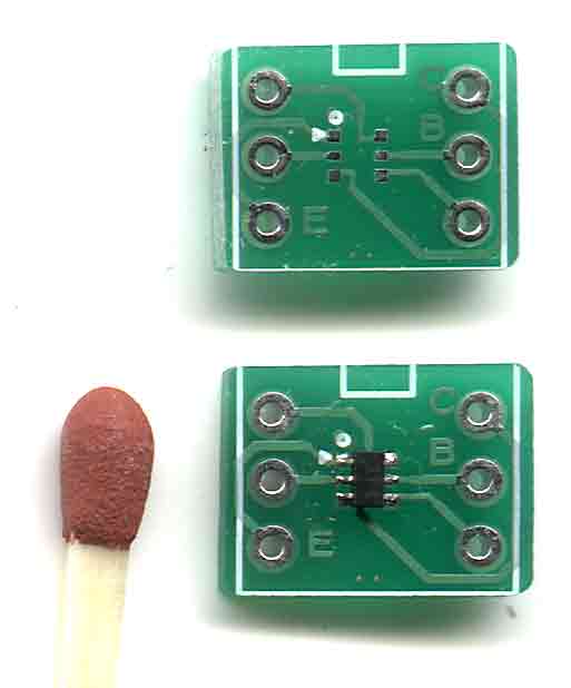

Hi EUVL. Those little op amps look awesome! If you need more pcb real estate you could try stacking two or more boards. You could also use different SOT23-6 transistors that have matched devices in a SOT23 body with 6 pins to save some space and get better thermal tracking.
BC847BS/557BS is quite nice and dirt cheap.

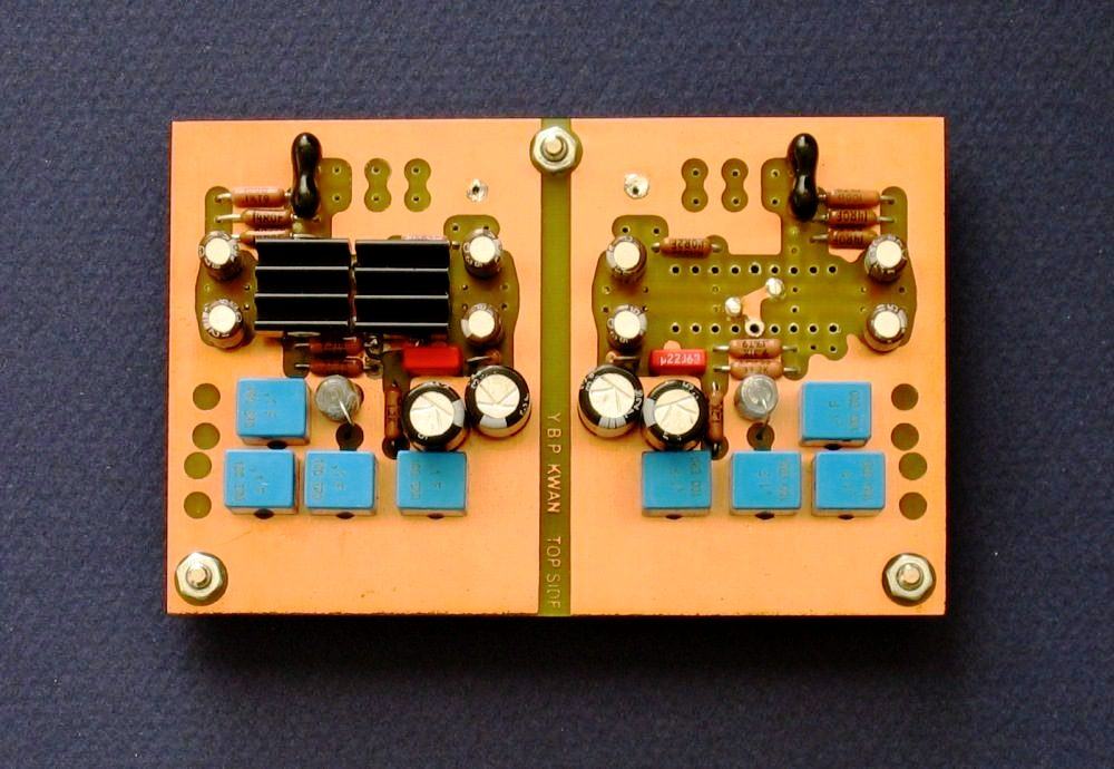

I know. I mentioned in my design description that I started off with SOT-23-6. But I want to use JFETs and there is no matched JFETs in SOT-23-6 that has > 25mS transcoductance, Idss around 10mA and low noise. And the current layout is actually better than SOT-23-6, believe me.
As for thermal tracking, if you use the right potting compound, it is not a real problem. As it is, the biggest thermal drift is because of the different Temp Coef between the BF86x's and the ZVP3306, and not the JFET themselves. All the high dissipation components are glued to the heatsink directly using Arctic Silver. And I was amazed how effective it was.
I am not using bipolar, as they require current mirrors, biasing diodes, etc. A current source is much easier to make from JFETs. Bipolar means more components, which in turn means more PCB real estate.
> Your competitors have huge designs compared to yours.
I know. I did an extensive survey. I thought about posting some of those pictures (like Forssell, API, Burson, Melcor, JE-990, .....), but then there are too many copyright issues. I think people who knows the topic, like yourself, knows what they are looking at.
In fact, if I were to make a couple of thousands of these, I have a even better means -- buy LSK389 bare dies from Linear Systems and probably Zetex and do direct chip on board with wire bonding. It will then be packaged like a normal DIP-8. It is handy to be working in semiconductors.
I want to see how you match them. :)
I am too old to solder anything much smaller than SOT-23 these days.
