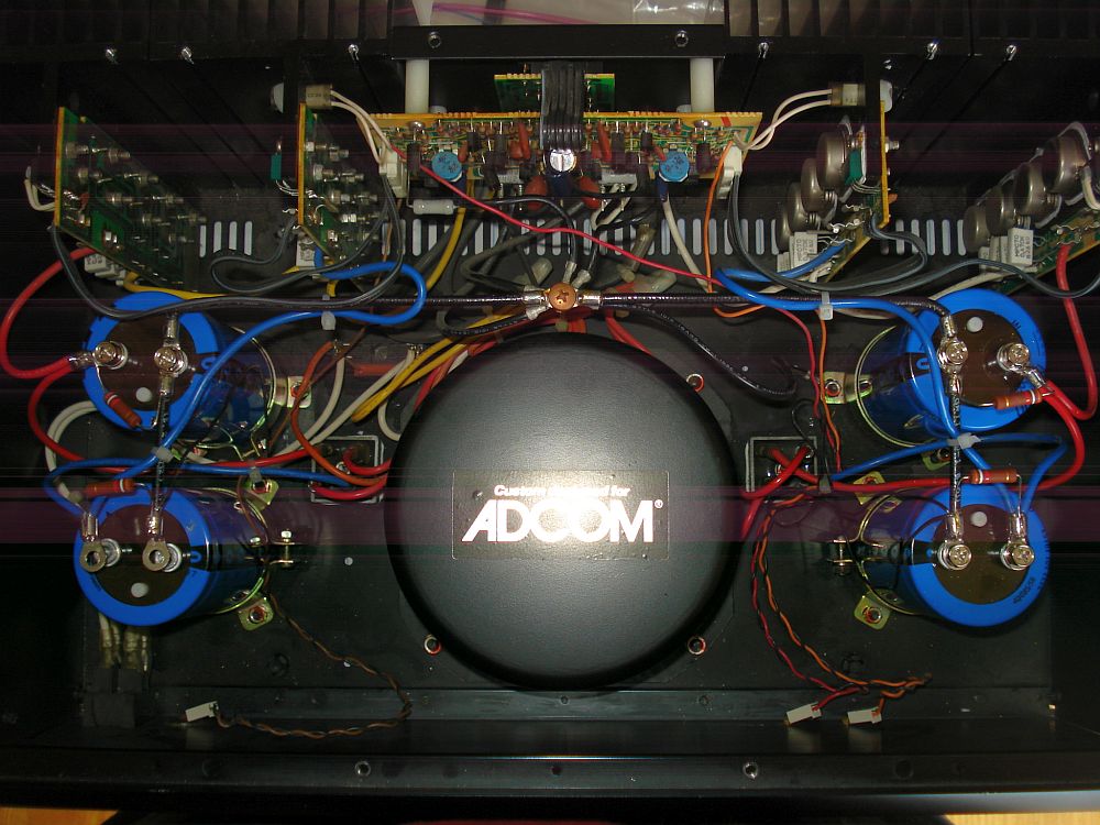

Dont know if this will be of any assistance but I just got a GFA-555 Friday so here are a few pictures of the interior as it came to me.....

Thank you for responding. That is a schematic for the 555II which was a later version and much different. I have a schematic but am not adept at reading it as I should be.
