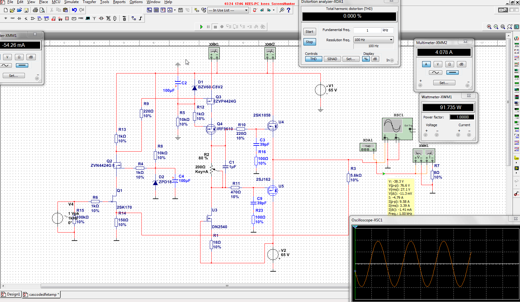

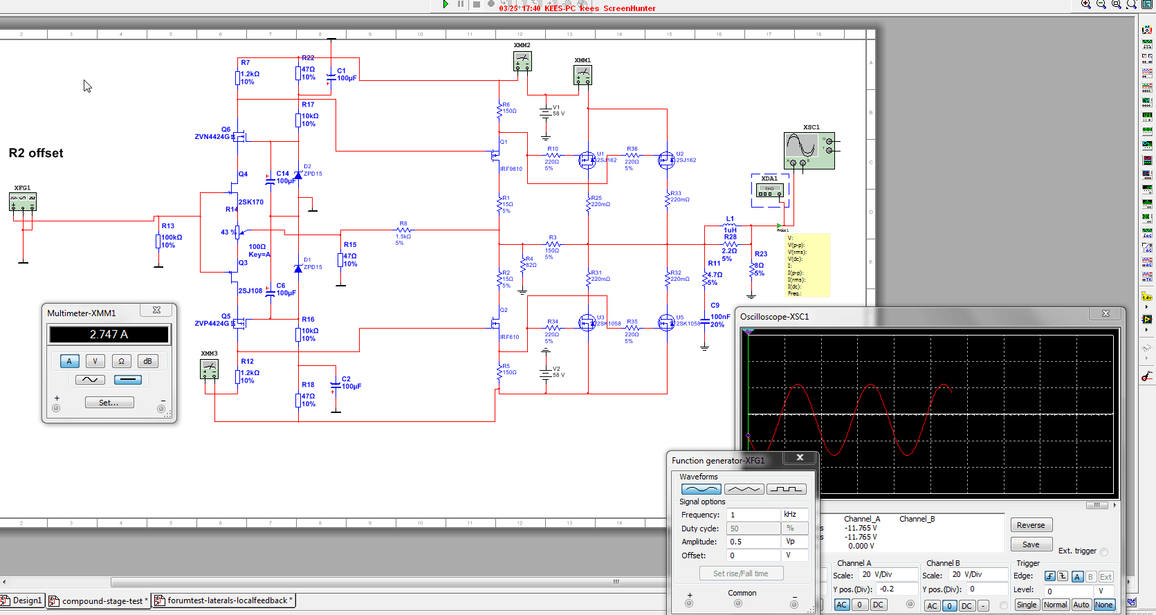

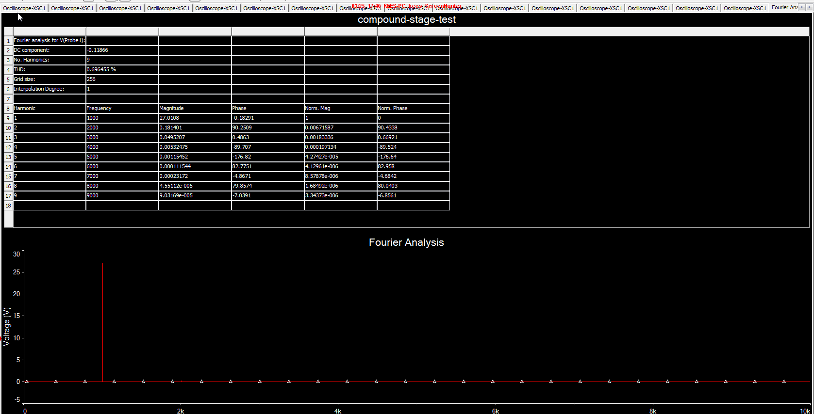

It is sunday and I had not much to do, so I simulated some things, I tought maybe this time a compound stage and a double feedback loop. yes stil it is symetrical but simulation says second harmonic is present witch make 0.18 % distortion, the others are 0.000 somewhere, see pictures, now we can talk about the netagives or positives of this kind of amp stage, I myself have never try it, but it can sound really nice and warm if I look at distortion and it is fast.

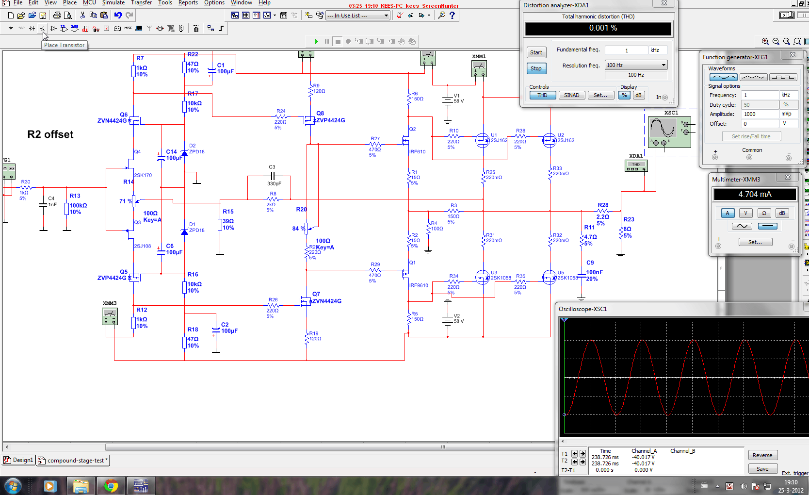

here it is complete with idle current adjustment. feedback can from output or driver, from driver then more second harmonics and more stable, it oscillates in multisim, cause are the jfets, bad models from them also..

some error R28 there has also by a coil parallel, otherwise 2.2 ohm in series with speaker, boooom.

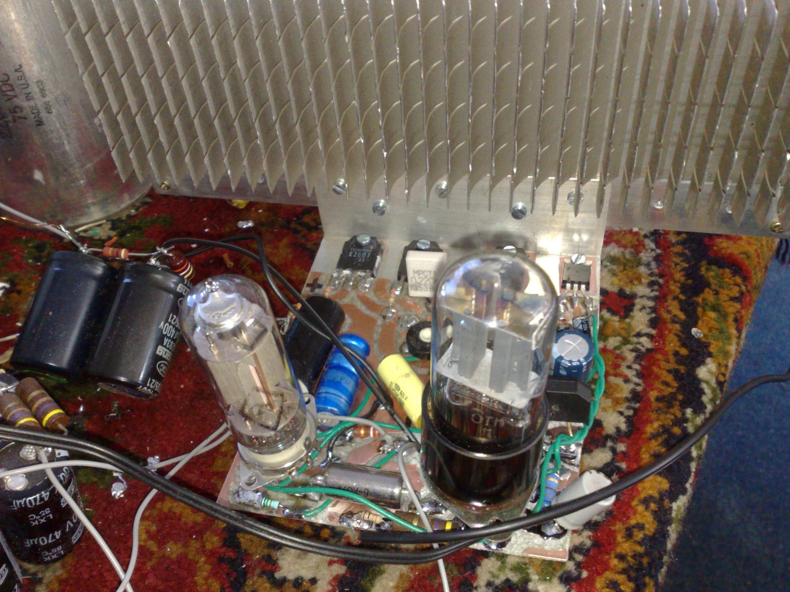

I do first the hybrides, the one now give problems, it blows the gate protection diodes if I forgot the power mosfet supply, then the diodes are in series with the speaker, and the 6C19 120 mA tube with his mosfet mu stage easely blow the diode, maybe a 1.3 watt version is better, or keep voltage on the powermosfets then the swing trough the speaker follow the driver sinus, and the diodes stays alive.
If I see it the right way I just explane, amps are sometimes strange things.
I find parts only I need to order minimal 70 euro, not a problem because I am quick there, amps cost mony, but you may also build it, it is DIY freedom.
