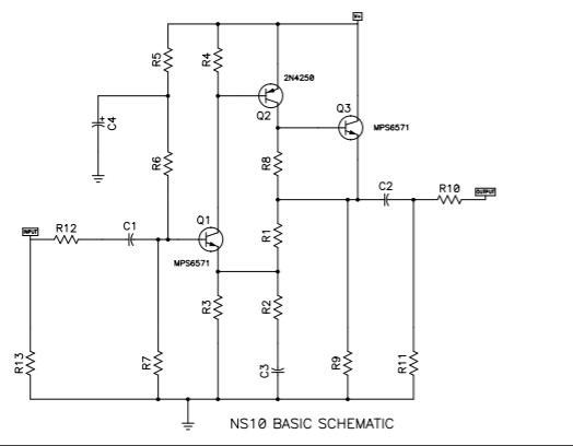

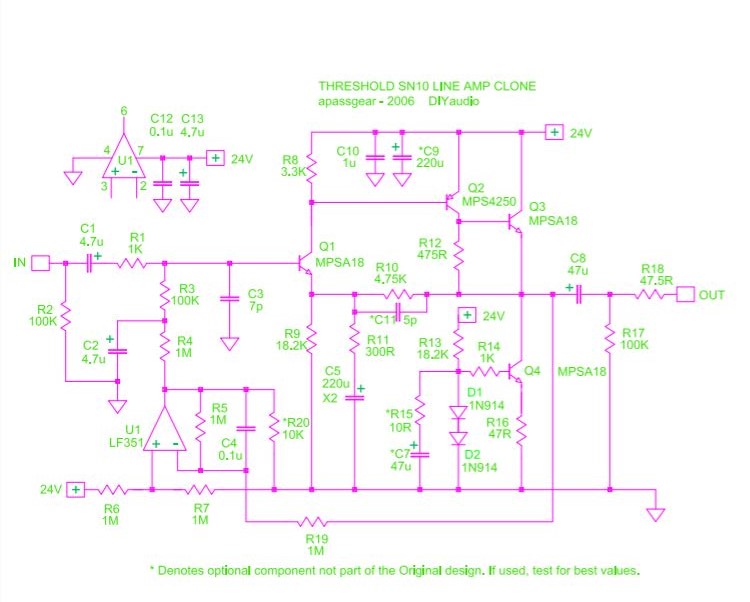

Sounds like you're describing the NS10. I recently built one and although it doesn't have much 'character', It just plain sounds great to me with awesome 'slam'. I've heard people describe the circuit as BRUTAL and honest. A keeper for me.
That's the Pass NS10 discussed in these threads?
http://www.diyaudio.com/forums/pass-labs/61459-ns-10-schematic.html
http://www.diyaudio.com/forums/pass-labs/26003-threshold-ns-10-m1-info-wanted.html

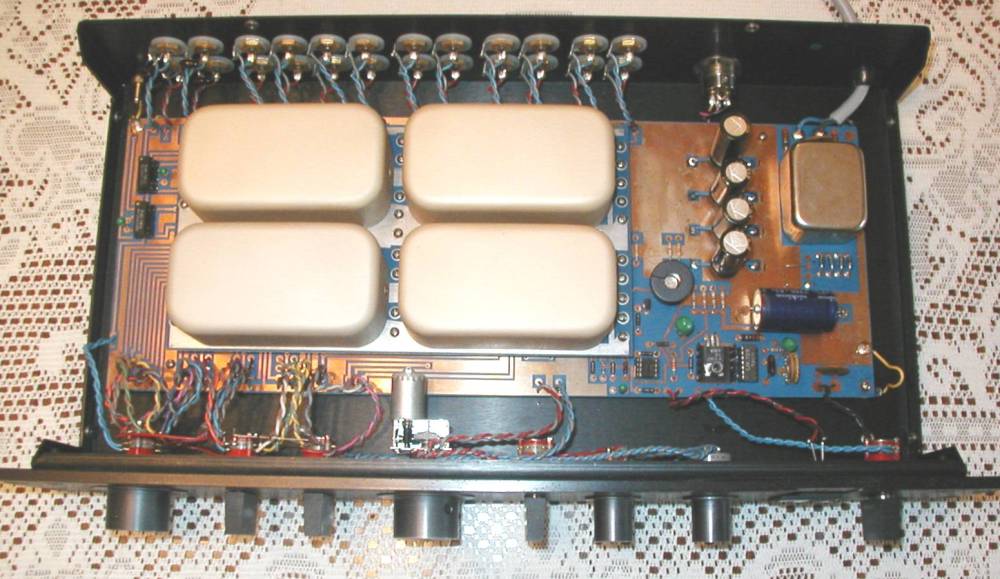

I'm just a beginner at all this, so I don't understand how the schematic and the picture of the NS10 innards quite match up.
What schematic did you use for your build? And which transistors - the ones on the Pass schematic aren't available from 'the usual suspects' like Mouser/Digikey.
