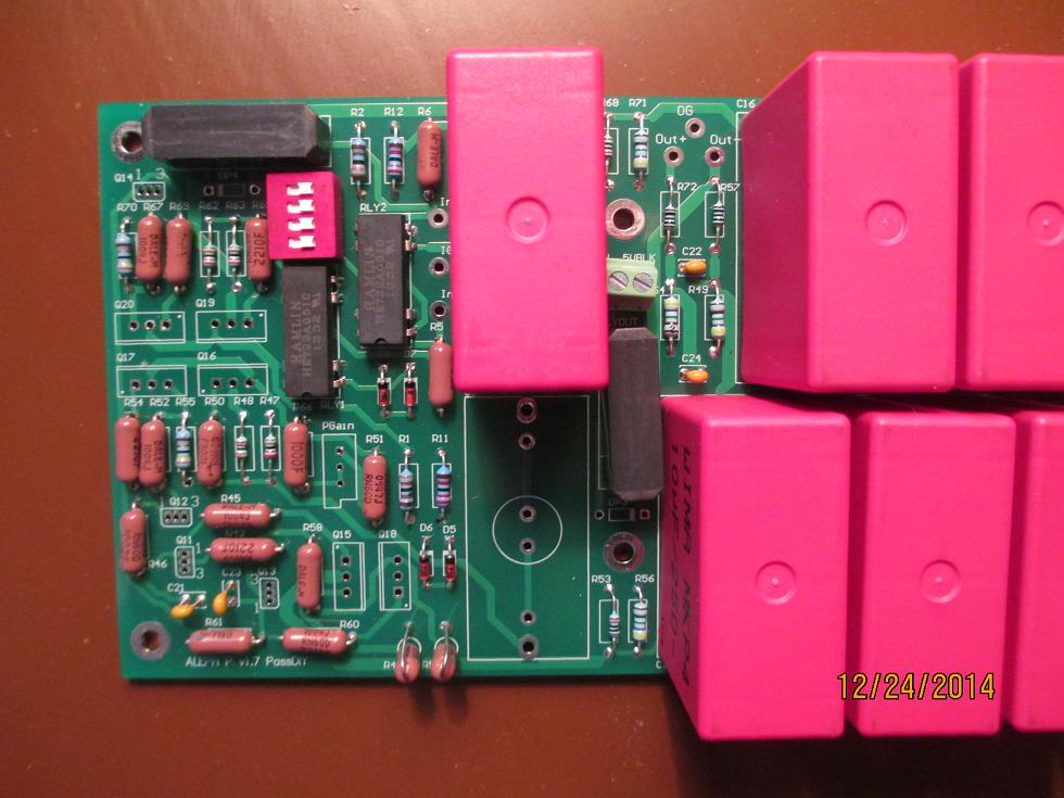

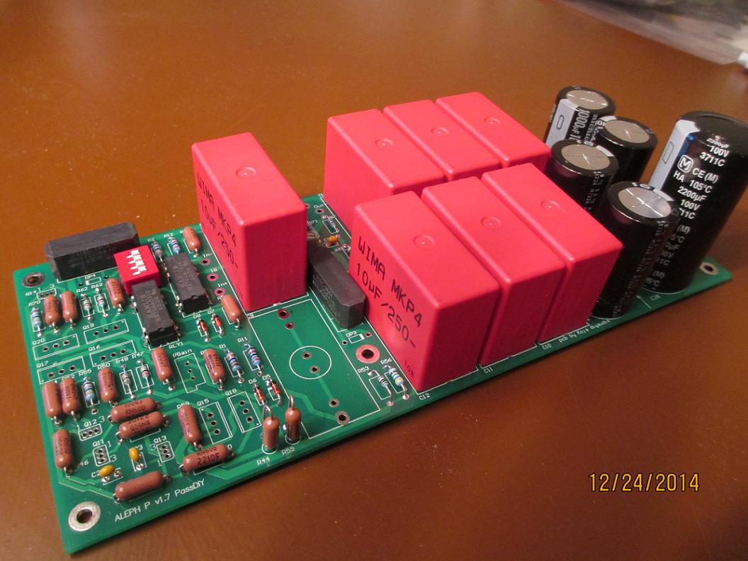

started stuffing the board (all transistors still missing but just to give you an idea). I also left one Wima cap out so you can see the other relay tucked in between (yours will be the shorter 4-pin version; I bought 5-pin ones as surplus stock, remember?).
I also realized the rectifier pins (i.e. orientation) are not labeled on the board (sorry). the one that connects to the large 2200uF cap is "+" and the the one on the other end next to the AC_in block is the grounded "-". the two in the middle are AC. if you use the same rectifier as me (Fairchild GBU4) the text will be facing in towards the board. I am still working on a little hsink for the rectifier (probably an overkill) so it is not mounted yet and thus there is no pic available at this time.

No official BOM, only pointers are available.
relays:
2X Hamlin HE722A0510 (these control the input attenuator switches)
any 4-pole DIP switch will do the job.
2X Coto Technology 9007-05-01 with the protection diode included (or 9007-05-00 without the built in diode which can be added under the board, instead of on the pcb where it may be too far). these relays are to ground the negative input and output respectively if either is used unbalanced.
again: you need an external 5V PS to drive the relays! (I will use the PS which at the same time drives 1kOhm RelVol Attenuator by dantimax.dk).
4-pin rectifier bridge (Fairchild GBU4G)
electrolitic caps in PS:
the first one: 2,200uF/100V cap instead (snap in P:10mm 25x50mm(DxH); (mine is Panasonic ECO-S2AA222CA); the rest are all P:10mm. 20x36(DxH) (I have Nichicons 1000uF/100V UVR2A102MRD6).
the resistors are assumed to fit the footprint: P:10.35mm; body:6.8(L) x 2.8mm(Diam)
only R44 and R59 (22.1Ohm) off the rail are stood up vertically, and R73 (3.3Ohm/2W) is on a bigger footprint P:20; body: 16.5(L) x 6.5(diam).
p.s. you can see in my pic that I have a lot of slightly oversized Dale RN60D resistors and I had to bend their leads under a bit but they could still fit, only the board does not look its best.
and again: for this board you will need a pencil soldering tip and make sure the solder flows through the hole and shows up on the top side, since the pads are really small (for maximizing the ground plane poured all around). I am not happy with the pads for the electrolitic caps; I used the standard footprint from Altium library and did not check them so it tourned out that my caps have thick leads and the holes and pads are both undersized. Sorry.
