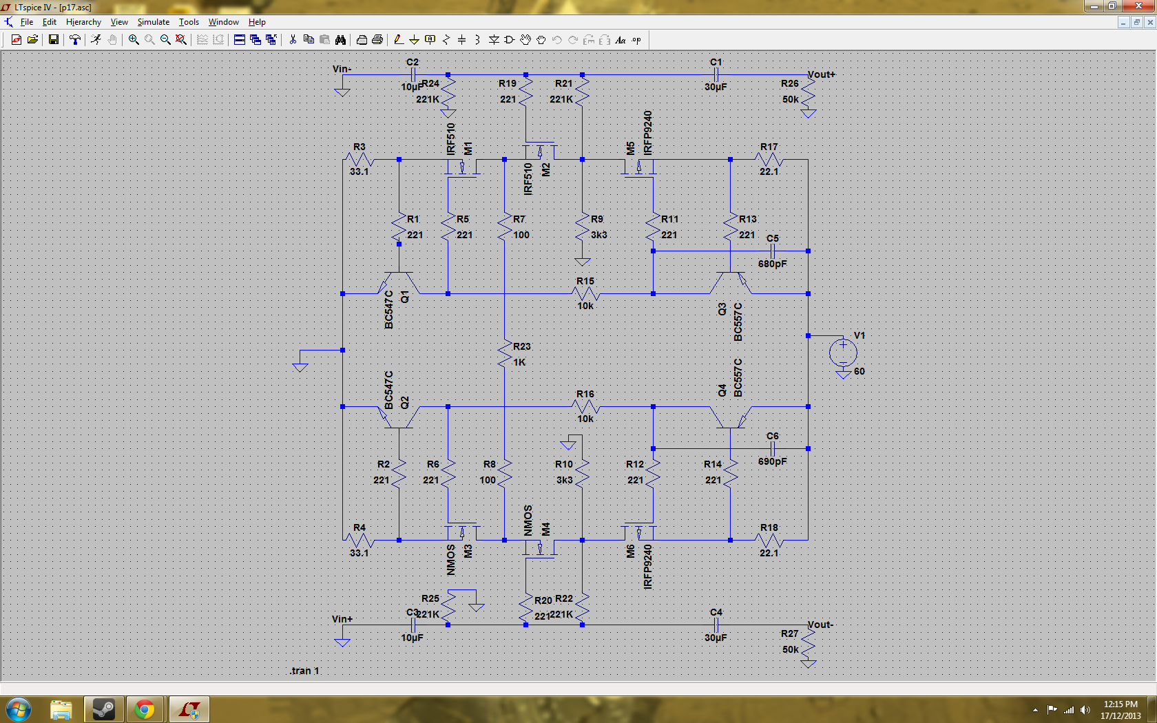

and if it would help I could sim the circuit and find the expected voltages at each node - would allow you to see where the fault lies.
very cool offer. might help allot.

simming
LTSpice
Sim attached - I've grounded the input, and left off a few bits at the input and output. You should be able to scan around the schematic to have a look at voltages. I did this pretty quickly, so I won't guarantee my work!
Does anyone mind sanity checking my transcription of the schematic? I used the attached to work from.
I gotta go to work as well, so I'll have a look again a bit later.
