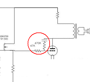

Anatoliy, you make a good point about applying the feedback to the same point as the input signal for low distortion. The cross coupled (Citation II) scheme with an extra driver stage does this. Also, the (non cross coupled) Wollcott like approach can be made to do this too, if the feedbacks AND input signals are connected to the driver stage cathodes.
But for pure convenience, the nicest feedback point is to the driver screen grids, same voltage level as the output plates and it provides additional attenuation of the feedbacks for free. I don't think I have seen this done, but it sure looks enticing.

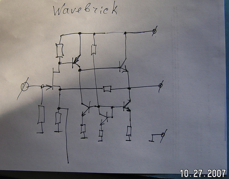

Don;
I saw such beasts designed to drive power transistors, but TL072s are freely available in my bin.
Also, a discrete transistor amps would work great here, like this one:
I myself made inverting power amps that had line input transformers (input impedance was 600 Ohm), and signals from transformers and GNFB were summed of the grid of the 1'st lamp. It sounded very nice! But I did not try to linearize output toobs and transformers by such a way...
Using screen grids you'll get back that well known "Ultra Linear" approach, or I misunderstood you?
"Using screen grids you'll get back that well known "Ultra Linear" approach, or I misunderstood you?"
Well, I meant using the screen grids on the (pentode) driver tubes for the return point of the output tube plate feedback resistors (with an additional screen to screen resistor across the diffl. pair to set feedback attenuation and maybe some DC screen bias resistor to ground too for lower DC screen volts). I guess one could call it an ultralinear feedback driver. (also, the feedbacks now have to be crossed from outputs to drivers due to the inversion between grid and plate in the drivers.)
Don
Don
If we use solid state buffering, maybe a MosFet source-follower ("superdrive") as used in the Tubelab.SE could be adopted.
Probably not relevant or needed for DHT triodes, and not practcial for the EL34 family due to high drive requirements, but might be useful for something like 807 as well as the EL84.
(resistor values are arbitrary values, might be OK for EL84)
