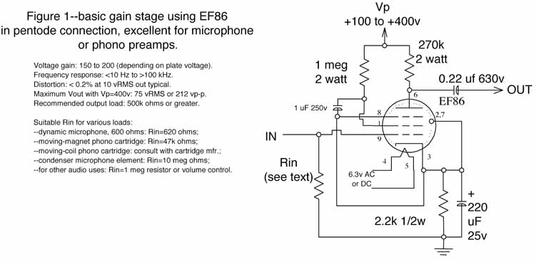

jeff mai said:is that the 6AU6 driver tube may not be the best option as driver here. An EF86 (or PF86 if you're a cheapskate like me) would have higher Rp and be happier running at 1.5ma of current.

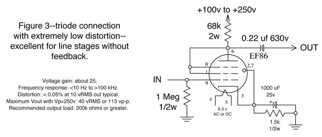

That is interesting. We have just "discovered" triode strapped EF86 as driver for SE EL84. I was chatting with Bill Perkins about this amp and he suggested battery biasing the suppressor grid (IIRC 3.5V negative wrt ground) instead of just strapping it to the cathode... then he suggest 6AU6 would be a good substitute for EF86 -- which tickled me pink, since i've got almost no EF86 and a box of 6AU6 including some real pretty TFKs....
dave
planet10 said:That is interesting. We have just "discovered" triode strapped EF86 as driver for SE EL84.
Eric Barbour's blurb on the connection. Impressive, was going to try it into an SE ultralinear EL84 or 6L6 when my transformers arrive.
Isn't the gain going to be a tad high?rdf said:Eric Barbour's blurb on the connection. Impressive, was going to try it into an SE ultralinear EL84 or 6L6 when my transformers arrive.
Brett said:Isn't the gain going to be a tad high?
Yes... had to put a voltage divider on the front end.
dave

Dave, I was commenting on rdf linked schem where the EF86 is on pentode and has an Av = 150 - 200, which really is a bit high for an UL connected EL84.planet10 said:Yes... had to put a voltage divider on the front end.

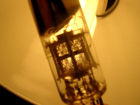

On the subject of driver valves, I was going to use a 6BX6 in this position ('cause they're cheap - were apparently used by the bucketload in old TVs), plus they look cool. ra is quite high as well, though they would appreciate a little more current (so the feedback resistor will probably have to be a little smaller).
The construction is pretty cool - there are two anodes surrounded by a mesh screen, and you can see the glowing cathode and the insides
The gain is lower than the pentode connection used in the Mullard 3-3 circuit I built for a first project. I also plan on using (cue ominous organ sounds) mild NFB in the circuit.
Edit: Arghhh, you are of course right Brett. I pulled the wrong cicuit from the pile. Sorry, here's the correct one.

audiousername said:On the subject of driver valves, I was going to use a 6BX6 in this position
They do look cool - they'd be good subs for the original 6AU6.
I'm going to build the circuit with 6AU6s first, but I couldn't help wondering whether the EF86 might have advantages in this topology after reading the Tubecad article.

Pentodes as Triodes
In reference to the EF86 as triode circuit.
It is an interesting concept using pentode as triodes. There are a number of tubes that are close to the plate impedance and Uhmos of a 6267/Ef86. 6SK7, 6SJ7, 5879, 6AU6, 6BA6 etc..
I have canvassed the books matching up pentodes and triodes from different time periods. Also 57, 58, 77 and 78 and others. I have found a number of pentodes like 6KT6 that is very like a 5879/EF86 pentode. This pentode is one-tenth the impedance of a EF86 and would give a lot lower output impedance in triode mode.
I have used five pin tubes like 37, 76, and 39/44 in Mike preamps and line stages and they are very warm and stable.
6AG7 is an older metal pentode that is a high-power amp but not a output that would work great in triode mode.
6EH and J 7 pentodes are built just like EF86 and are lower impedance and higher power. I have used 6EJ7 as Phono preamp 1st. stage and it sounds great..
You guys may have discovered a whole new area of triodes.

Thanks for the reply Gary.
Looking at the datasheet I have for the 6AU6, the Gm rises significantly as you reduce the screen voltage while plate current is held constant. For convenience of comparing I used 2ma of plate current. Gm rises from 1.8ma/V @ 150Vg2 to 2.5ma/V @ 50Vg2. Unfortunately the grid bias voltage drops from -3.5V to -0.7V at the same time, so you lose input headroom.
A cool tube that I used to drive a 300B once was a 6AC7. It might be a good tube to try here. Where the 6AU6 appears to have Gm of around 1.6ma/V @ 1.5ma with 100Vg2, the 6AC7 has Gm of 2.5ma/V at the same operating conditions and even biases in the same spot - around -2.4V The Rp is similar. The downside is that it's a metal tube. GT versions were made but are rare. I wonder if there was a miniature equivalent made?
The EF86 is harder to judge (I can't find a datasheet plotting grid bias volts vs Gm at different screen voltages) but from the slope of the grid bias vs plate current curves it looks like the Gm will be somewhat less than 1.5ma/V at the same 100V g2 and 1.5ma plate current. That makes it only marginally worse than the 6AU6 in this respect.
