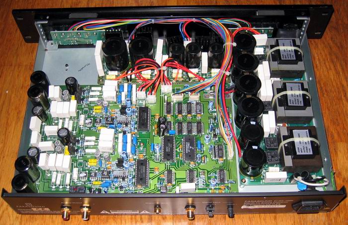

The latest version, with a slightly tweaked Rockna analog stage, CS8414 & DF1704:
Arne K
Joined 2002
Parasound
I cleaned the board for analog-stage parts, disabled pin9 from PCM63-K, added 120 ohm on output to gnd, added the Rockna board, http://www.rockna-line.com/diy/output/output.htm .
On this, I changed a couple of caps, to BG, and upgraded the DC-servo-op-amp.
I also tried the D1 I/V - output, but, since the dac gets a bit warm inside, the input-voltage drifted a lot, and I did not like this. (Do not know if it really means much...).
Anyway, the surprice is that the sonic signature on Rocna and D1 are very similar, or they are very transparent.
Arne K
