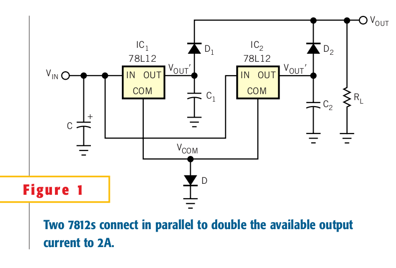

Old thread, but if someone is still interested, there is an easy way of paralleling 78xx's using 1n4004's to decouple from one another, and a common 1n4004 to cancel the diode-drop. It appeared in an old EDN issue:
High-current supply uses standard three-terminal regulator | EDN
