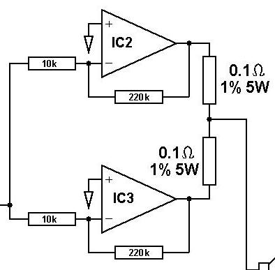

Will the circuit below work, and what is the a maximum number of chips that can be added (power suppy allowing)?
It should be able to drive 4ohm speakers without problems, right?

Paralleling chips doesn't really increase power. However, when chips are paralleled, they'll share the load and you'll be able to drive more easily low impedance speakers.
By example, when 2 chips are paralleled to drive 4 ohms speakers, each of them will "think" that an 8 ohms speaker is connected.
If you want more power, try the Bridged + Paralleled schematic.
Hope this helps !
I can't guarantee you that you'll get 100 Watts (depending of your IC) but I'm certain that you'll have no problems driving 4 ohms load.
By the way, the schematic you posted is very similar to the one provided by National Semiconductors in their application note :
http://www.national.com/an/AN/AN-1192.pdf
Take a look at the schematic "PA-100" (Parallel, 100Watts)
If I'm correct, the schematic you posted is based on the Bridged + Parallel configuration found on this forum right ?
In the application Note, you'll find several combinations such as :
BR-100 (Bridged 100W)
PA-100 (Paralleled 100W)
BPA-200 (Bridge + Parallel 200W)
You have the choice !
