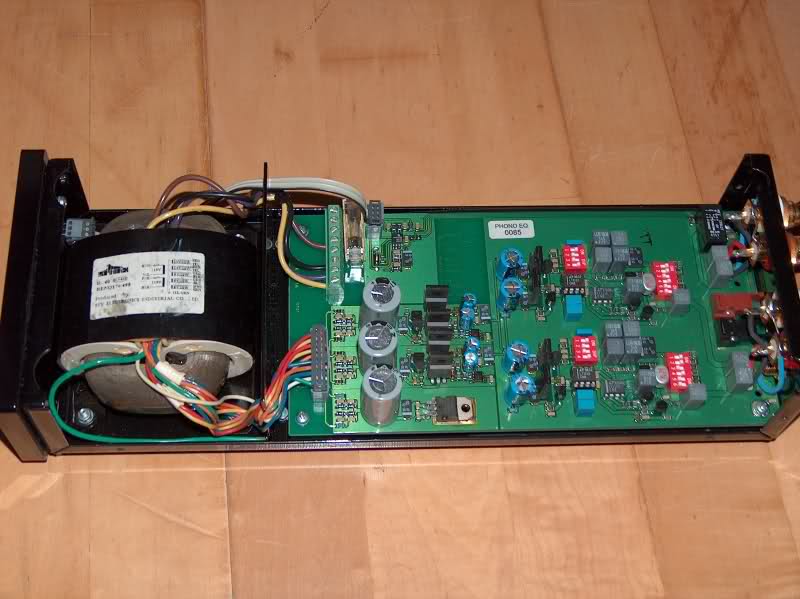

Ah, but the Looney finger was not pointing at you, but here : http://www.diyaudio.com/forums/group-buys/222164-paradise-phono-preregulator-6.html#post3436698
(fussy ones should know there's an R-core available that fits on the P-board, plus the striptease & knob twisting part)
Folding 2 feet on a piece of sheet metal is less "extremely extra" than using three cases, imo.
(for which there is enough space on the board. Plus at the sides, or directly at the standoff stud holes next to the Talema coils, for mounting a fold-out foot)
Goes both for block transformers, and 'others'.
So you are saying that the R-core you posted would fit these boards, at least have same pinout - but is a bit wider/longer?
If so this becomes quite interesting...
Also, why would it be looney wanting r-cores? they are better, and price difference is not THAT big?

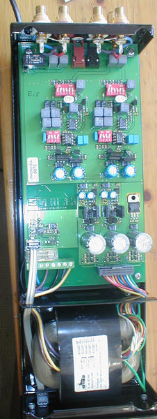

What phono stage
http://www.sphinxlab.com/producten/pdf/Phono_Eq_English.PDF
(2SK240 input, LT1115, LT1113 dual opamp, 1/2 for DC-servo, end '90s)
fit these boards
I posted that a 14VA R-core can fit on the board (weighs 3oz/85gr more than the flatblock)
Didn't say it has the same pinout, but the R-core plastic mounting plate is easy to adjust.
Better ? If you buy a Kitamura original, sure.
But that fun does about €100 for an R-50, 4 times the meal ticket of a Shilchar.
(~ €75 if you buy direct from Kitamura's sale company in Japan, €20 each discount if you order 10, plus addition of the extra travel expense to Europe)
What goes for toroids, is also valid for R-cores.
On top of that, to get the most out of an R-core, requires that the windings of left and right bobbin are perfectly matched.
If you don't, the FL (FLachtransformator) blocks are a better choice.
They're split-bobbin manufacture (Zweikammer) and have been for as long as I can remember, with exception of Schaffer maybe.
There's hardly a stray field from a fully resin encapsulated 14VA, add a steel sheet shower curtain and there's nothing to worry about.
Plus you can easily return it for a replacement if it's faulty.
